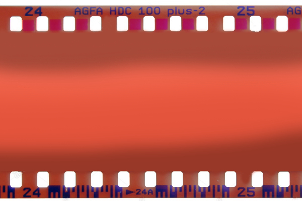

ECN2 processed at a local lab - they called and told me the film looks heat damaged/ went through x rays. I'm skeptical as the film have been kept in the fridge since purchasing.
PS. the negatives have a really red base and seem to have positive image on them already (Highlight light and shadow dark)
The film is respooled 120 250D from Photodom Lab, did the Lab messed up the processing? or is it the problem of the film?

Are the gaps between the frames the same red/magenta color? The leaders as well? Are you confident that your camera has no light leaks and the shutter is working properly?

If I understand it correctly, the film is showing the red/magenta colour right to the edges of the film itself, beyond the normal "frame". It's therefore not a camera/shutter issue, and does not look like fogging to me.

I'm not buying that. Either would cause fog, generally only quite mild at that. It wouldn't create a reversal effect as shown here.
Did they run this film through E6 by mistake?
It shouldn't. Reversing will make the areas between frames in DMAX.

It's Vision3; this product line was introduced in 2007. It cannot possibly be old enough to produce very severe problems - apart from the fact that age alone won't do anything like this in the first place.

There's some kind of odd solarization going on which I'd expect to see if the chemistry is totally out of whack (e.g. a massive failure related to the bleach). Given that there's still a clear image exposure visible. This means that during development, no dramatic fogging to light could have taken place as this would have obliterated the image - and it would also simply result in very dense, more or less monochromatic negatives. Plus, fogging to light virtually always involves unevenness in the form of gradients, shadows, projected sprocket holes etc.
It shouldn't. Reversing will make the distances between frames in DMAX.
You're correct; my E6 hypothesis also doesn't add up; you'd get fairly normal looking slides that way.
I'd like to see some more photos of the film as seen by the naked eye, especially the emulsion side, and also with light shining at an angle across the emulsion layer.

If I remember correctly from my minilab days, heat damage to negative is usually seen radiating from the film edges and displayed magenta in the print. This would mean the negative displayed a greenish cast from the edges and not uniform across the negative.
From what I have seen in the OP images, it appears to be a processing error.
This is what the negative might look like (simulation)

difficult to tell for sure, but my guess would also be processing error.
looks like some strange solarisation, so could be they had light coming in in the middle of the process or some really wonky chemicals.
it's definitely not coming from hot storage, even if you cooked it, it would not look that way.
my experience was that most labs will mess up at some point, but blaming the photographer either means they are clueless that they had a problem in their processing or don't want to admit their error, both of which for me is a no go.

I'm confused. How do we get from "respooled 120" to sprocket holes? Who did the respooling, Photodom, or...?
Is this 135 film shot in a 35mm film camera?
This is 65mm film that is perforated. It was cut to 61mm and rewound to 120. Recycled reels and rewinding paper were probably used.

Hi Koraks,
Here are the non scanned version of the negs. It's pretty dense - the subjects are pretty much undistinguishable

Were you able to recover the negatives at all? due to the reversal effect on the negatives, I was able to somewhat get some images back in lightroom:

That's what I think as well. I'm betting it was a lab error and for whatever reason, they're not taking responsibility, Switch labs ASAP.
However, you could easily verify whether the film is compromised or not by exposing another roll and send it to a different lab for comparison. If it comes back looking the same, then the film was compromised at some stage before it was processed.

Have you had successful rolls before that one? Or is this the first one from the batch? To rule out that there is an issue with the film itself, given that this is cut and respooled from 65mm stock.

It looks like a very massive dichroic fog with silver casts...
Yes, I see what seems like (lots of) retained silver.
Looks like a major chemical malfunction.
You could try and re-bleach & re-fix them, which may make a small difference, but I'd consider these negatives FUBAR.
Looks like it may have been respooled under a red safe light?
That thought crossed my mind as well. But you generally end up with (unsurprisingly) negatives that invert to very red positives.
IIRC retained silver in C41 negatives can be viewed from the emulsion side and if tilted towards the light, the negative can appear to look like a faint positive (a bit like a Daguerreotype ! ! !).
Yes, that can certainly happen; I've seen it from time to time on color negative. It's in general the case that very thin silver images show up as positive due to how the light reflects on the silver. This only happens with very thin images, and since color negative is a relatively thin image (especially if it's partially fixed), it's very plausible indeed. I think I see precisely this in the bit I circled.

So this is 65mm re-spooled onto 120 backing paper? Is this common? I recall Mercury, IIRC ?, did something like this. I would question the original supplier and the lab.

Just out of curiosity, I looked up some Google reviews of the Photodom lab. Apparently, you're not the only one with these issues. Some of the things I read are pretty... stressful.
I wouldn't blame the film rewinding, but I wouldn't have my film processed (and scanned) there. The pricing for C-41 vs. ECN-2 also struck me - maybe a few red flags.
