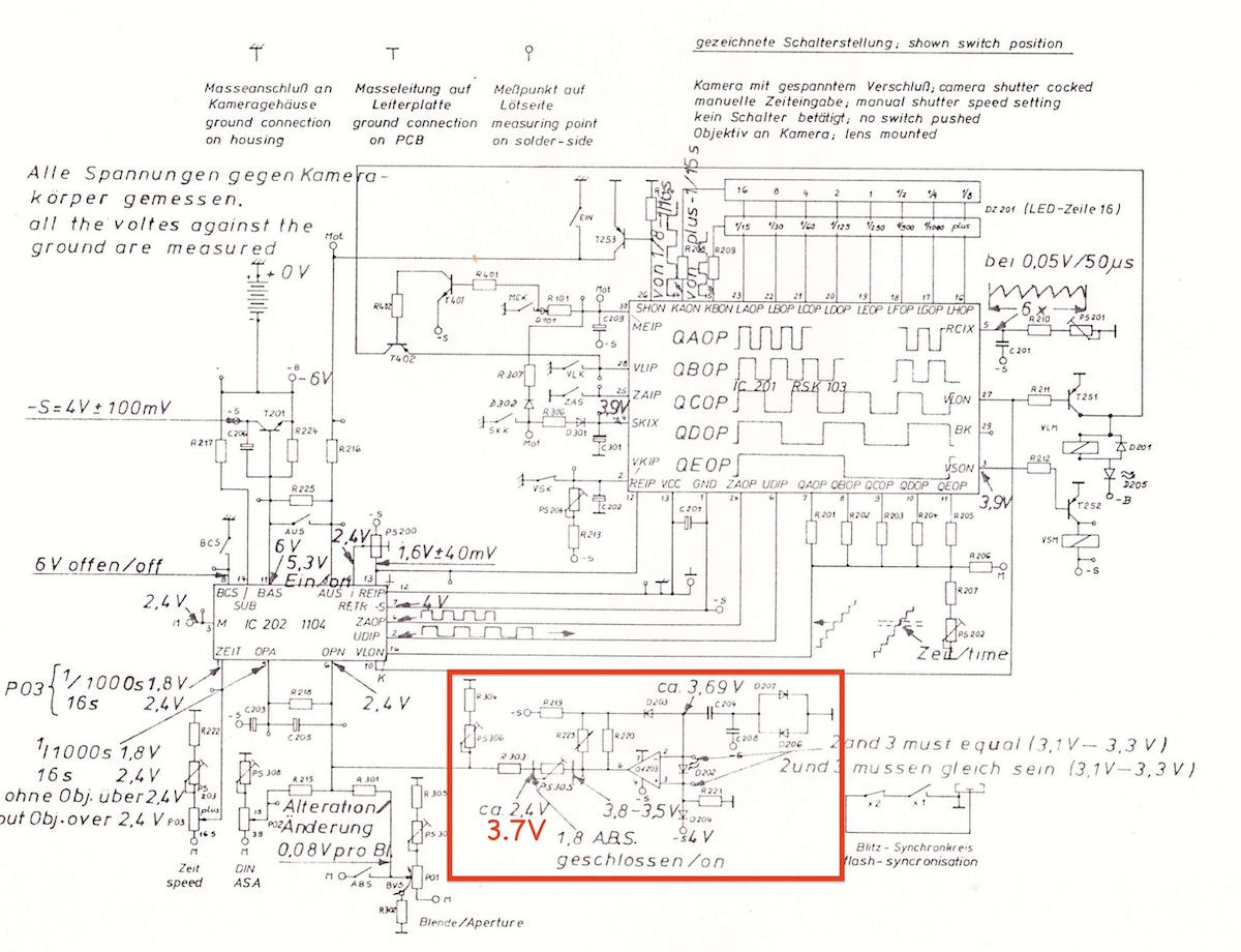

A while back I got some NOS circuit boards to repair some Rollei SL35E cameras. However, the 'new' circuit boards showed some of the same failures in the metering circuity as the cameras.
To troubleshoot the boards, the underside would need to be visible, yet, they would need to be hooked up to all the potentiometers and switches in the camera body.
I was able to repair the mechanical shutter on all the cameras, however. So, they could be used with an external meter.

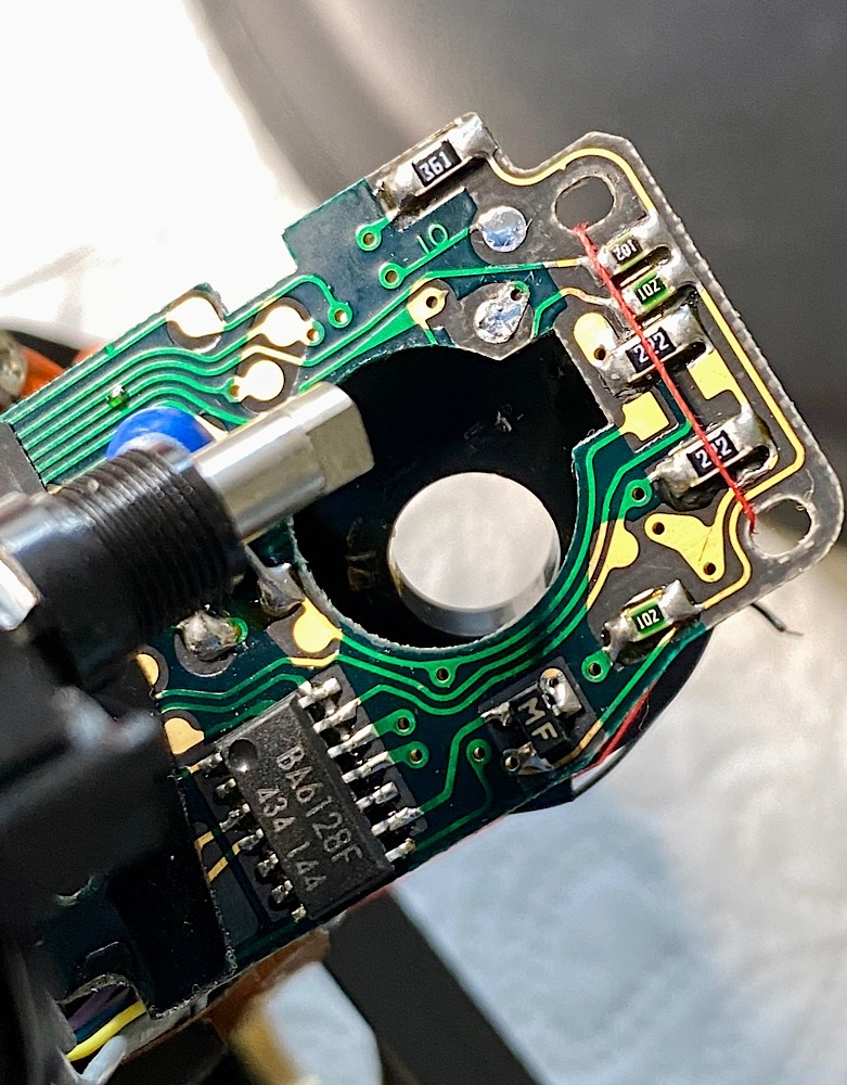

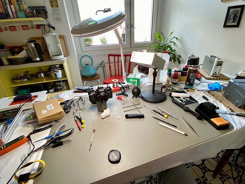

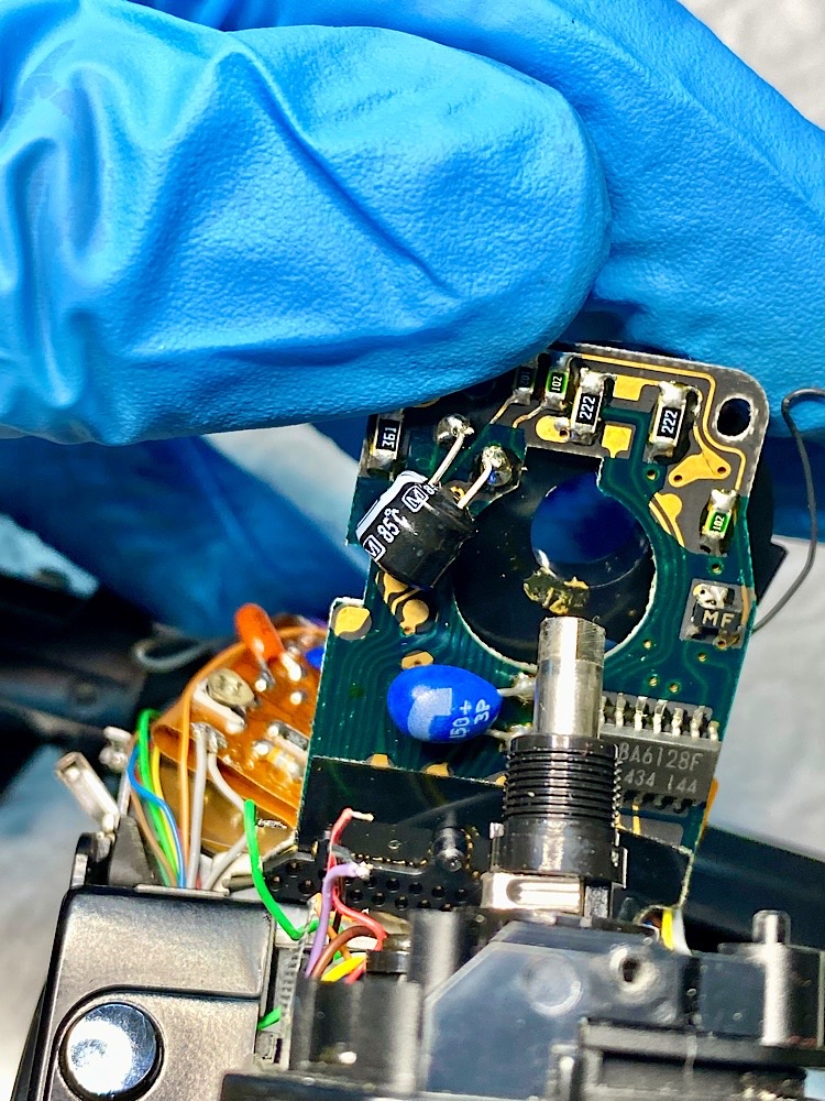

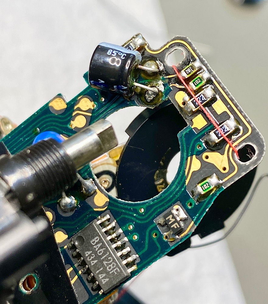

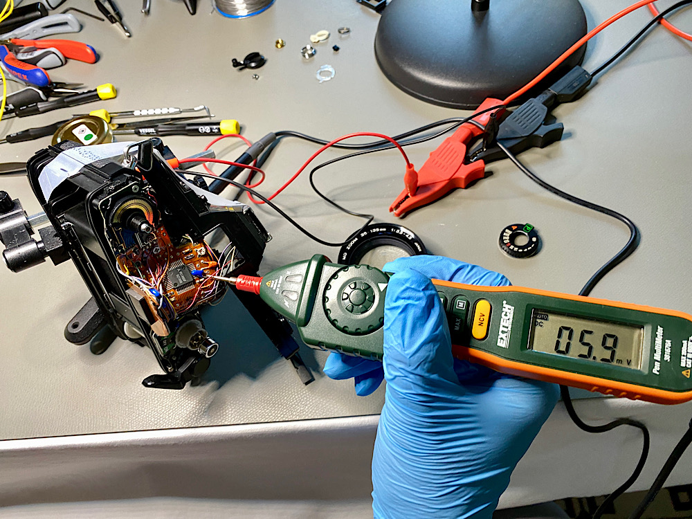

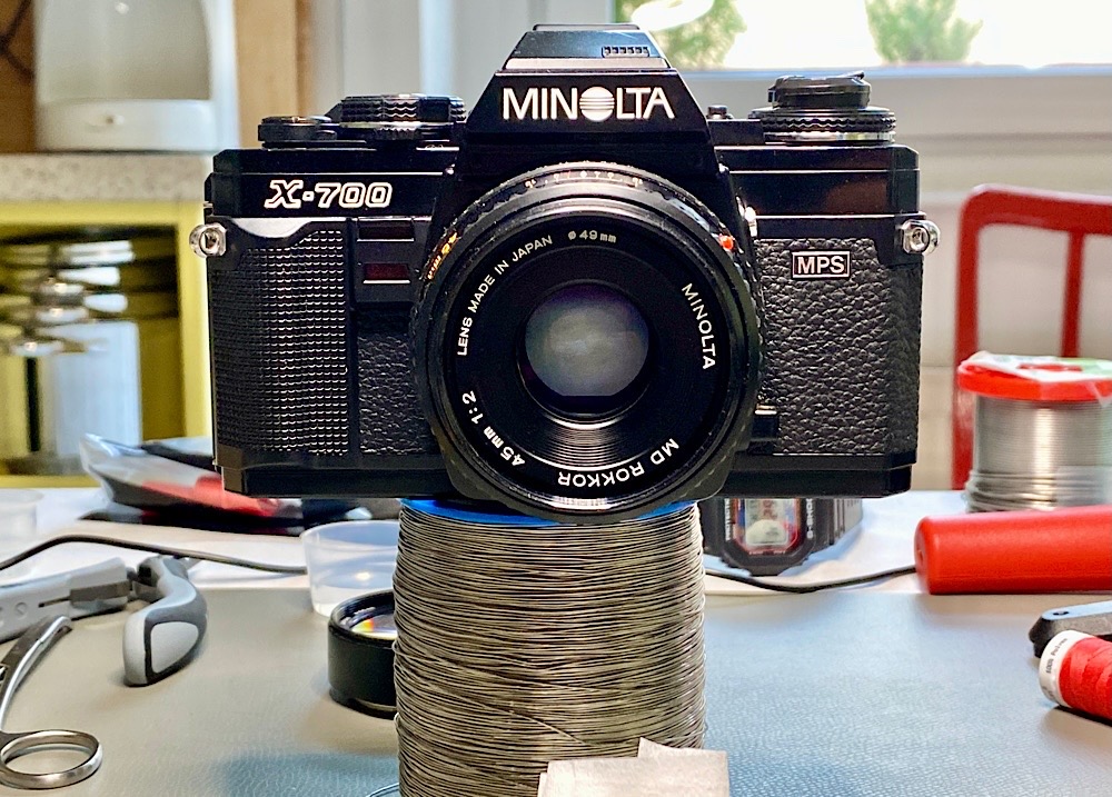

For my part, I was lucky today and was able to resurrect a mint Minolta X-700.

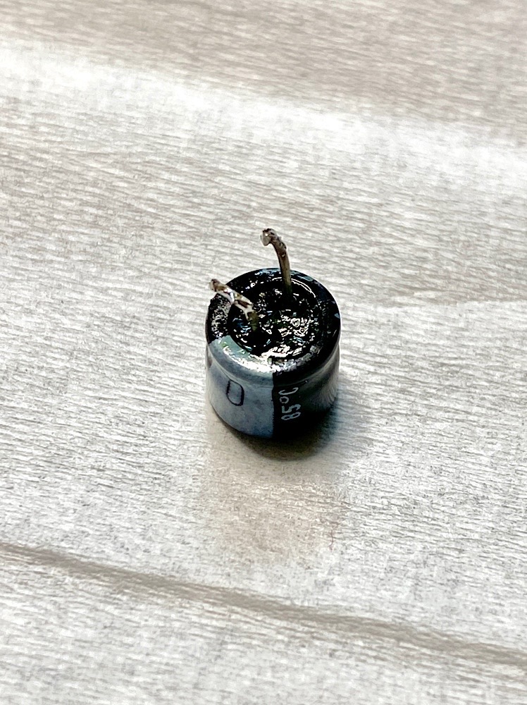

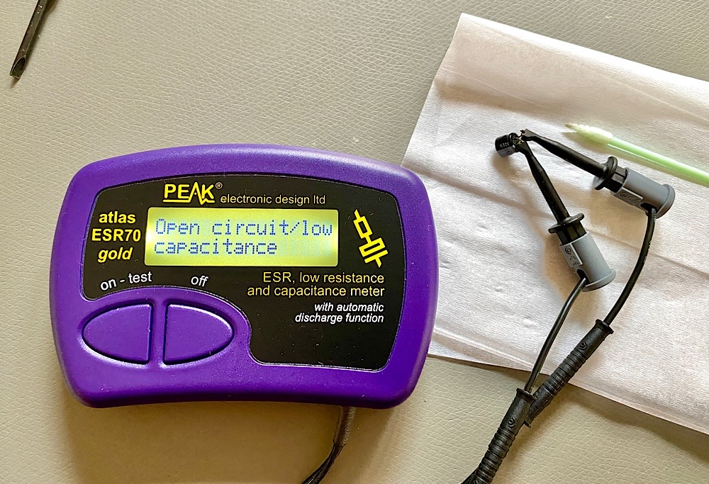

Capacitor C9 (electrolytic capacitor) in the top deck was leaking and was losing electrolyte, being still liquid but had not caused corrosion on the board yet.
As a precaution, I also replaced the second electrolytic capacitor (C10 in the bottom of the camera), whose values were still ok, but had already exceeded its age limit.
The symptoms were the familiar ones: LEDs in the viewfinder went out as soon as the shutter button was pressed, and the shutter did not fire. But that can also have other causes and then it will be a long day 😉
The key for me to higher repair success would be to replace the ICs if necessary. I practice this on abandoned X-700.
