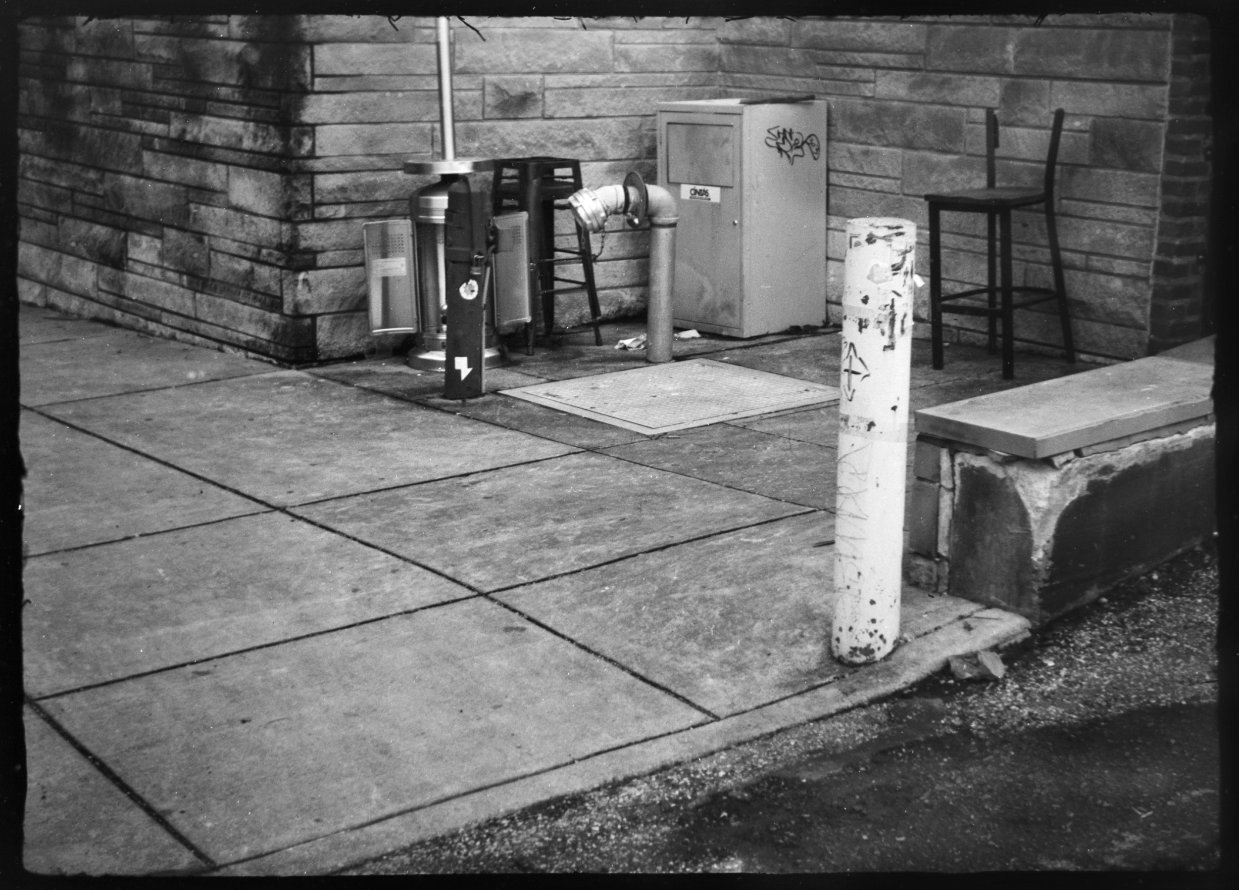

CN film typically has lots of latitude and designing for overexposure is a much better option than vica versa. Underexposure is probably the #1 scourge when it comes to most people's 'wut happened to my photos?' inquiries. Rating Metropolis @ 400 is... optimistic IMO.
For the slightly more thoughtful photographer, there's some fungibility for exposure compensation in the ISO setting. If you're a real stickler for exposure then an ND filter might be in order when using faster films.
Perhaps more interesting is that any baked-in overexposure could be leveraged to expose slower films (CMS 20II, HR-21, ImageLink) IFF the camera will accept reloaded 110 or retail microfilm stocks become available in 110.
Chiyoda Minolta 16, 1/25s f/4
Fuji HR-21 @ 12, D-23 1+3 16'
D850 digization, El-Nikkor 40mm on bellows
