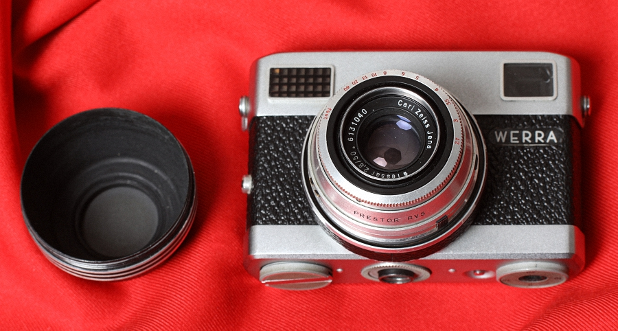

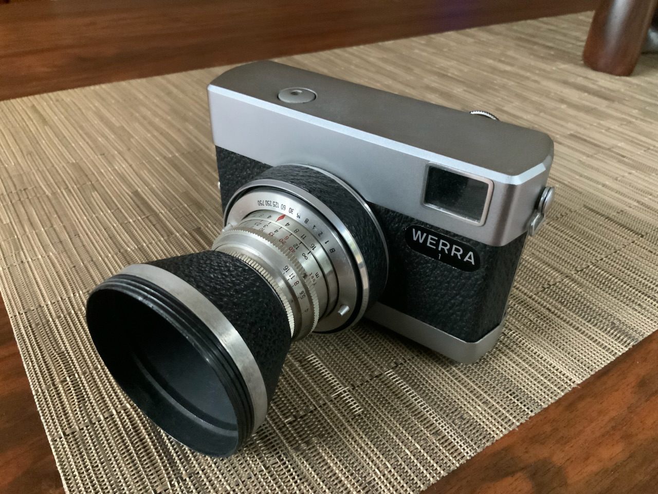

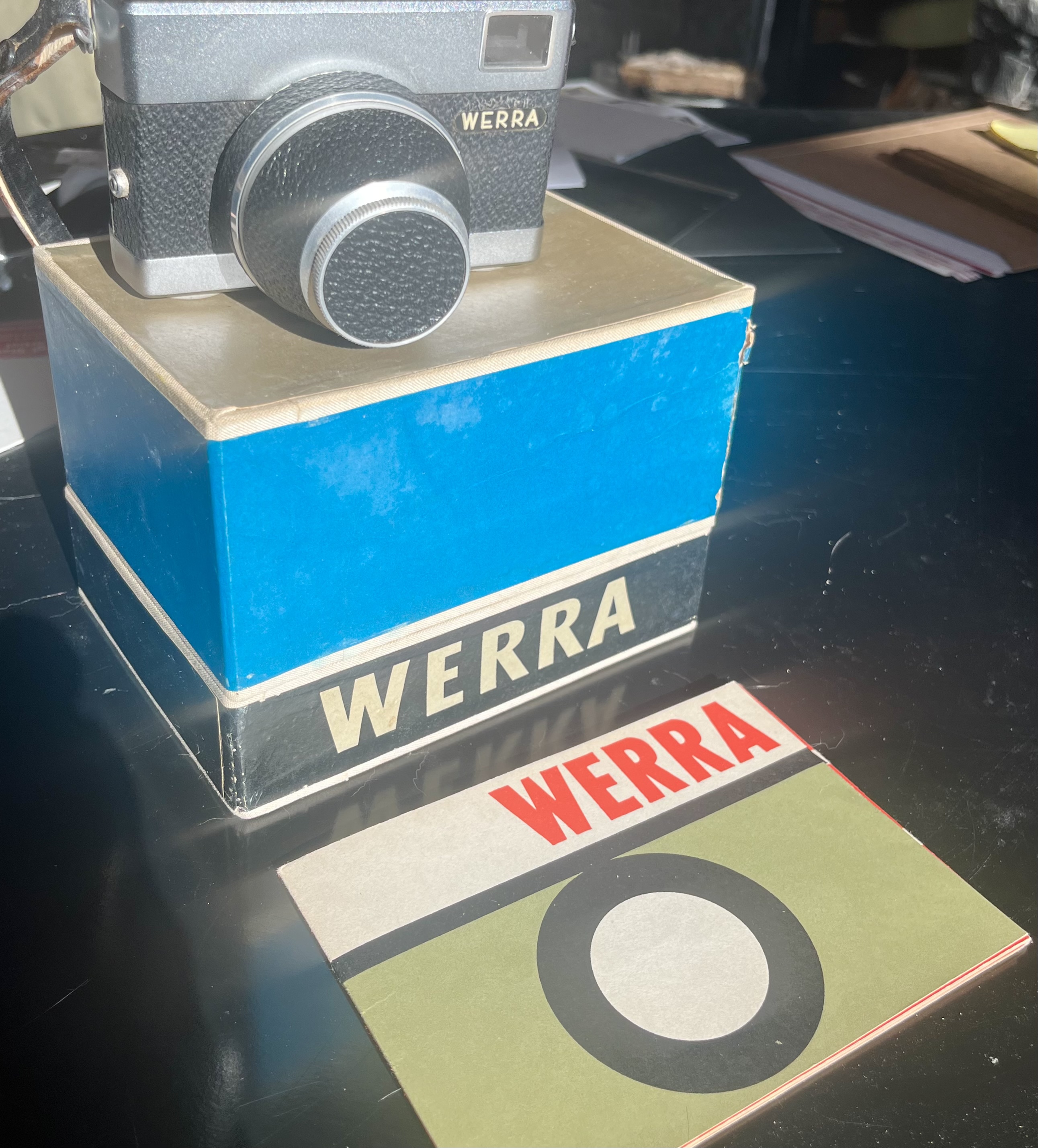

I have a small camera collection and just pulled a Werra 1 of the shelf to find out more about it. Here is a decent page on the camera line. https://cjo.info/classic-cameras/carl-zeiss-jena-werra-series/ after reading I wish I had a version 3 or model 5 with working meter. Here is mine which seems to be working so I’ll try shooting a roll of film.
Ian Grant
Aug 2, 2004
23,231
West Midland
I bought one a couple of years ago, they are mazing cameras. Mine has a meter, but is not like any in the manuals etc, seems to be an extinction meter.
I have a 3 Focal Press Camera books from the late 1950s early 60s. There's a good 3 or 4 pages on the Werra cameras. The books cover most of the better 35mm to 120 cameras then available, essentially they précis data from the small Focal Press camera guides which were very good. I'll scan one of the books tomorrow, just the Werra pages. I like to have the data for my own cameras, I'm surprised I haven't scanned them already,
It's good you have the hood and lens cap, they are often missing.
Ian

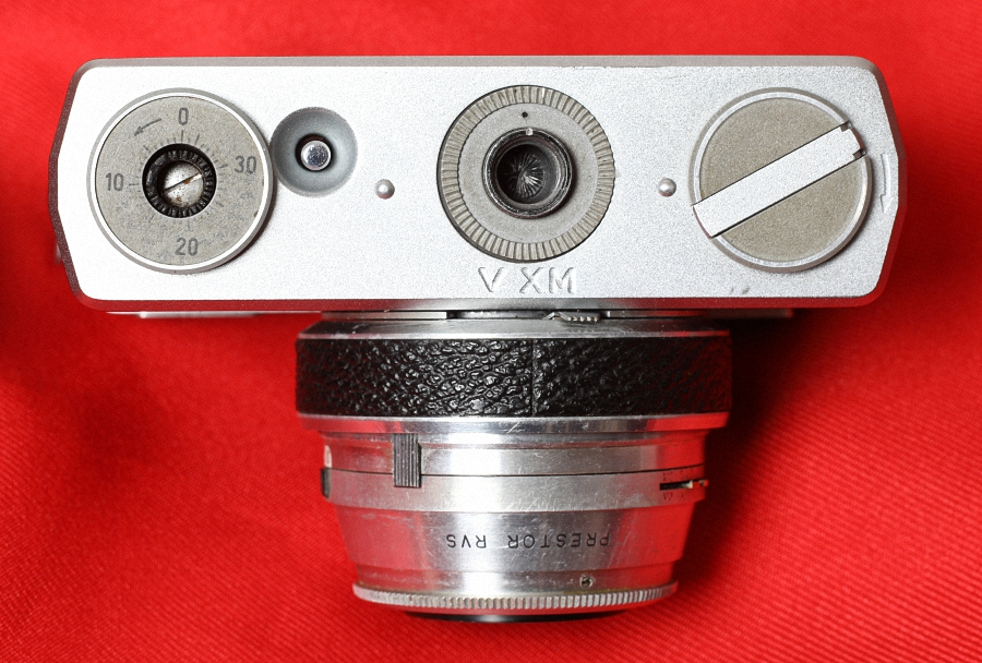

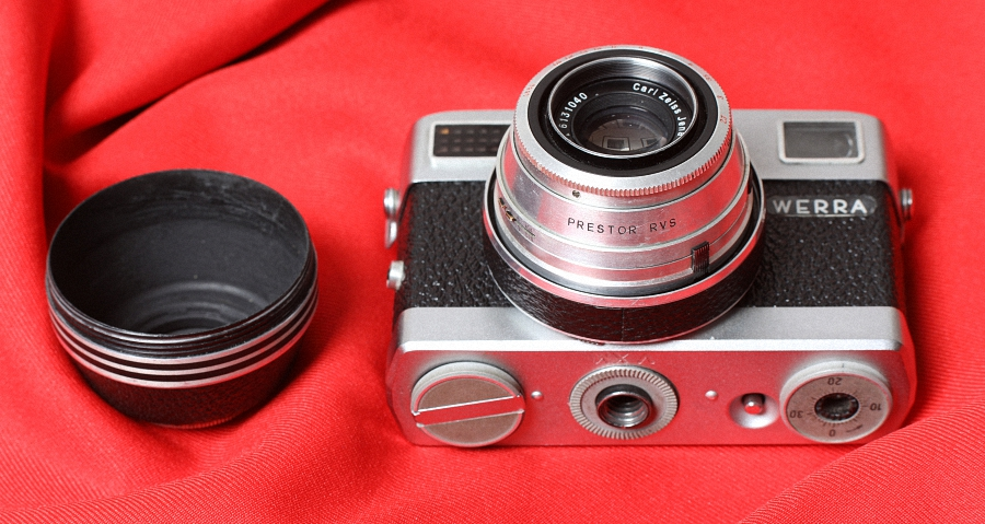

It won't be an extinction meter but far more likely a selenium photocell. Very much like a very small miniature solar panel. Does the front of the camera have a square window with either a grid over the front or plastic with moulded bumps all over. If so, that is a selenium meter. The bad news is these will be around at LEAST 60 years old and will probably have ceased working completely or be hopelessly inaccurate. They are probably non repairable.
It appears not to be a Selenium cell John, although at first glance you'd think it is. I'm well aware what Selenium cells are, how they work etc, I've been using them for around 55 years :D
The camera came from a FADU member, it's an odd one not in the English language manuals or other publications, with this meter. There were variations not listed, after all early models had Compur shutters, then various Eastern German shutters. It needs photographs and comments on what affects the meter, it's not the front "cell", rather an opaque window 90º above it. Believe me it's weird.

I had a Werra 1 and the thing about it is the fact that is the most minimal design concept camera, with he mother of all lens hoods. Combine this with a 2.8 Zeiss Tessar lens and you have a superb camera. I would value a Werra 1 over other Werra models any day.

Your description does not fit anything I have come across before. The opaque window as you describe it sounds very much like the reflected light source for a frame within the viewfinder, very much on the style of the finder on a Kodak Retinette 1a or 1b where there used to be an opaque window to one side of the finder.
Can you describe how the 'meter' works. What sort of measuring scale does it have? Does it have a range of ISO (or ASA/DIN in those days)

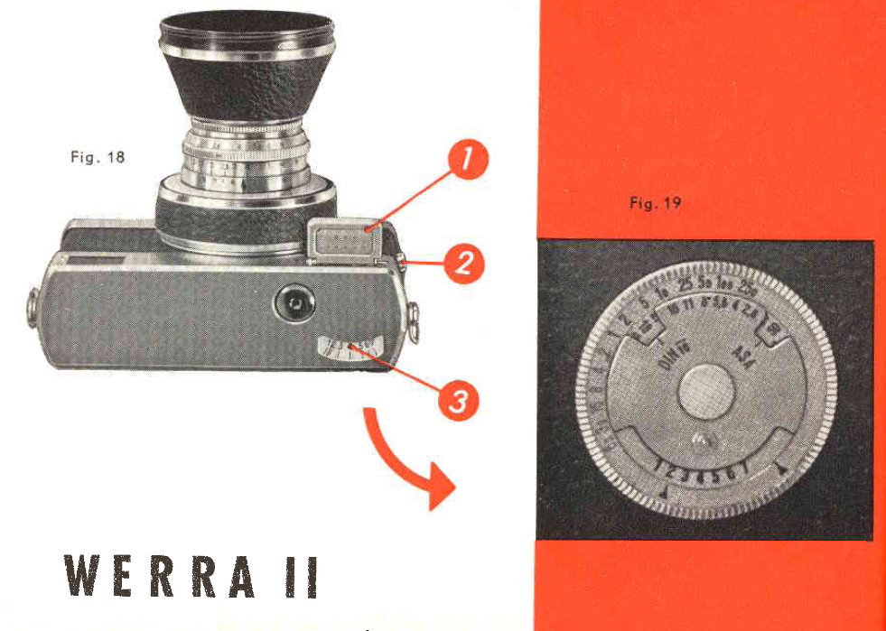

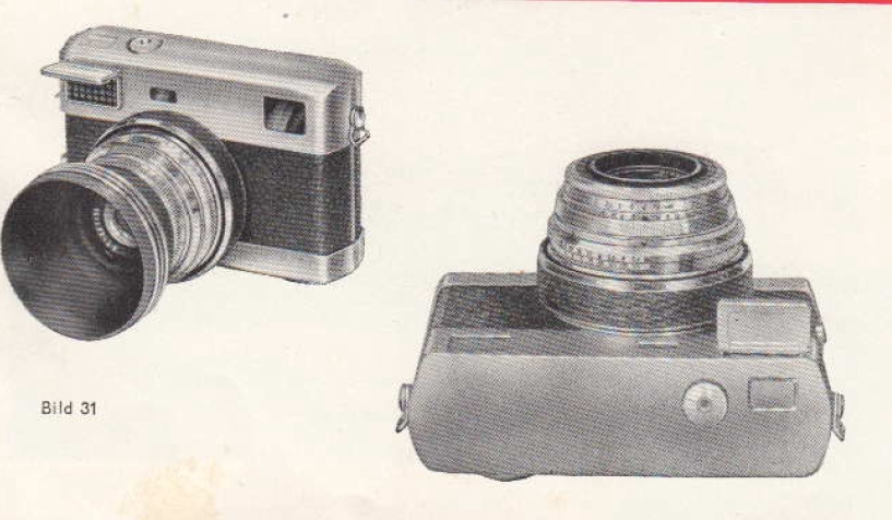

Hi, the Werra V model has two windows for the light meter. The obvious one with the hood at the front for measuring and the opaque one right to the trigger which illuminates the lightmeter scale in the finder (I just tested it). ISO selector (6 to 400) is located at the bottom end of the aperture ring

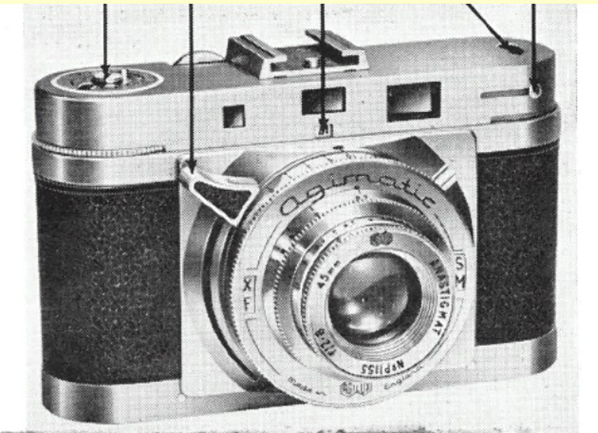

I owned a camera in the very early 1960's made by AG Instrumentation in Croydon, South London in the late 1950's called an Agimatic. That had the step wedge type of meter and was surprisingly accurate - if you had all the time in the world because it was a very slow to work and depended on your eyesight to adjust to the light levels prevailing at the time
That too had a similar film wind-on to the Werra, but instead of rotating a collar round the lens there was a lever on the side of the lens mount which you pressed down to wind the film and pressed again to fire the shutter. I wonder if the Werra was a copy and an improvement of the AGI version?
In the picture there are three windows on the front, the left one was the rangefinder, the right one was the viewfinder and the centre one was the extinction meter window with the step-wedge behind. To see the figures on the step wedge you had to look through a corresponding peep-hole at the back and wait for your eyes to adjust! That too had a 'Ready Reckoner' on the back to work out the exposure
Your Werra 1 has none of the windows on the front except the viewfinder

For comparison - the earlier type of lightmeter display on top of the camera showing EVs.

Here is the Werra data from 1963/4

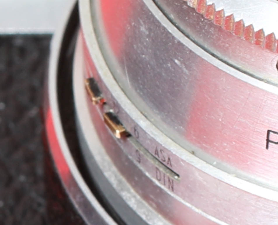

It turns out my Werra has a coupled meter, it doesn't look like any in the attached PDF. Now I've found the DIN/ASA settings which are almost invisible it must be a variant of the Werramat.

Seems there are some Werra cameras that use something similar to an EV scale, this is from one of their manuals.
You've helped my identify my Werramat, thank you, now the meter etc makes sense. Here's the elusive DIN/ASA scale.
