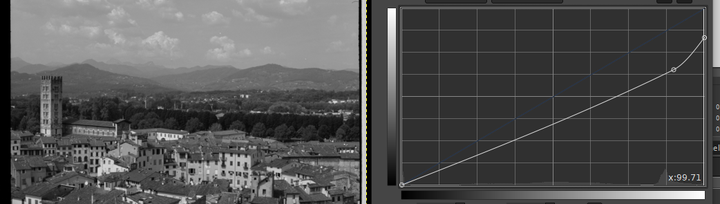

Reading also from the other comments maybe it's just me, but for me these images look rather flat, lots of midtones, not reaching a black, very grey highlights.
I agree that the images look flat. They look like this kind of curve:
Basically just very flat.
"premium" results
What do you understand to be 'premium'? I don't see much in the examples you posted that seems particularly special or 'premium'. Just very, very flat. If that's what you're after, it's easy enough to accomplish. Expose normally or overexpose slightly, then cut back development a little, and most importantly: in printing (or digital editing), print at low contrast and print down the highlights so that everything gets squashed into the midtone region of the print.
This really has more to do with printing or digital post processing than with film choice. (The example I posted was actually a color shot on Kodak Ektar, which I used only because I happened to have it open in Gimp...)

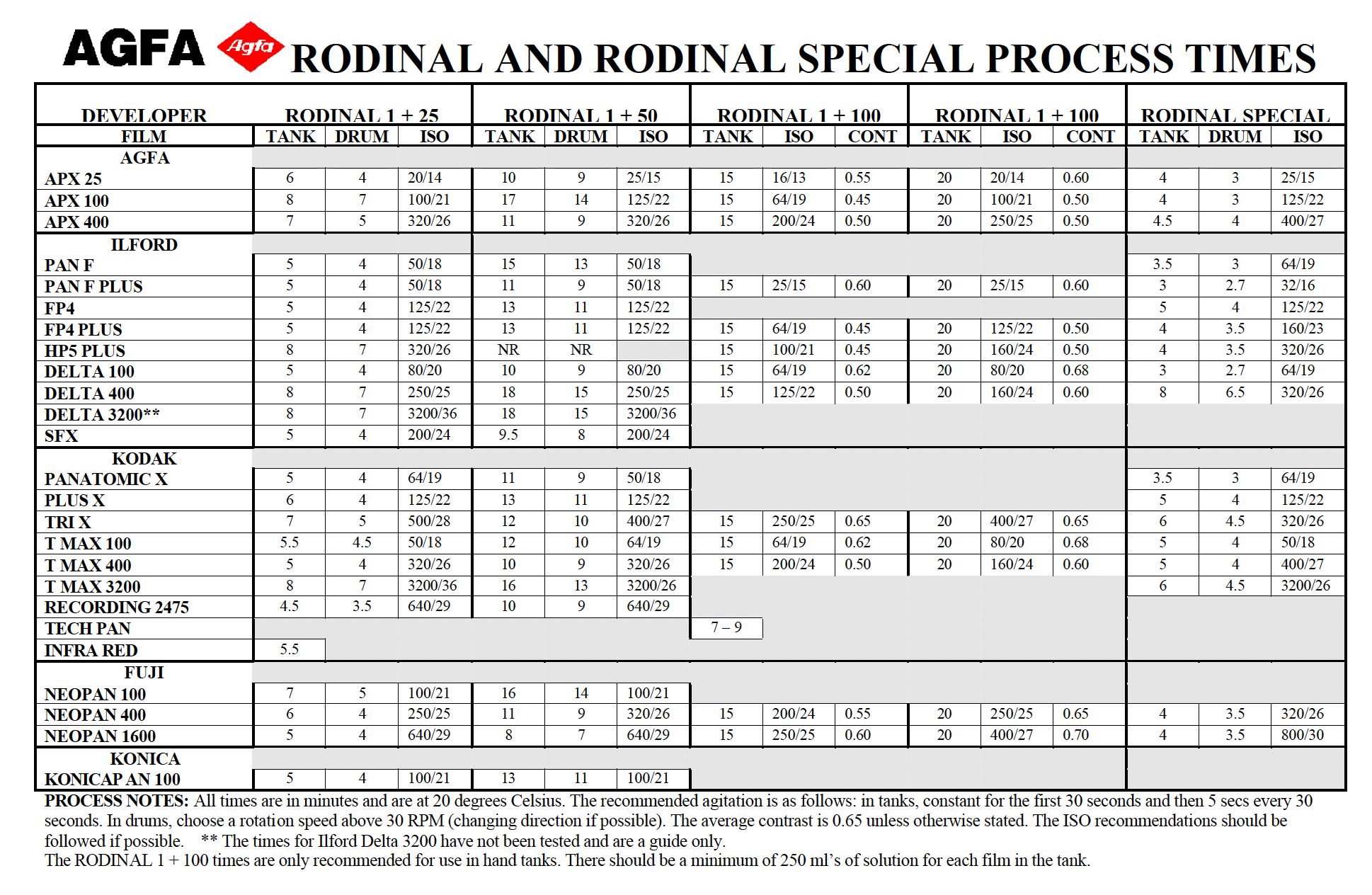

Back in the day when people used Tech Pan film, which could get very contrasty if you developed it normal, people would use a developer called "POTA" which was just phenidone and sodium sulfite. It can be used to reduce very high contrast.
Or in very dilute Rodinal 1+300 for 12 minutes
