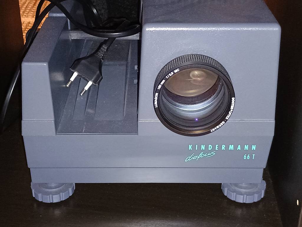

Kindermann 8703. I have have had one (pictured) now for over 30 years, but it has been little used since the digital revolution and the demise of so many of my favorite color transparency emulsions.
As I recall, they were quite pricey new, and I paid a few hundred for a used one. They are available via eBay now for only about $100, a real bargain! Sad that slide projectors now end up in trash or thrift shops.

Thanks! It's odd, because I looked up the 8703 on ebay, and it appears to be a different model than the one you have pictured (the only one for sale)

So, the manual vs automatic slide transition is what I was concerned about. The 66T, for example, automatically advances the slides. I'd like to avoid that
Mine is fully manual. The Diafocus has ports to connect projectors for fade transitions betwen projectors, mine has no such connections.
There is a manual focus vs. autofocus version as well, and some with single FL vs. zoom lenses.
Why do you want to avoid it? The automatic advance is very reliable. I had never any problem with it.
The lightweight 3.5/105 mm lens does not show how great medium format slides are. I recommend an upgrade to a 2.8/150.
