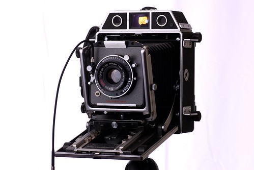

"Technical cameras" are a compromise between view cameras press cameras. The "Baby Technika" is a finely crafted triple extension bed example, and the Horseman version a superbly made double bed one, suited to a more conservative range of lenses. I personally find it more realistic to use 6X9 roll film backs in conjunction with my lightweight 4x5 Ebony folder, or even my fully-featured Sinar system. For handheld or quicker tripod shooting, I have both 6X9 Fuji RF's and the Pentax 6x7 system.
In general, simply adapting a 4x5 field camera to roll film back usage is going to be less expensive than purchasing a smaller dedicated roll film view camera, since those are a lot less common, and were often priced significantly higher even when new. Plus you still have a full image sized 4x5 camera when you need that primary option.
There are a few particularly small wooden roll film cameras out there, like the old Hansa model, or the non-folding Ebony and Shen-Hao ones with very limited bellows extension designed for wide-angle architectural photography applications. But you're only going to save a pound or half a pound versus lightweight wooden 4x5 folders. Super lightweight metal monorail cameras like the now rare Gowland and Toho are going to have compromised stability, especially in wind. Finding an old Galvin one still in decent condition would take a lot of luck.
The Fuji GX680 system is an outlier - needs its own lenses, is clumsy outside the studio, etc.

Baby Graphic?
The 2 by 3 Crown graphics with the Graflok back are great. Not too expensive, a fair amount of flexibility in lenses and movements, and not to heavy or bulky. I use mine a lot, with either a 6 by 9 or 6 by 6 roll-film back, a Grafmatic, or double-sided film holders. The one downside is finding viewfinders for the various focal lengths and formats, but that might go for a lot of the other cameras.

I 'need' is something with all front movements like the Fuji, but preferably less electric if that makes sense.
Horseman or Lindhoff MF would make sense. Roll back or film back, not sure if there is a 6X7 back, but you can shoot 6X9 and crop when printing.

The Horseman FA rear movements are just like the Technika - four extendable rods in the back, one at each corner. There is normal ground glass focussing,
plus a rangefinder on some models.
