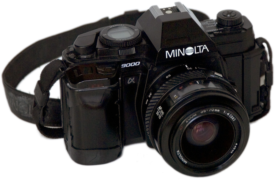

Here I would like to focus on removing the mirror box in order to clean the shutter.
The infamous sticky shutter on the Minolta 9000
A problem that probably affects most 9000s is sticky contamination on one or both shutter curtains. This prevents the curtains from moving and results in incorrect exposures and even empty shots.
The cause of this is a damper on the base of the shutter for one of the shutter curtains, which is made of plastic and is decomposing.
Cleaning the shutter curtains from the outside is possible, but does not solve the problem unless the damper is removed and adequately replaced. For this the mirror box has to be removed.

Plastic that detoriates over time into a sticky mass
I had previously disassembled a Minolta 9000 on my own without instructions, which is not recommended given the complexity of this SLR.
But I was able to take a closer look at the problem with the damper in the shutter:
Shutter unit removed, frontside.
Shutter unit, backside, partially disassembled.
On the underside you can see the damper, which disintegrates into a sticky mass.
This mass is absorbed by the rear shutter curtain each time the shutter is released, causing the curtain to stick together and no longer move correctly.
