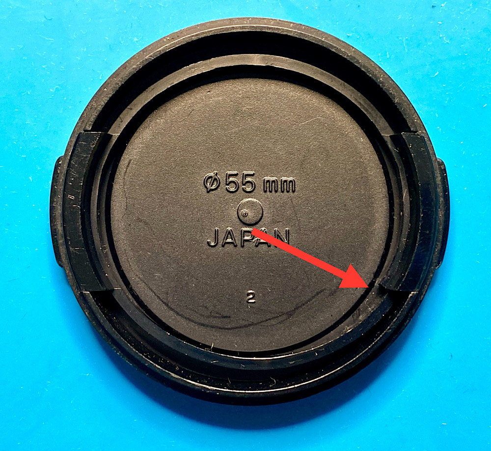

Original lens caps for Minolta MD, whether for the front or rear lens, are relatively rare and therefore expensive.
Inferior replacements are no joy.
It is therefore worth repairing a damaged lid.
While the back covers are made from one piece and are therefore robust, there is a weak point in the covers for the front lens.
Namely the plastic spring that spreads the cover in the filter thread of the lens and thus fixes it.
This spring can break. Then the lid no longer holds on.

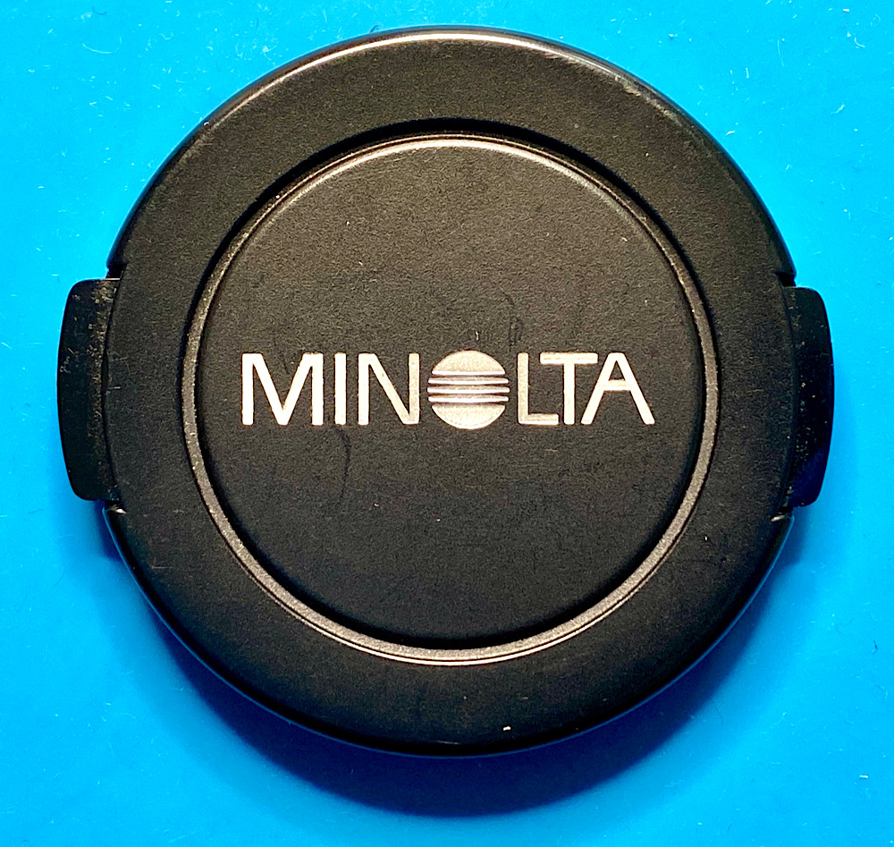

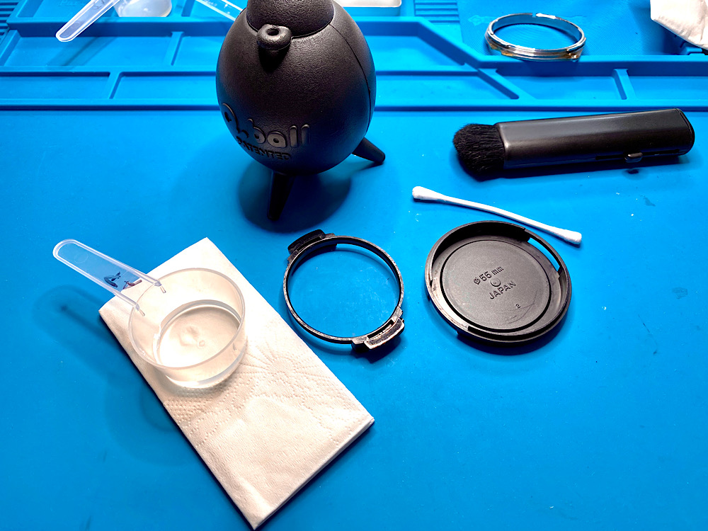

The original from Minolta

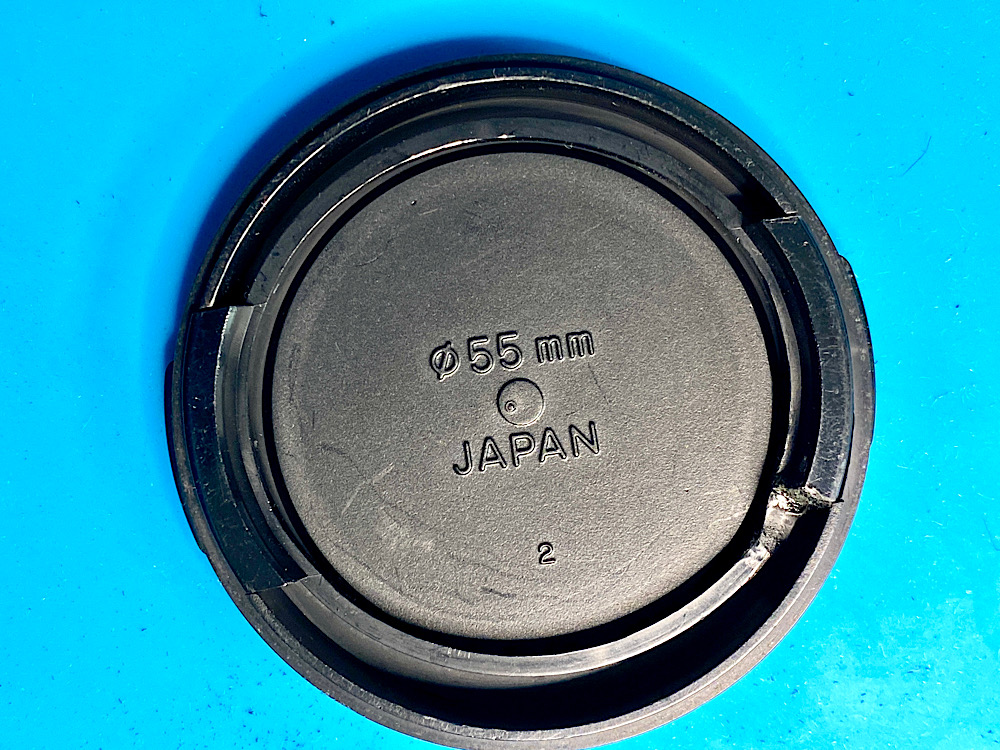

The breaking point

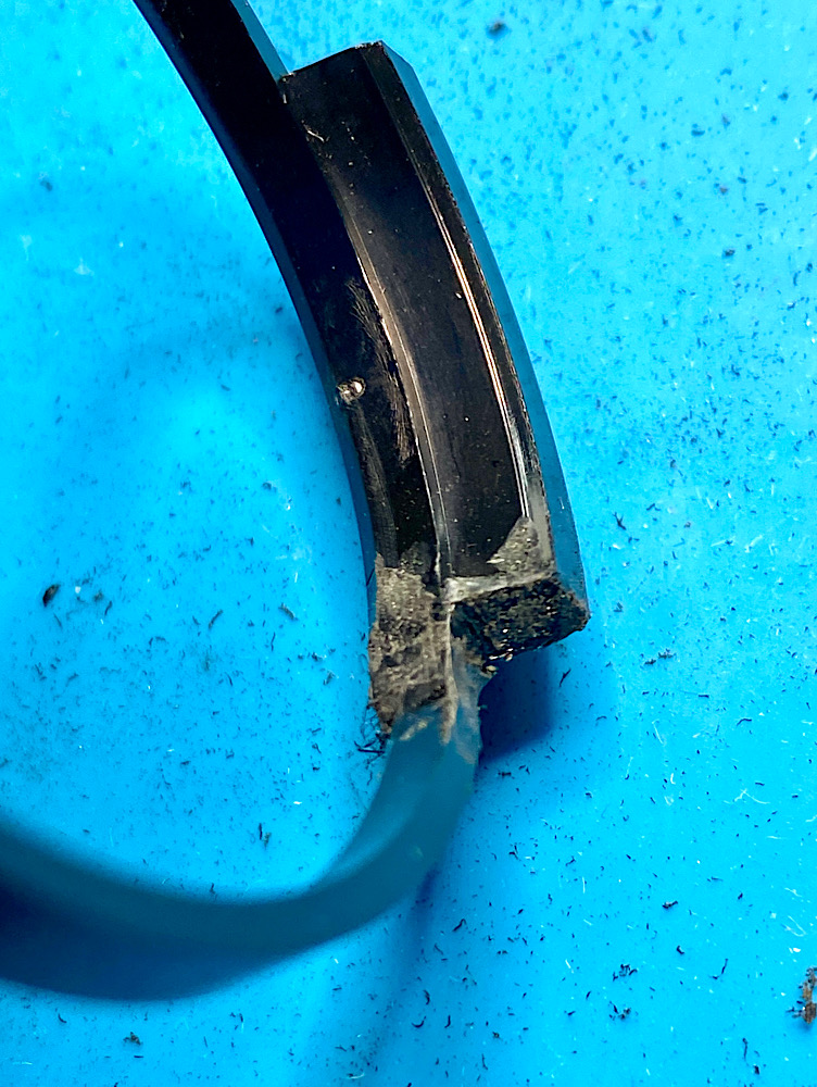

Since I haven't had good experiences with gluing here in terms of durability, I'm going to weld it now.

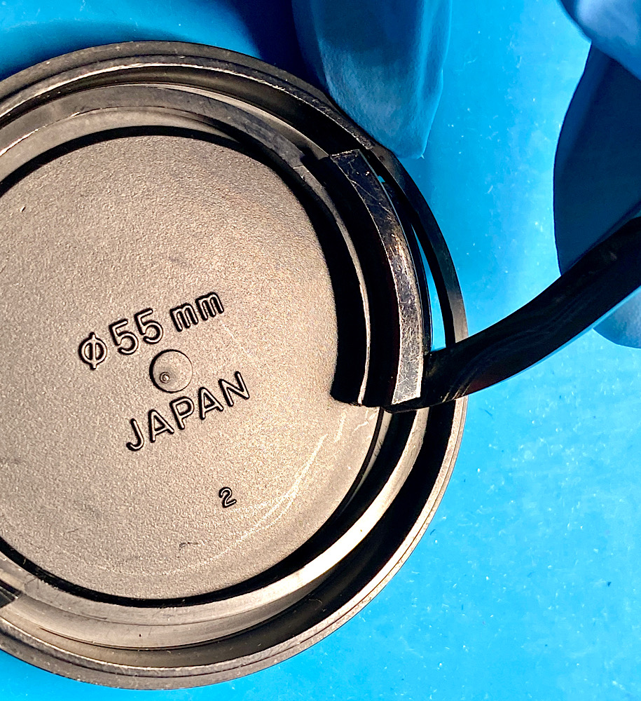

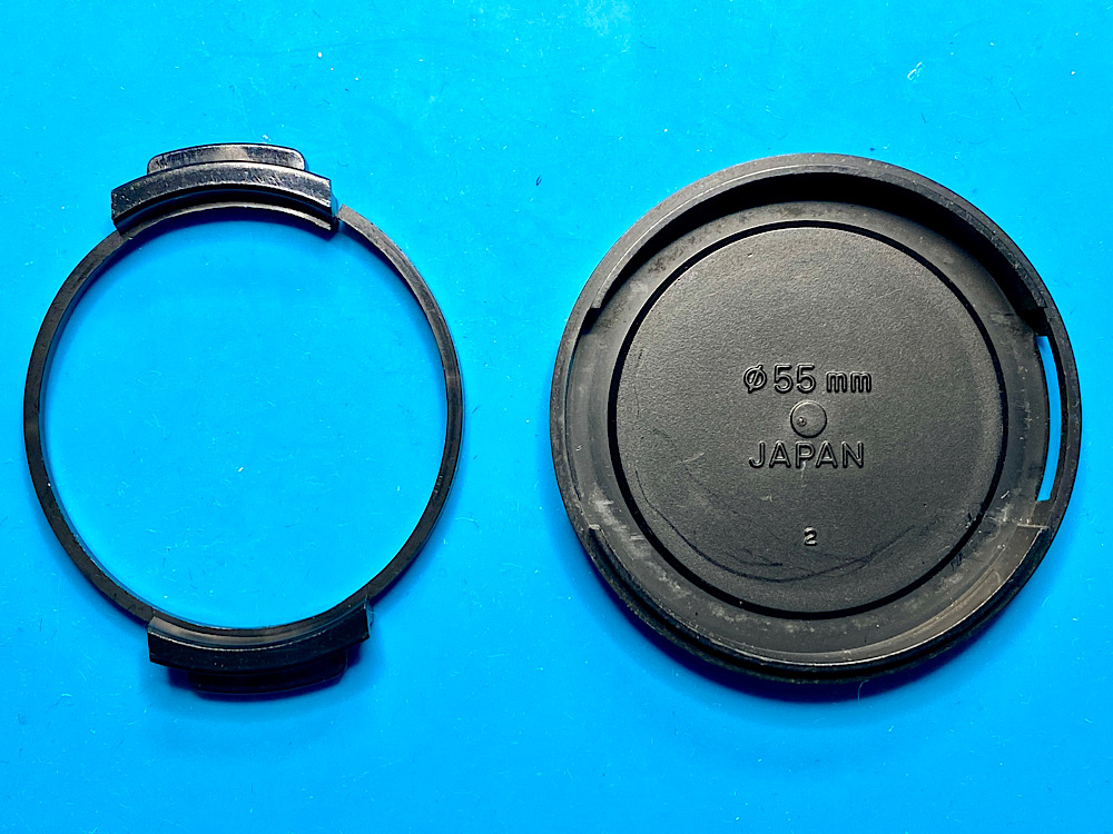

Lever out the broken spring.
Clean the area under the spring with Aqua Purificata or tap water.

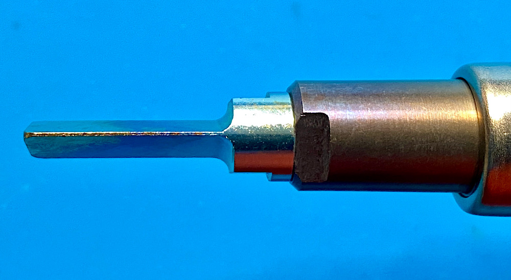

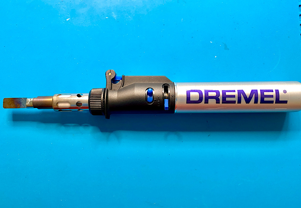

The Dremel Versatip, a butane gas burner, with a hot knife attached.

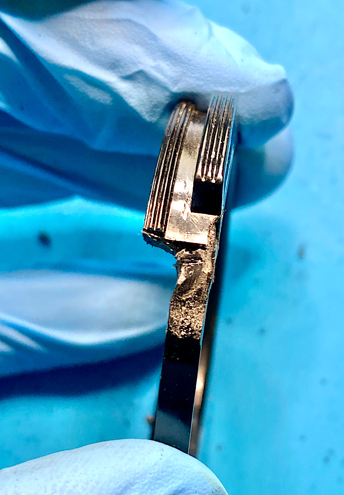

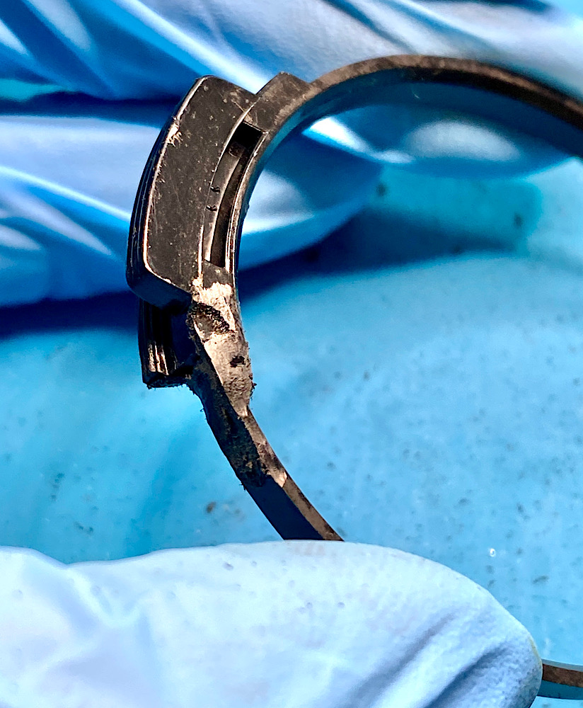

The two broken ends are then heated and joined together.
Then smooth the area with the scalpel.

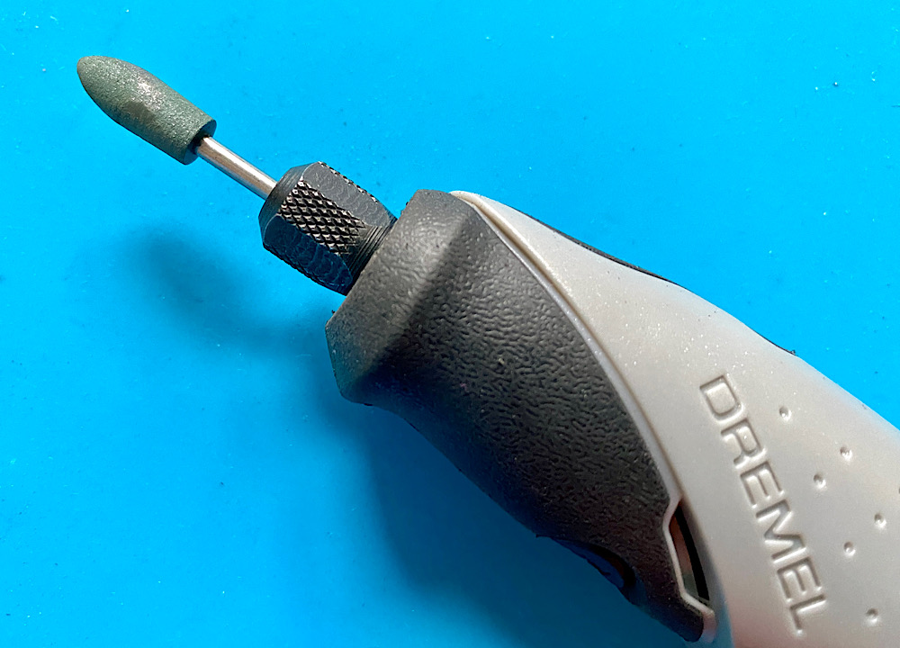

Fine work with the Dremel Stylo, with the hard rubber polishing tip attached.

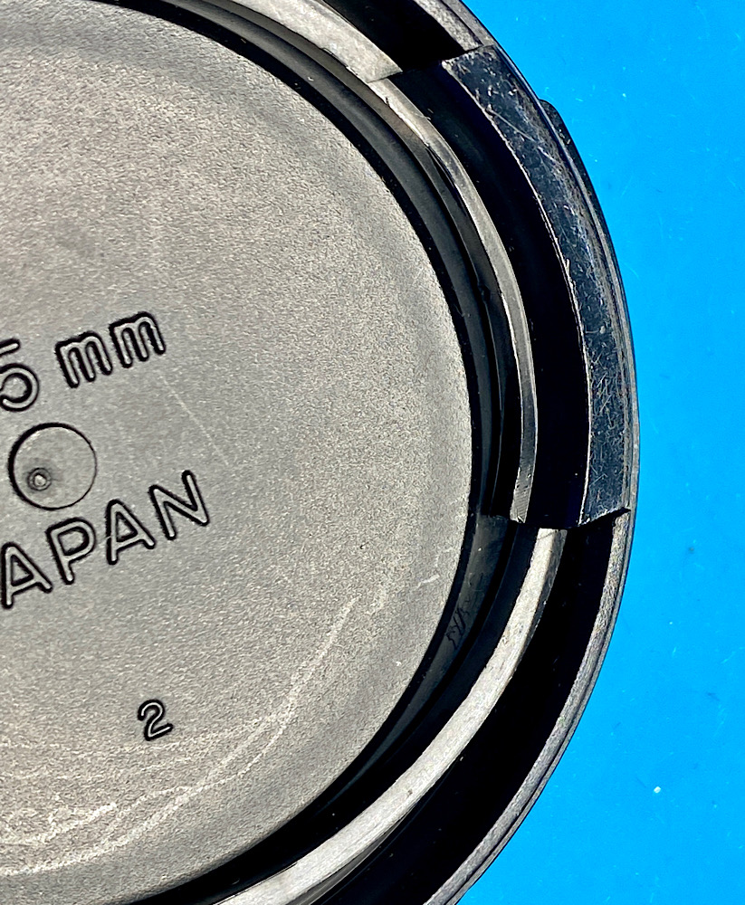

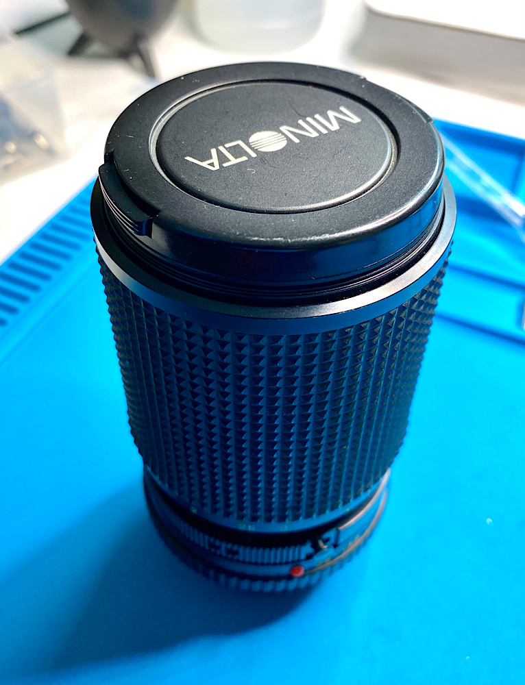

The spring goes back into the lid.
This puts some stress on the welded plastic when the spring is compressed, but the connection holds.
Sits
I had to try using the Versatip until it worked.
I separated and put the spring together several times, compressing or losing material in the process, and thus shortened the spring somewhat.
But the cap stays on the lens.
Heat the area with the hot knife and then spread it at full power, like butter on bread, that's how it worked best.
Open the window wide - the process creates a smell 😉

Post note:
You can also use the Dremel Versatip without an attachment. Then the two spring ends can be connected directly as soon as the plastic melts. But the material can also be shaped at the same time with the hot knife.
