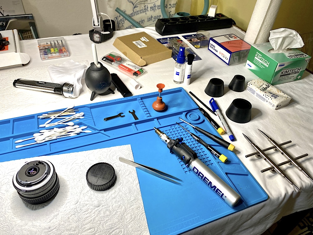

A nice 35 from my inventory, it was deoiled in the workshop a few years ago.
Meanwhile there was oil on the aperture blades again and the aperture only wanted to work in slow motion.
After getting a briefing from Matt Bierner on what to expect during disassembly, I set to work.

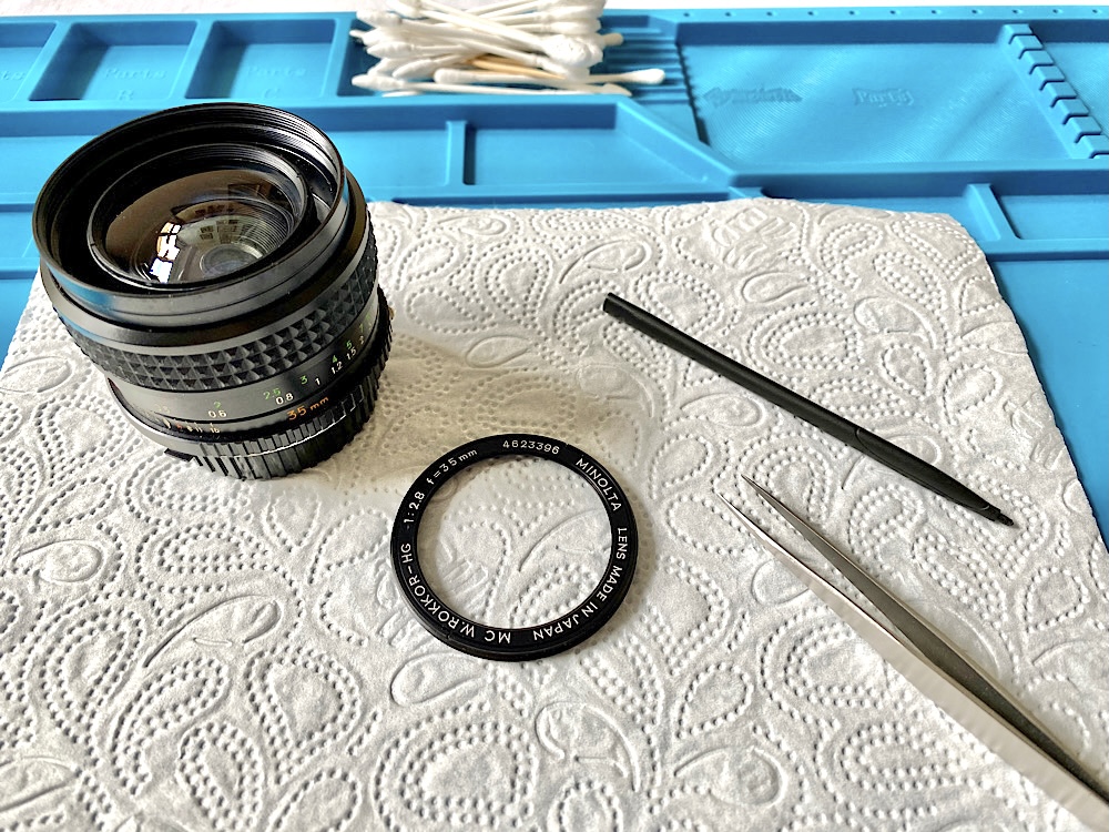

Using the vacuum pad, which are hollow rubber cones cut at the top (see also pictures below), I unscrew the decorative ring.

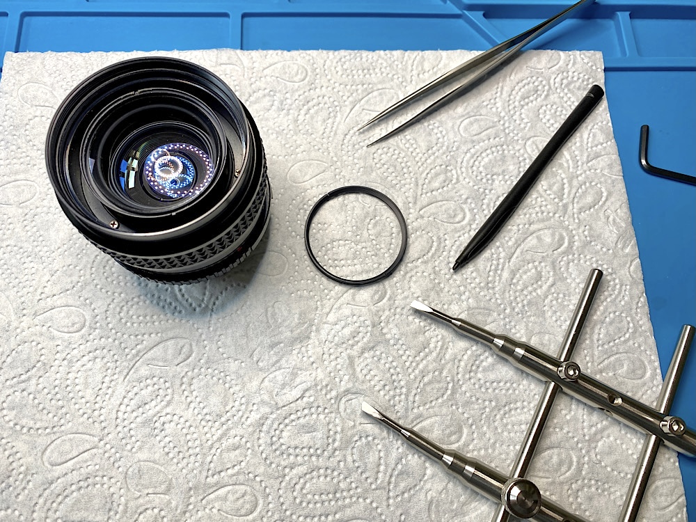

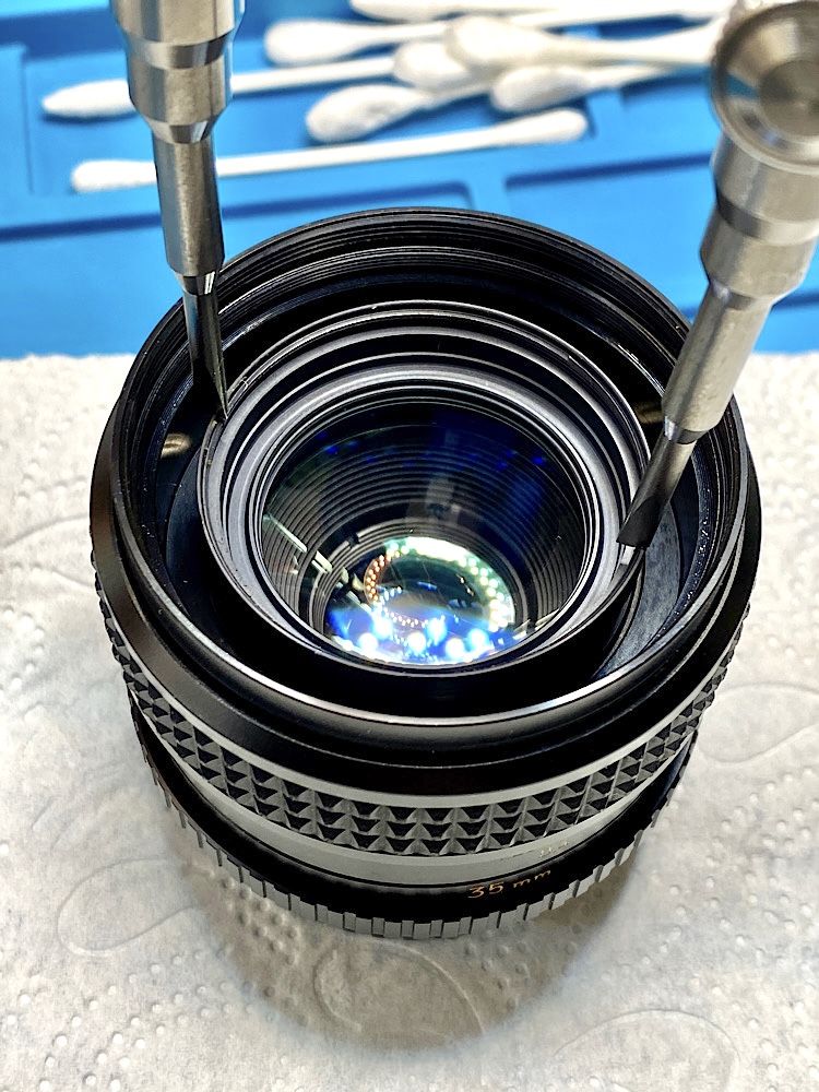

The spanner wrench loosens the retaining ring for the front lens, which can then simply be unscrewed.
The lens sucker lifts the front lens out of the tube.
The top of the lens has a water-soluble marking for orientation.

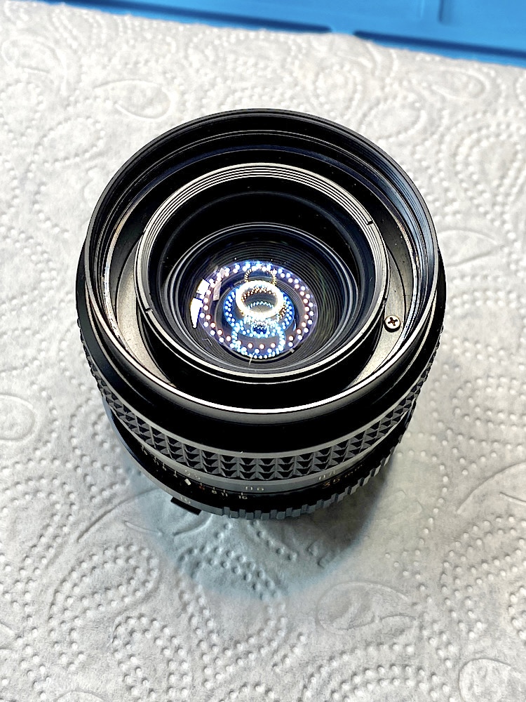

The assembly above the aperture blades, consisting of two lenses, can be easily removed using the spanner wrench. I then hold the unit with two fingers and rotate the lens until the assembly is free.
This is quicker and the movement is even. This is particularly important when screwing in, as it prevents the ring from jamming in the thread.
The top of the aperture register is exposed.

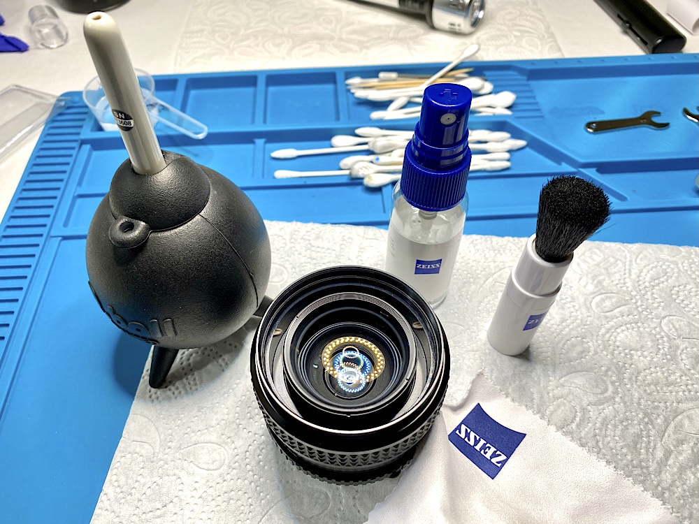

The front lens receives an extra cleaning service with products from Zeiss.
