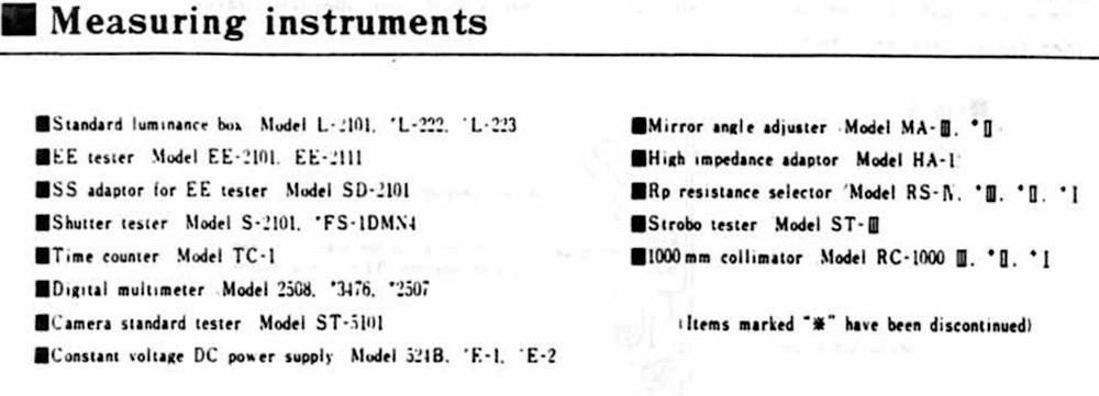

The Minolta Service manual lists the following measuring instruments for adjustments on the X-700.
Some of them I can imagine, others are unknown to me.
I wonder if these devices can be substituted today to be able to carry out the measurement work? Some of the original devices are already historical.
  • Standard luminance box: provides defined exposure values (EV)?
  • EE tester: What do you do with it and what does the abbreviation EE stand for?
  • Camera standard tester?
  • Strobo tester?

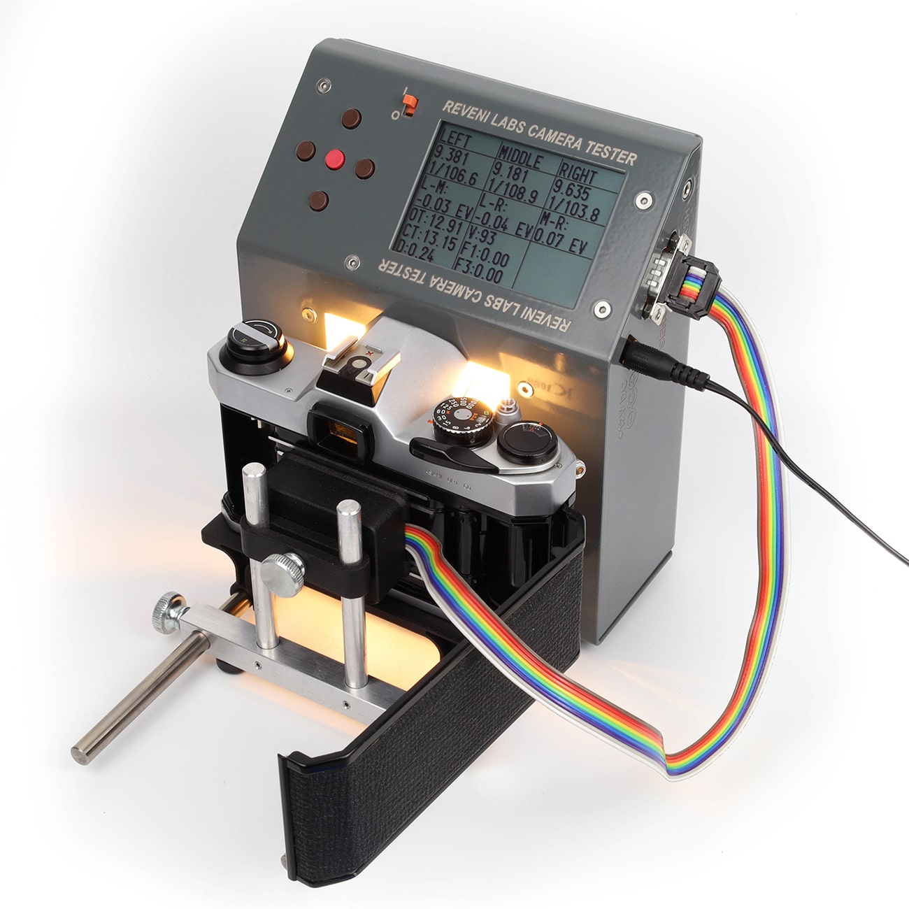

If Reveni Lab's Kickstarter project (tip by @ic-racer) covers most of these functions, should the X-700 be fully adjustable again? Apart from the mirror angle adjuster?

That tester looks great! If it's built around Arduino, that should bode well for longevity, and the source code should be easy to customize.
Zenit camera mirror angle adjustments are used for viewfinder collimation. It's not difficult.
"EE" was a common abbreviation for "Electronic Exposure" aka Automatic Exposure.
A mirrorless digital camera fitted with manual focus macro lens can function as a collimator.

The EE (Exposure Error) function of my tester uses a sensor that both measures light intensity and the shutter speed. I believe that Reveni tester does the same.

And then I'll take a look at whether the Reveni tester is solid on the market and will probably order a copy. For me the device is surprisingly affordable.
