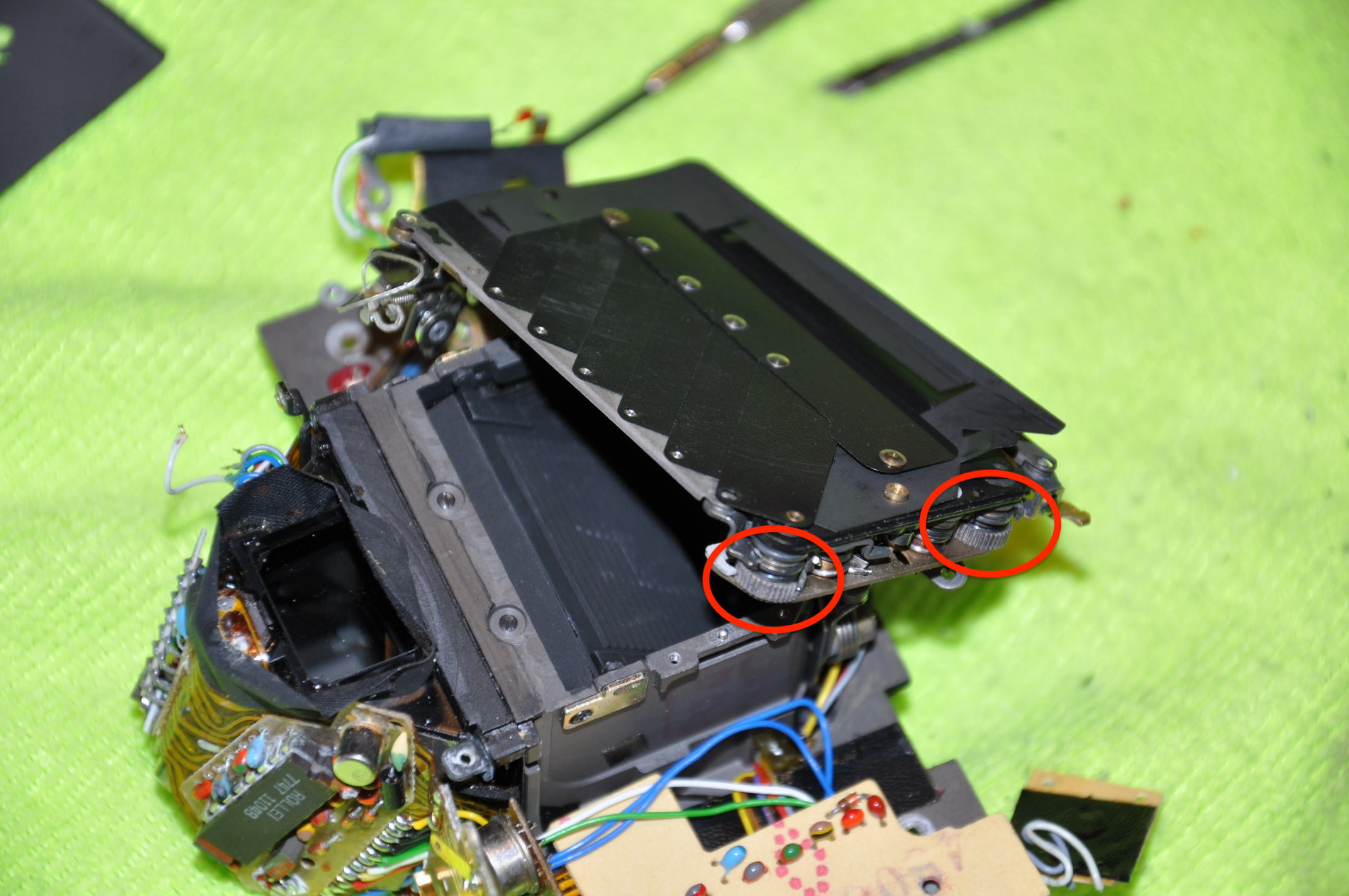

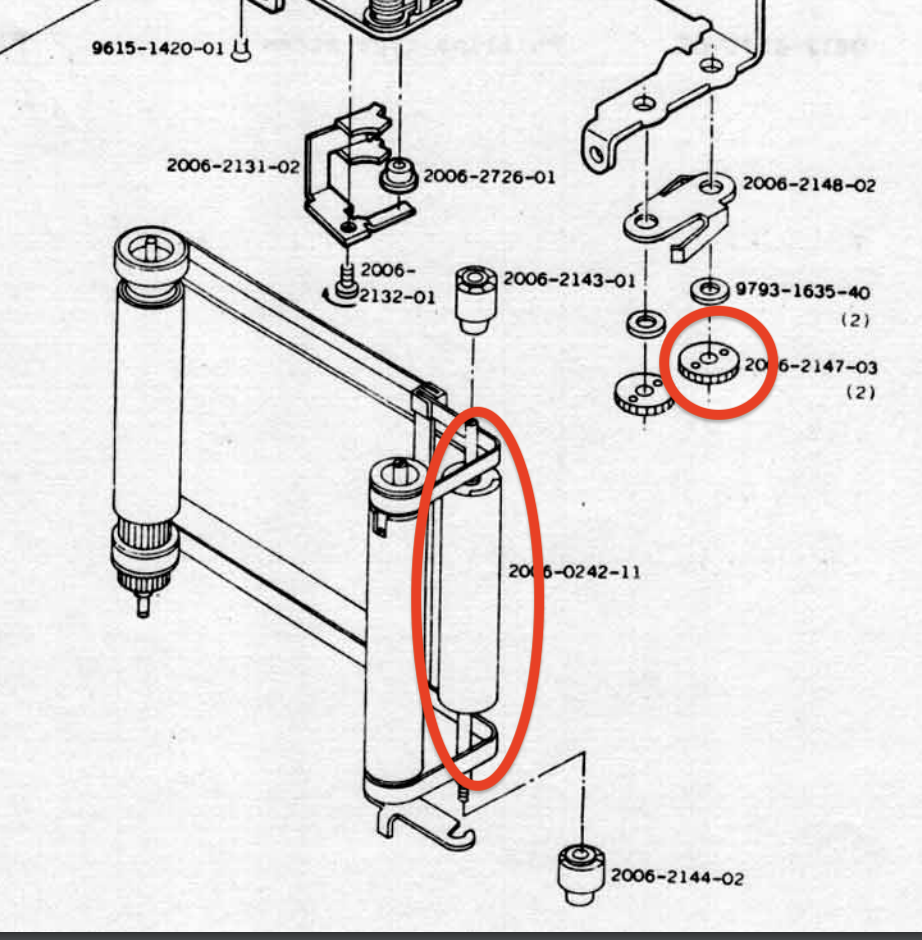

I played with these two locking wheels.
I think they determine the pulling force of the wound rubber band for the two shutter blinds.
That would mean that both have to be brought to the reference speed (hopefully) specified in the service manual.
The distance between the blinds behind each other is a matter for the electronics (magnet - setting via potentiometer).
Right?

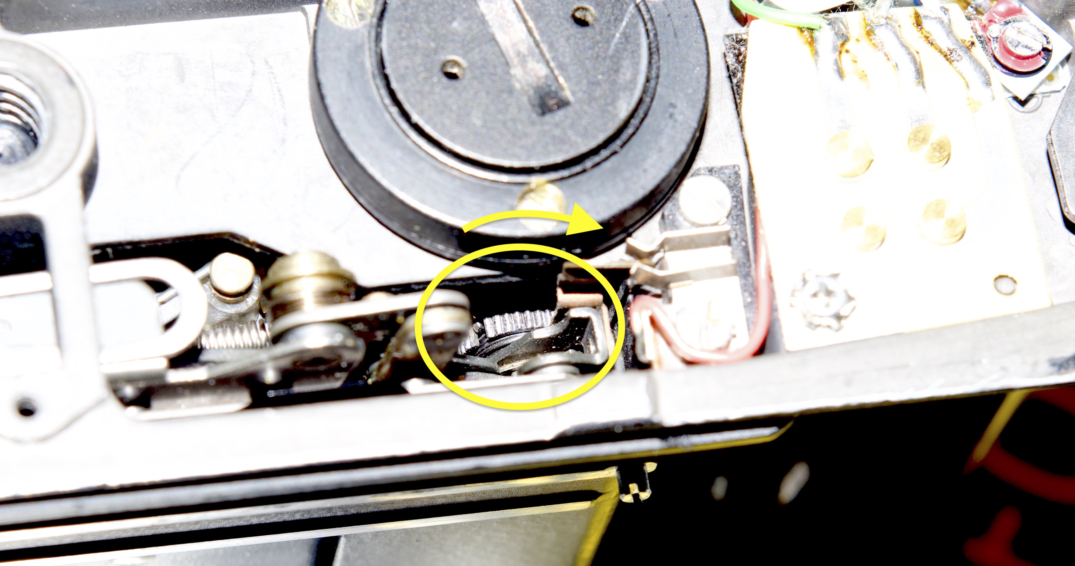

For best results the whole mechanism would be disassembled and cleaned, but for just experimenting, determine which wheel is for the opening curtain (see diagram below). Then use your new shutter tester to adjust the wheel so your transit time is 11 milliseconds for the first curtain. You might have to measure the space between the sensors on the shutter tester to see if it is 32mm.
Usually it is a metal spring in a tube that pulls the curtains across. The first curtain adjuster would be the one toward the back of the camera.
Now that you have your shutter tester, you might want to get any old camera with cloth shutter and replace the curtains (re-gluing the curtain to the drums, re-timing the gears and setting the spring tension). Aftrer you do that you will know everything about how cloth shutters work!

I may have had the arrows wrong on the last image.

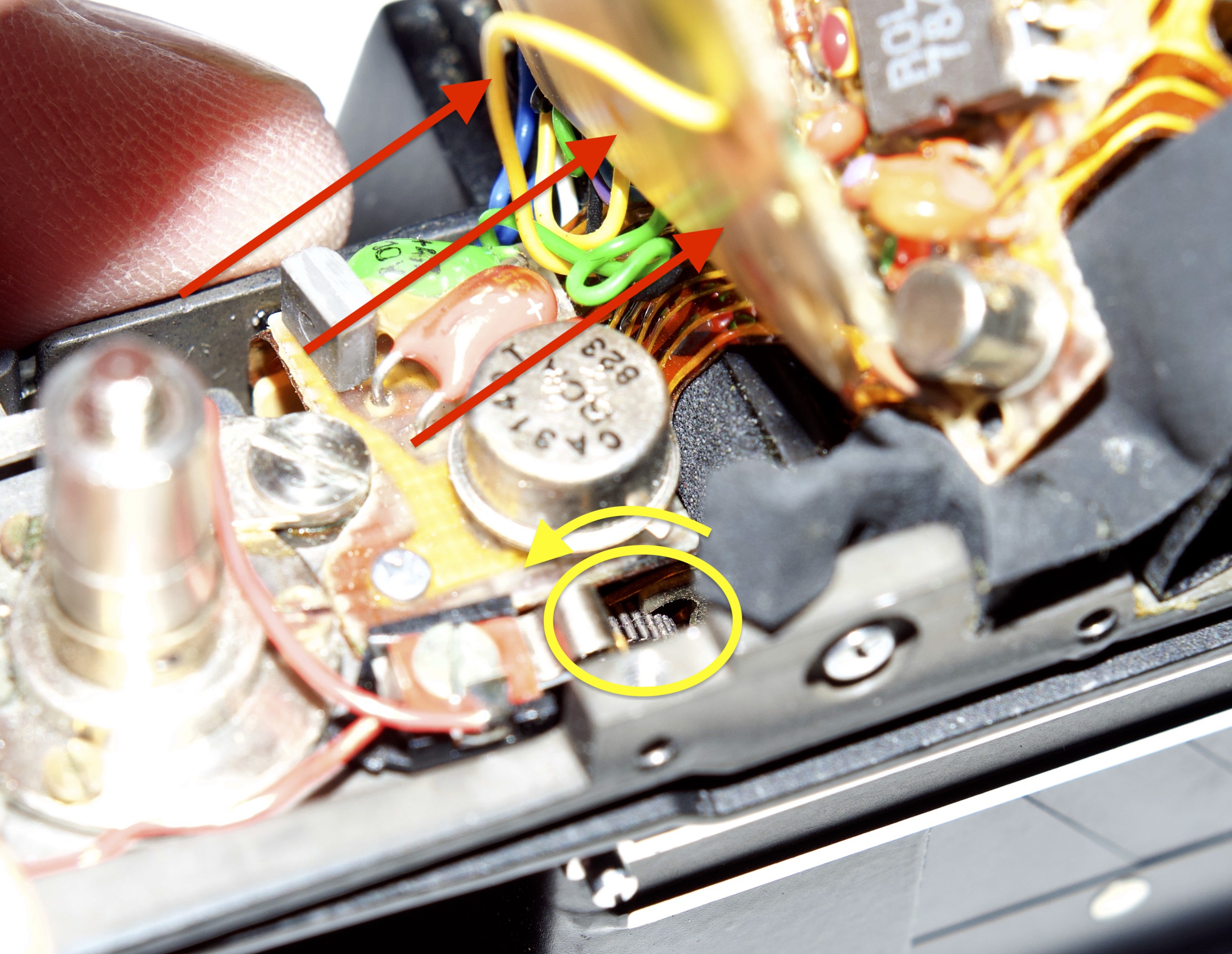

Sometimes you can peek in and see the adjustment wheels...

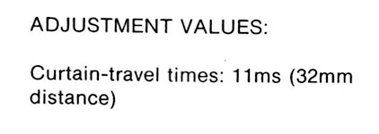

Curtain Travel Times
From an issue of the SPT Journal for the Minolta XG-M:
This information applies to older camera testers, whose sensor distance is 32 mm and is converted to 36 mm for the Reveni Labs Camera Tester.
This means that the curtain travel time, which I will set as the target value, is a little longer, namely around 12 ms:

I had to do something similar to find the actual distance between the sensors of the Rolleiflex tester. Rollei only gives the travel time, not the distance.

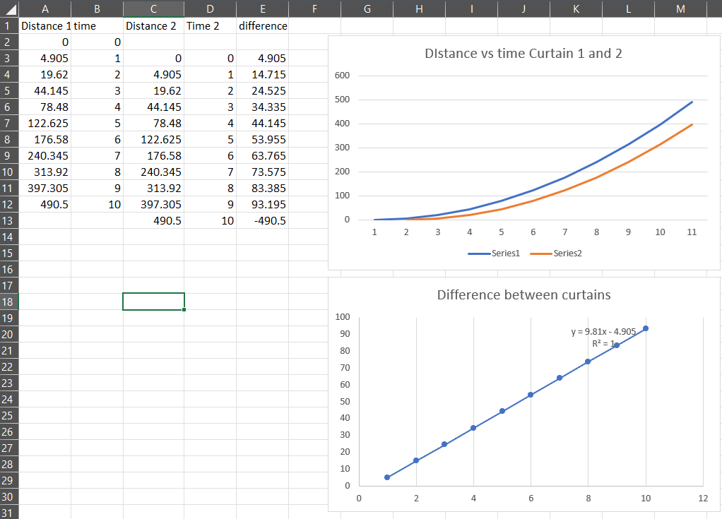

You can see it here. If the first and second curtain had the same travel time, then the slit width would be the same across the film plane.
They do have the same travel time, just offset.
I did the math in Excel to find the distance travelled for two curtains, the 1st released 1 second before the 2nd. The distance between them steadily grows by the acceleration (I used 9.81m/s/s here). multplied by the time difference. Curtain 1 will always keep moving ahead of curtain 2 if they always keep accelerating forever. And from the table we can see, every distance point is reached by curtain 2 exactly 1 second after curtain 1, so the exposure time is always 1 second for any location on the film plane.
Curtain 1 travel time should equal Curtain 2 travel time. If Curtain 1 equals Curtain 2, then exposure at any location on the film plane will be the same. The exposure time will be equal to the time delay from Curtain 1 release to Curtain 2 release.
Nice! Thank you for figuring it out!
I should have know that as I did some automotive race engineering in the 1980s. Two equal cars leaving a corner, one after another, will get farther apart down the straight doing the same lap times.

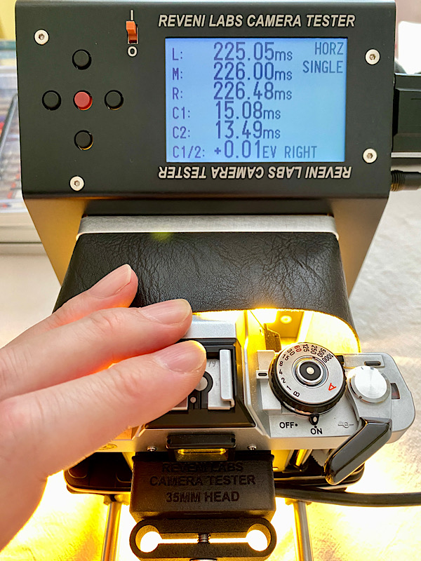

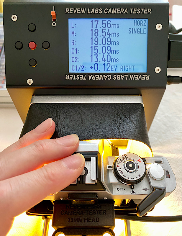

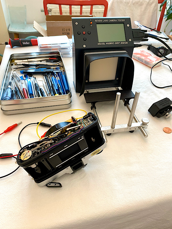

Curtain-travel times and shutter speeds: First use of the Reveni Labs Camera Tester
After having familiarized myself with the Reveni Labs Camera Tester, today I want to adjust the horizontal focal plane shutter on my Minolta XG-M.
The speed of the two curtains will not be correct, as I had already played around with the adjustment wheels for the curtain tensions.
I take the curtain-travel times from the SPT Journal:
For the tester, I convert it from 32 mm to 36 mm sensor distance:
=> Target curtain-travel time is 12.4 ms.

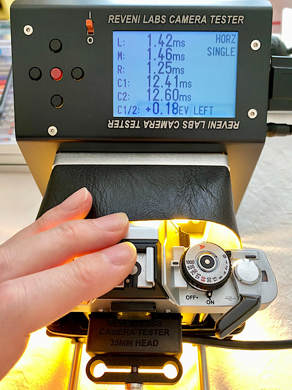

I measure the shutter speeds per sensor (L, M, R) and the curtain-travel times (C1, C2) for 1/1000 second.
1/60 s
1/4 s
The tester optionally displays the shutter speeds as fractions, which I am more familiar with.
Since I did not photograph the corresponding displays, I convert the shutter speeds myself and use the values of the middle sensor (M):
=> 1/4.4 s, 1/54 s and 1/685 s
The result shows that the values for 1/4 s and 1/60 s are close to the target values. At 1/1000 s the shutter speed is clearly too long although the curtain-travel time is ok.
Since I have no experience and would like to gain some here, I will try to set the curtain travel time on the camera for 1/60 s in the first step.
The aim is to get both curtains to have a curtain-travel time of 12.4 ms. Currently they are running too slowly.

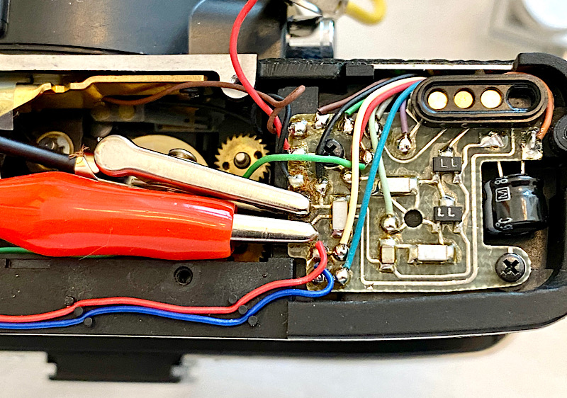

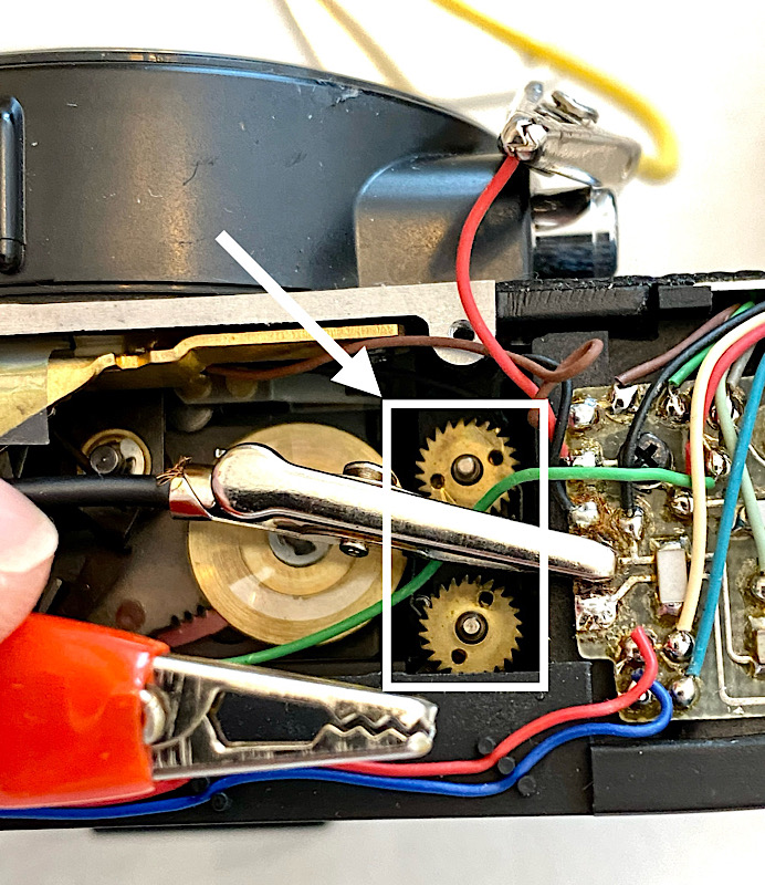

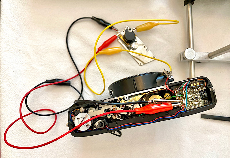

Making settings on the XG-M

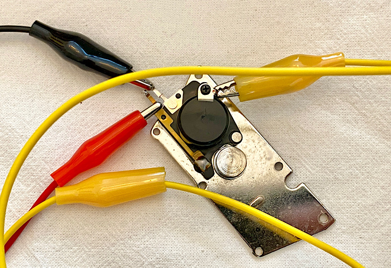

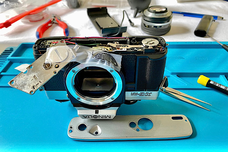

To reach the two adjustment wheels for the curtain tensions, I remove the base plate and desolder the plate with the battery chamber.
Then I connect the disconnected power supply to the camera via cables.
I have to be careful not to short-circuit the plus and minus. There isn't much space on the circuit board.

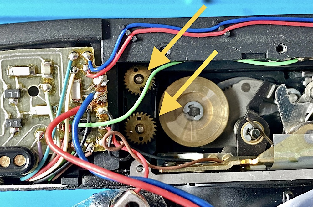

Here are the two ratchet gears for setting the curtain tensions.
To adjust the lower one, I have to loosen a crocodile clip.
Since both curtains move too slowly, more tension is needed here, which is transferred to the curtains via rubber bands. So I have to turn the ratchet gears until they are locked in place.
Of course, I turn the wheels in the wrong direction by releasing the catches. Now the shutter won't open at all.
The patience game begins 😉

Also, note that your RIGHT side, at 1.25ms, is not going to be affected much by the curtain tension. The readout is telling you the second curtain is being released 0.25ms to late.
Also, note that the upper time limit for 1/1000 (per ISO 516:1999(E)) is 1.59ms, so the camera is OK by ISO standards.
So, if you are working with tolerences smaller than what ISO specifies, you might want to check the calibration your tester with some camera you have that you purchased new.
