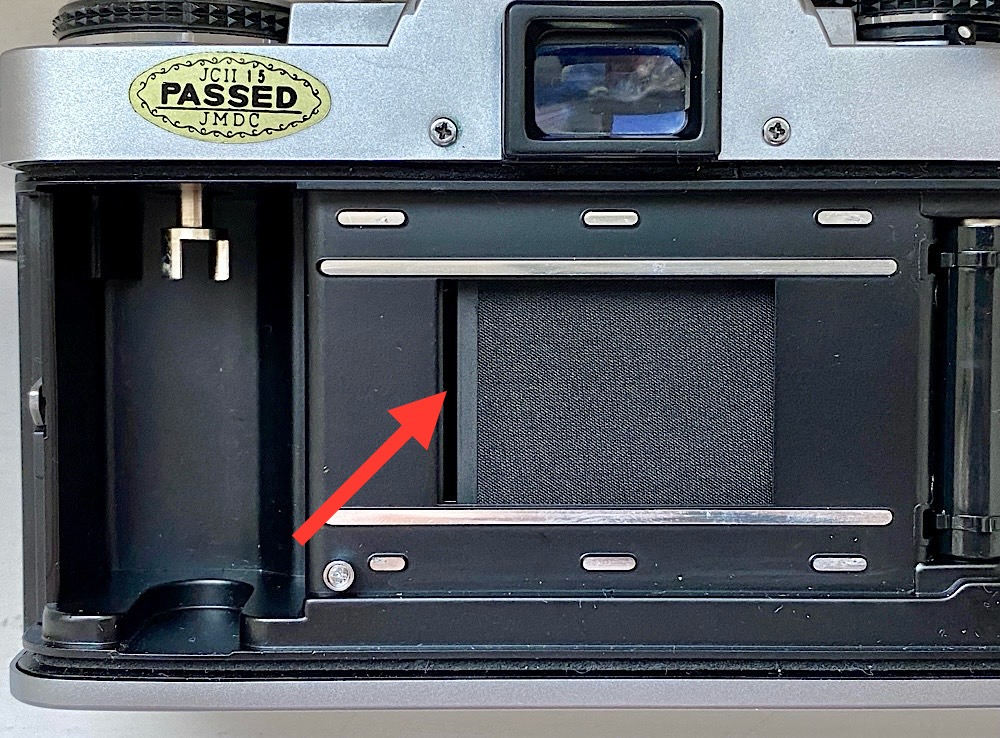

But it is a mechanical problem, the second shutter roller does not come back completely after the shutter is released, a gap remains open:
I used the tweezers to carefully pull the blind to the left, then the mirror folded down and the shutter was free again.
The LED displays in the viewfinder are also visible again, and they no longer go out as soon as I press the shutter button.
Shutter sequence and LED displays are otherwise ok.
There is a bit of a snag when you pull it up and you can also see a trace of abrasion on the metal bridge of the roller blind.
The problem occurs with the slow shutter speeds.
Everything was working again, only the second shutter curtain didn't close the image window completely, which is of course not good for a film that has just been exposed.

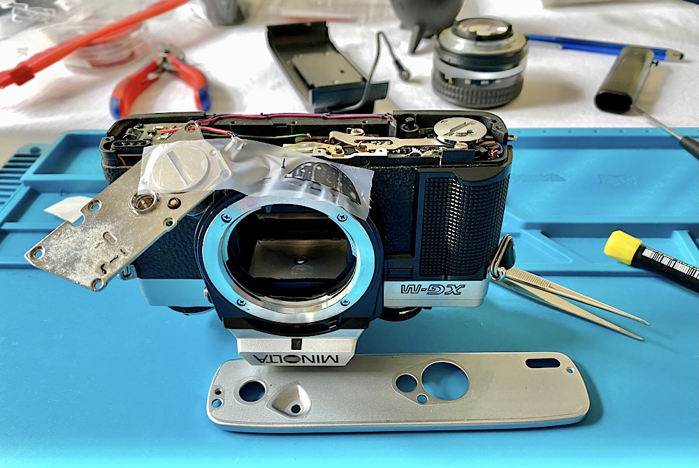

The base plate comes off quickly, the plate over part of the base mechanism needs to be unscrewed and the contacts from the battery compartment (which supports it) to the circuit board need to be unsoldered.
In order to be able to observe the shutter at work and what is happening in the camera base when it is cocked and released, I temporarily soldered the battery compartment to the circuit board:

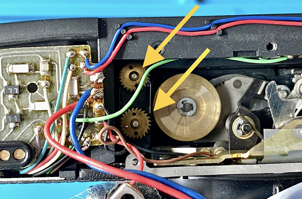

Now I was able to look for the two small wheels that are responsible for adjusting the shutter tension.
Here they are:
The two each snap into a pawl and increase the roller blind tension when turned counterclockwise. If you loosen the pawls with a small screwdriver, the wheels turn in the opposite direction by themselves.
I played with it for a long time to understand the mechanism and effect.
Attention, this probably has an impact on the formation of the shutter speeds, see below.
However, this did not solve the problem.

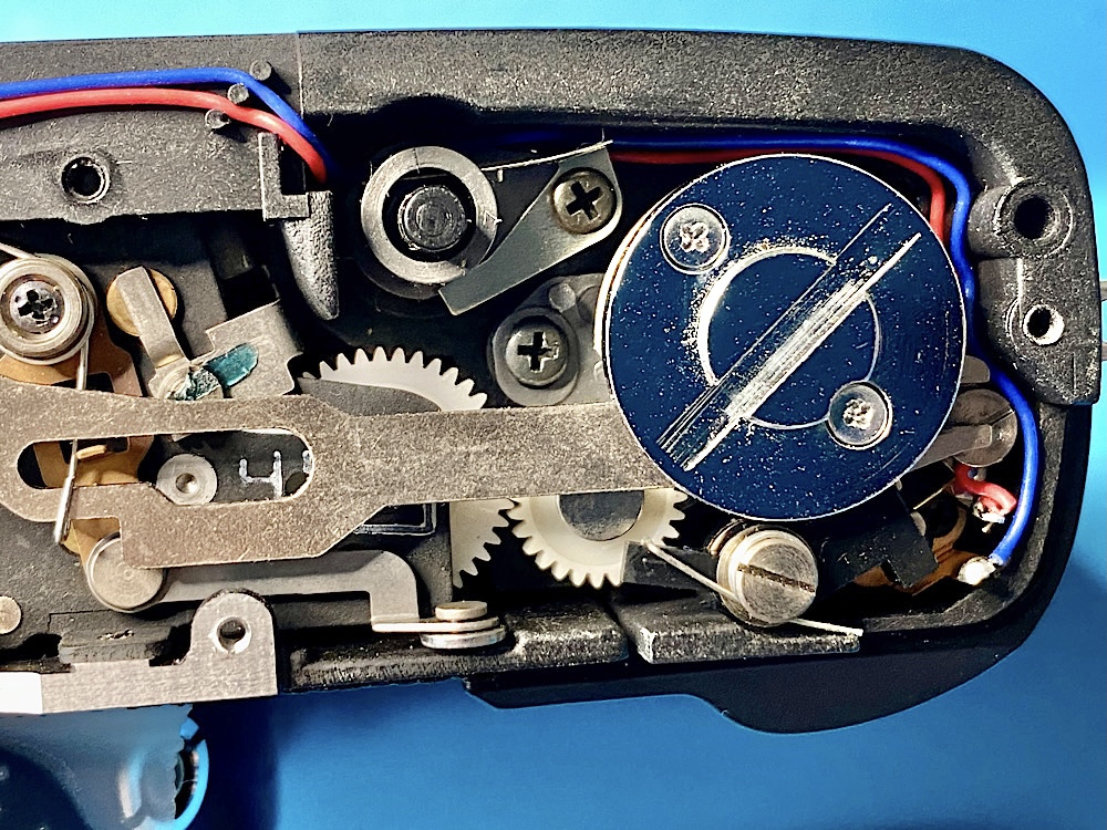

The coupling plate for the winder is located in the base on the right side of the camera.
When unscrewed, you see a gear with an adjusting screw that meshes with another wheel.
Turning the screw creates an eccentric effect. This allows the distance to the neighboring wheel to be corrected minimally.
Here is the area with the clutch plate still attached:
Experiments with different settings of the three wheels followed.

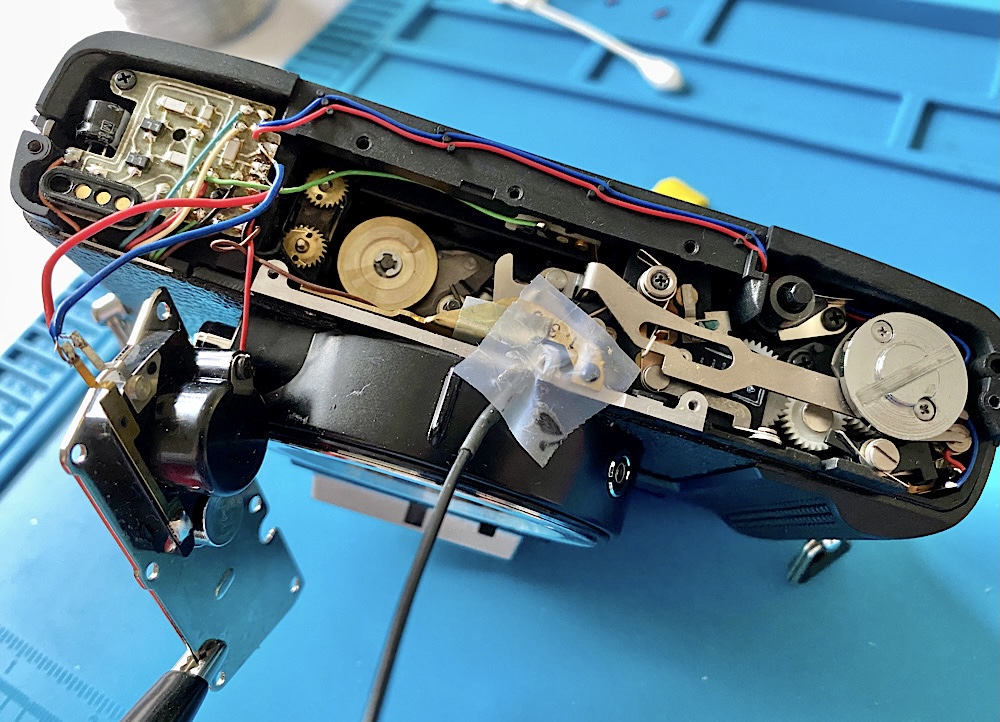

In order to correctly form the electronically controlled shutter speeds, I clamped a cable to the plate with the battery compartment and connected the other end to the metal chassis, which forms the ground of the circuit. Otherwise there will be no return conductor in the circuit and strange things will happen.
