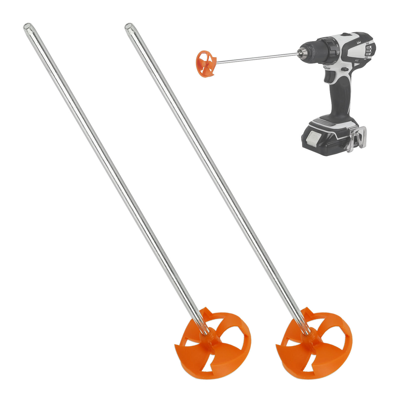

I got one of these to put on the cordless drill to mix it. :smile:

Assuming you're serious, don't use that. All that is required is manual stirring and a little patience. Mixing with a drill at too high a speed will aerate the solution, which is not good. Please follow the directions with respect to both mixing and water temperature.

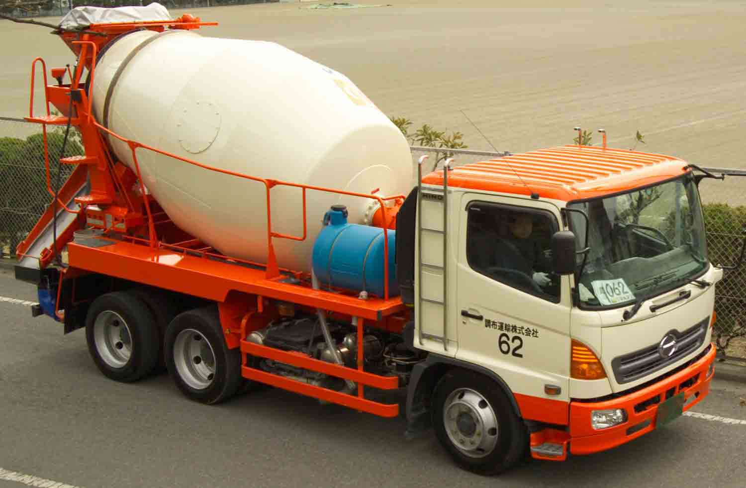

Actually, for large batches of developer, I use this.
Really, Microphen is my favorite developer for most uses. I mix it exactly per instructions and have never had trouble. It has two packets - be sure the first one is fully desolved before adding the second. I use water at 102F per instructions, then add cool water to make the one liter. I let is sit overnight in the bottle just to assure full solution. Has never failed me yet.
I was going to mix it slow-the drill will be about 150-200RPM. Will that be ok?
