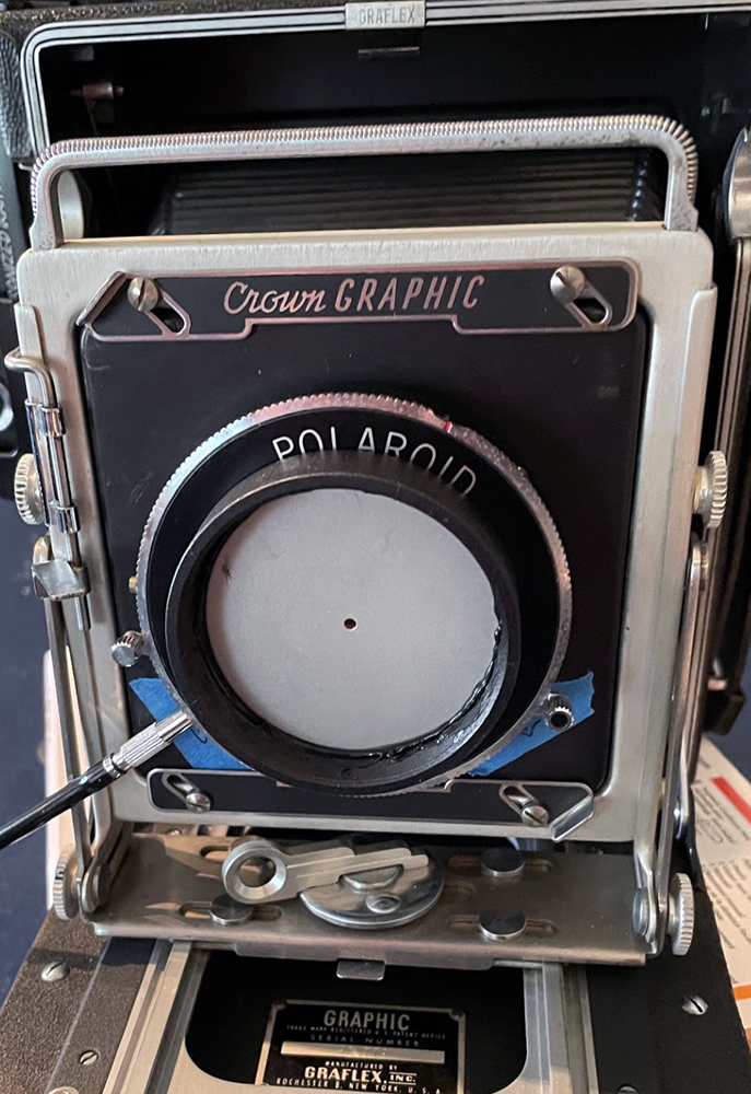

I have a shutter assembly for a Polaroid MP-4; it has Copal 1 sized threads. I'd like to mount a metal disc with a pinhole in the center to the shutter. I tried using a M40x0.75 filter adapter, but its threads are too short to catch the inside of the shutter.
I was going to purchase a shutter cap from Rafcamera (https://rafcamera.com/cap-m40x0-75m?srsltid=AfmBOoq6UT7Fqopl8Lghyul16oPopDjh9OWfRXusdCTGk5O26EOMUOXw), but the cost of shipping, and their disclaimer about the delivery time made me uncomfortable..
Can anyone suggest a non-destructive way to mound my pinhole disc to this shutter?

I've mounted pinholes into shutters by the simplest possible method: I taped the pinhole into a card stock disk (black, of course) cut to a drop-in fit for the front thread of the shutter, then built up a collar around the edge of the disk with black masking tape (gaffer tape would probably also work, though you'd need more clearance at the disk edge since the tape is thicker). The result is like a shallow cup with the pinhole in the center of the bottom; I just push this into the shutter thread. I've used this on my Ideal plate cameras and it's similar to the permanent mounting I put in a 3-speed Vario to go on my electron microscope camera shell for use with 4x5 Graflok accessories.

I cut a circular bit of cardboard that is a reasonably tight press-fit into the camera/shutter. The best cardboard that I have found is from Ampad 'Gold Fiber' legal pads; I imagine an art supply store would have a good selection of suitable card stock. I don't use any extra tape, the press fit is light-tight enough.

Thank you all. I like the idea of the cardstock or cardboard. But I'd really like to puzzle out something a bit more robust (and to use my elderly MP-4 shutter for a change!).
