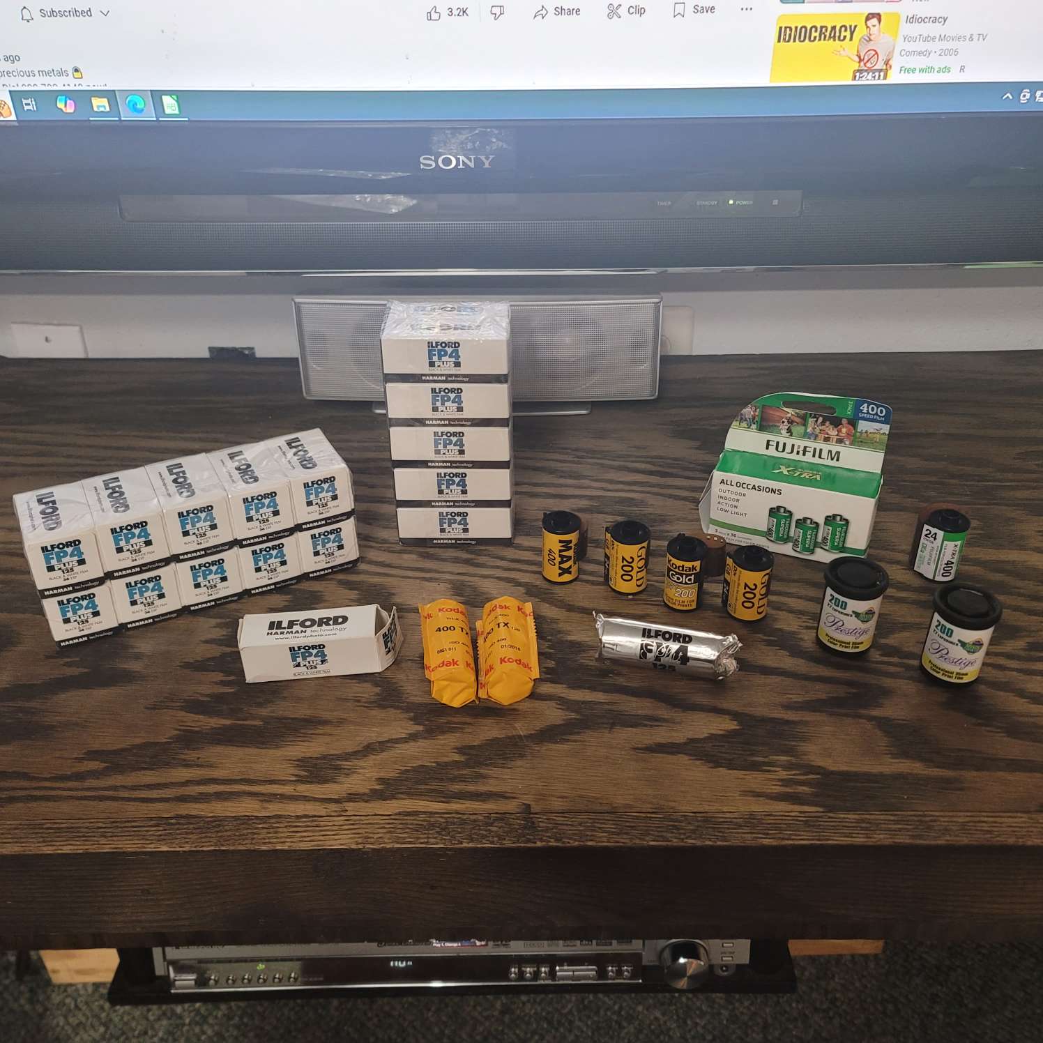

Lately theres been scuttlebut about the future of film and its availability. I havent shot film for probably 5 or 10 years. I bought a bunch of it a while back and kept it in the freezer. Due to more important family matters I took a break from photography but now I would like to get back into it. It seems I have more film than I thought. My goal of shooting 1 roll per month with a different camera (I have 12) each month may be more realistic than I thought without buying any more film (but maybe I should stock up now).
Anyway, heres what I found in the freezer.
Ilford FP4 Plus 125, 35mm, 36 exp., 10 rolls, Exp. Oct 2025
Ilford FP4 Plus 125, 120, 10 rolls, Exp. Oct 2022
Ilford FP4 Plus 125, 120, 2 rolls, Exp. Apr 2017
Kodak Tri-x-400, 120, 2 rolls, Exp. Jan 2016
Kodak Gold 200 24 exp 3 rolls, No date
Kodak Max 400 24 exp 1 roll, No date
Fuji Superia X-Tra 36 exp, 400, 4 rolls, Feb 2021

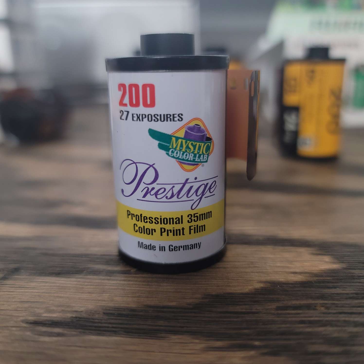

Prestige 200, 27 exp, color print, made in Germany, 2 rolls, No date
So in total I have 34 rolls of film. The Ilford expires Oct 2025. All of it is expired by 2 to 8 years except the FP4 35mm which has a year to go yet. Do you think it will cause me problems that it is expired? With this supply I could shoot for almost 3 years 1 roll per month. I wasnt sure if I should start a new thread or add it to my thread on the future of film.

I wouldnt worry about the FP4 at all. I doubt you will have any issue with the color films either. Slower films tend to hold up to age better in my experience than faster films.

I don't work in color at all...but you'll be good w the B&W film...keep it refrigerated until use.

As others have stated, there shouldn't be any problems. There may be a slight increase in the Tri-X's fog level - but not anything that anyone would take serious notice of.

Best use up the color film while it's within date, especially the 400 stuff.
You can fix the color stuff in digital post processing to an extent once it starts to go south.

The Superia 400 has been expired since jan 2021 so its too late now its probably no good for anything but abstract art or photo shop projects.

Nah, it'll still work and give presentable images. I'd try to use it up in the short term though. You may want to rate it at 200 just in case.

It will probably be fine, especially if it was frozen and protected from moisture.

Not very old and stored in the freezer. Color negative will usually look better with a +1 stop exposure even from fresh, so I'd do that. I'd rate the black and white as normal.
I have 2010 Tri-X that was not stored frozen and it's lost 1-1.5 stops of sensitivity. That's normal for 400 speed. 100 does better. Yours is frozen so you mostly just have the effect of cosmic rays, nothing too bad.
It's actually better that your color-negative films are consumer-grade as those are designed to last longer even without cold storage.

I would (a bit). My fp4, expiring in 2022, had been in the fridge since buying it new. but did not look good after development. Ilford replaced it.
