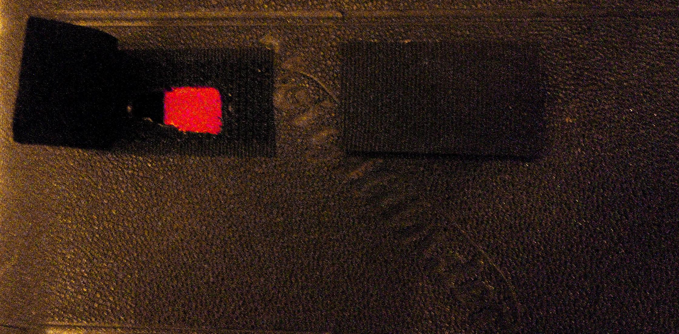

I modified mine with Velcro patches:
attachment.php
although I stick with the 6x9 for this camera.
