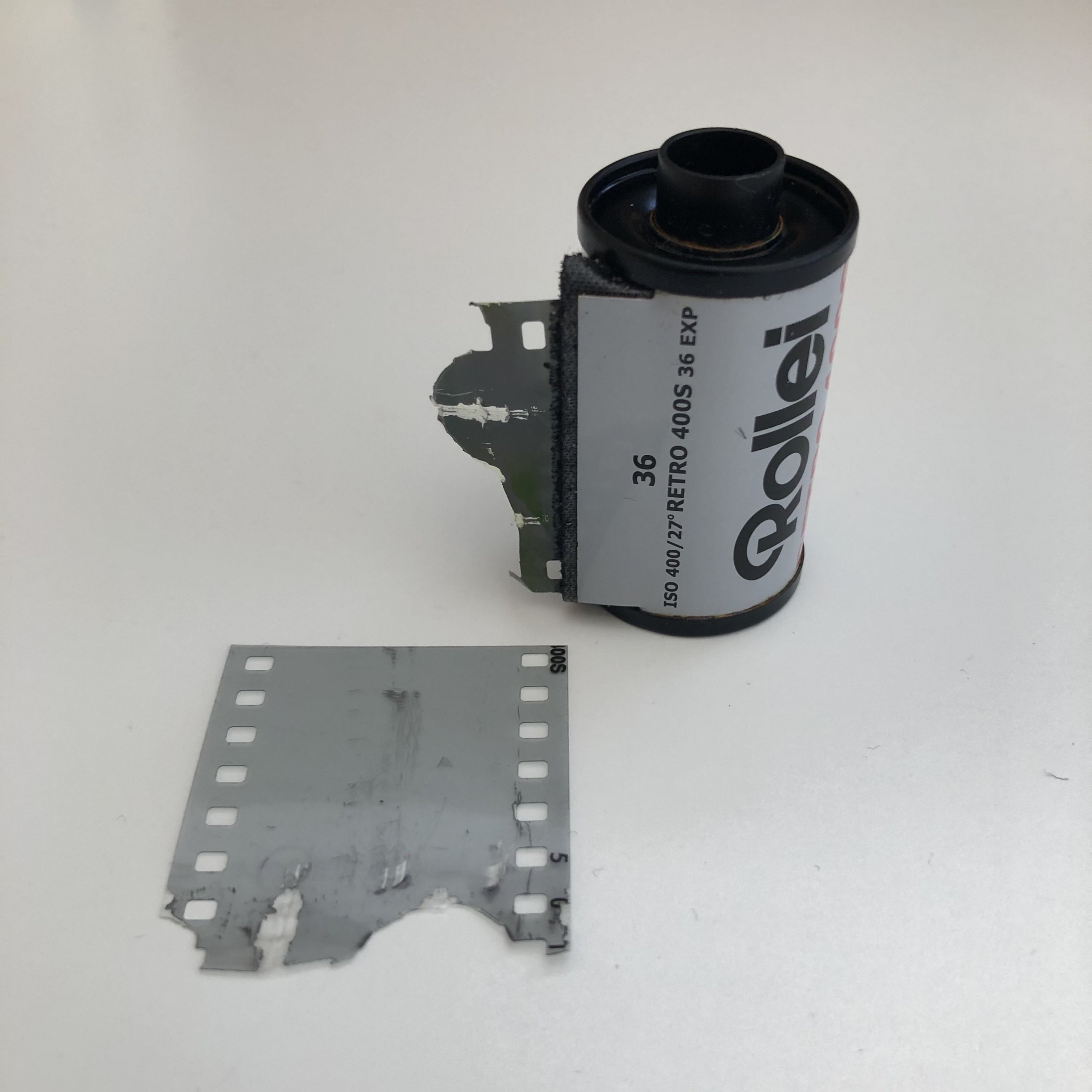

Thanks. It could be that mine Lab Box had a blunt bland for some reason but sharpening it fixed the issue and it now behaves like my Rondinax - slight tension on the knob and the film is cut in one stroke.
This was the film prior to sharpening the blade - mangled rather than cut. I had the same issue with the Fomapan, and Rollei

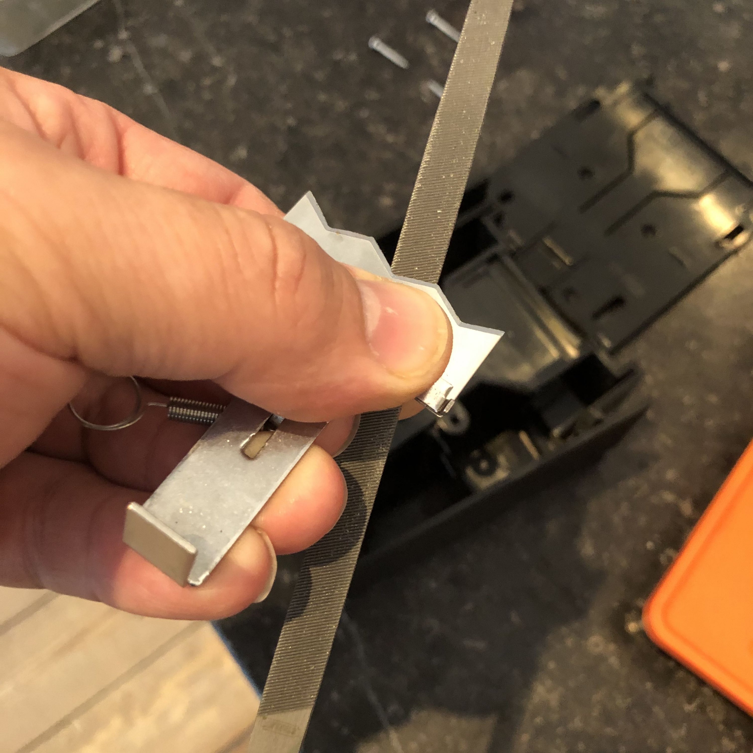

And this is the Fomapan after I sharpened the blade. The Fomapan is thicker than the Rollei, so I expect it will cut the Rollei OK.

I assume the better cut still is serrated as the knive already is serrated as hinted at in some post above.
Correct, I sharpened it by filing both sides of the blade until it was sharp to touch. Originally it was only sharpened on one side
