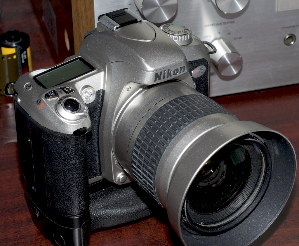

I'm currently working with what looks like a never-used Nikon N75 that shows this error.
What happens is the camera will frequently stop the lens all the way down, both during an exposure and when pressing the DOF preview button. The camera actually detects that something went wrong and throws the 'Err' message.
In this case the camera does not lock up. The 'Err' message clears after the next exposure.

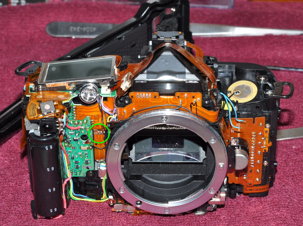

I decided to give this another try. I was going to take the aperture unit out and see if I could repair it.
I started disassembling the camera per the service manual. There is something lurking at the green circle in this picture, but I don't know it yet.
**NOTE** soon after taking that remaining cover off, discharge the flash capacitor (per the manual). My capacitor measured 272v before I discharged it.

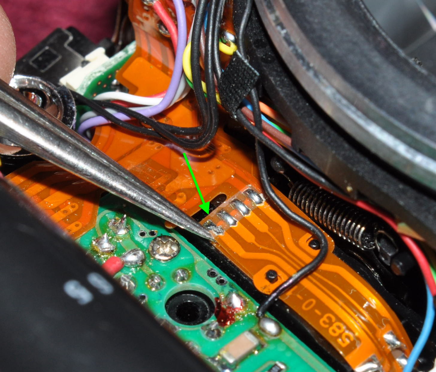

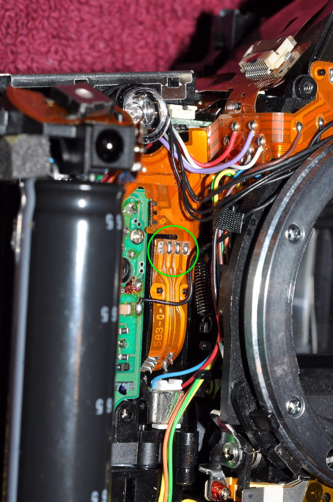

I actually had the top off and was preparing to disassemble the front and back. Over 50 solder connections. Then I noticed the cold solder joint at the green circle. Indeed that is a connection to the 'faulty' aperture control unit!!
ic-racer
ic-racer
Feb 25, 2007
16,480
USA
It was making slight connection, but I was able to lift it up. So this explains why if I had the camera in a certain position or if it hit it it would sometimes work.

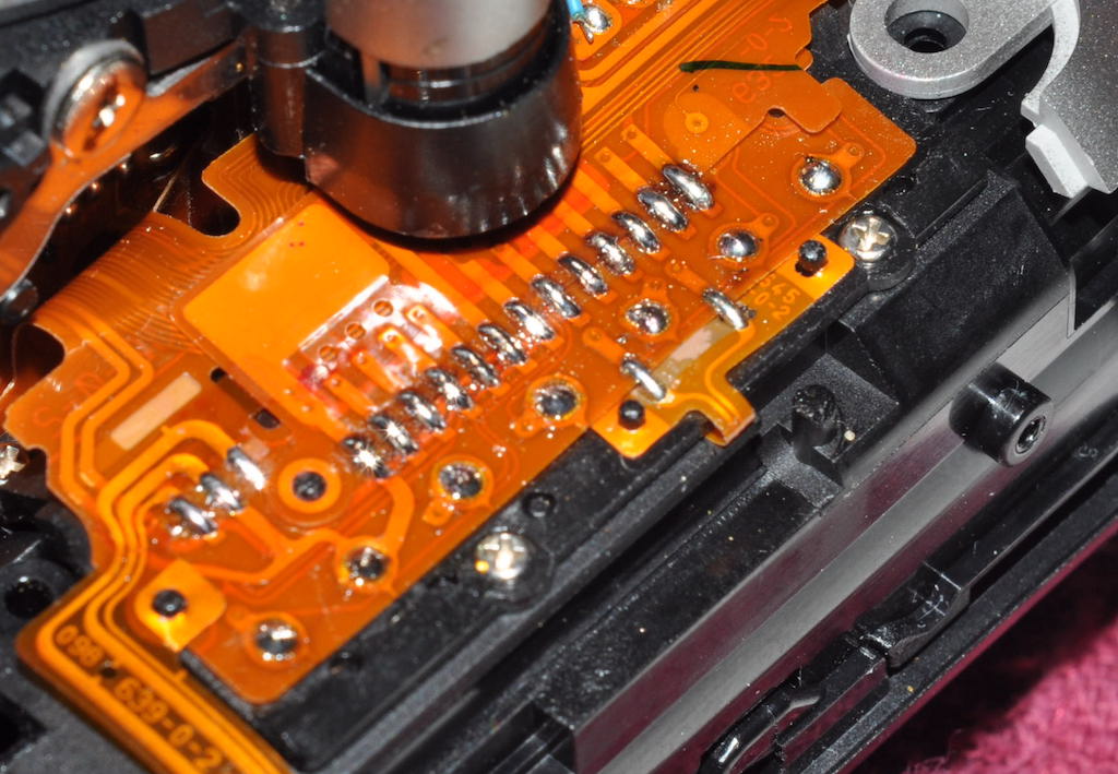

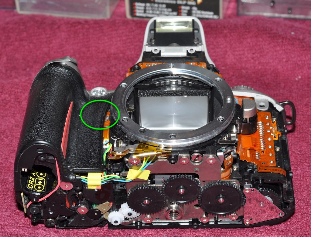

Now I had to go back and re-solder all the connections I broke to separate the halves of the camera (that I did not need to do).
