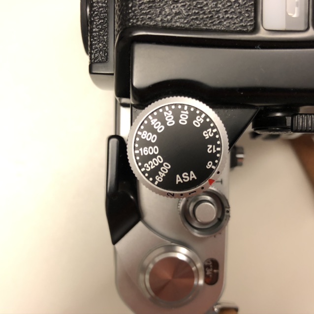

Can the F2AS cameras that have ISO 6 indicated also be set with +1 EC? Via the ISO dial? So they would read ISO 3?
I can see that on my F2 (with the DP-1) with a minimum ASA setting of 6 printed on the dial, it can be moved to the ASA 3 position.
Nitroplait
Jul 13, 2020
775
Europe (EU)
Sorry, I just noticed that it is half a stop i.e. 4.5 ASA:
