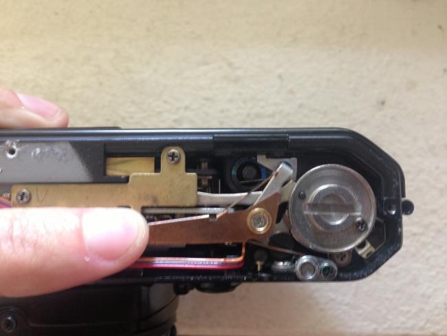

Many moons later I was able to fix, but now need to buy the bottom plate & a few screws.
