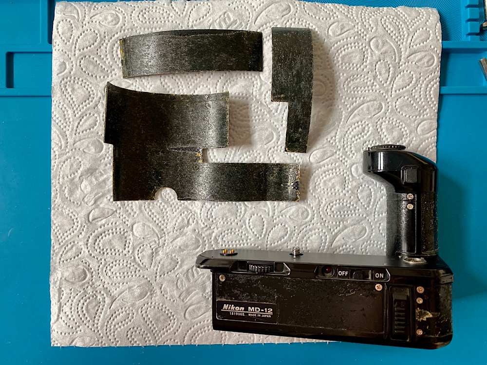

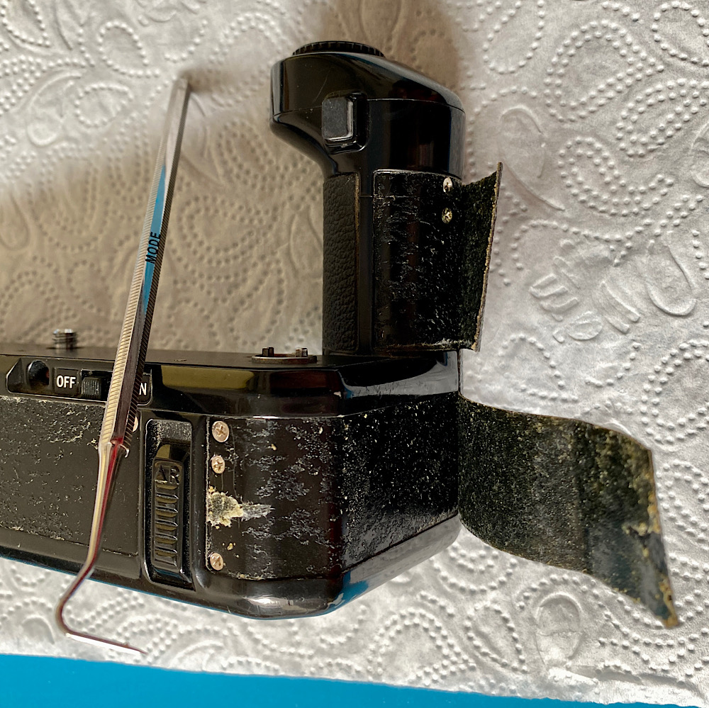

To access the screws that hold the MD-12 together, the leatherette must be removed.
Simply lift carefully at one end with the probe and then slowly pull it off.

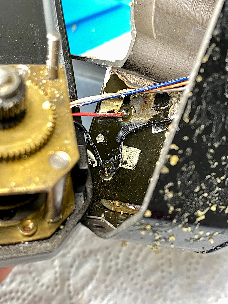

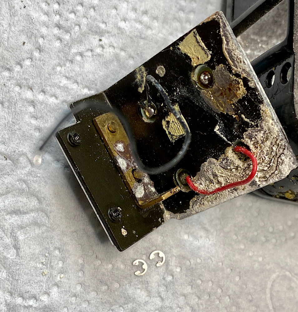

It took me some time before I could remove the battery compartment under the motor control gear. Something wouldn't let go.
The two cables that lead from the battery contacts to the motor are tight. They resist:
In order to be able to fold out the battery compartment, I unsoldered both cables.
Other cables allowed more freedom of movement. I also unsoldered these because I wanted to leave the battery compartment free for a thorough cleaning.

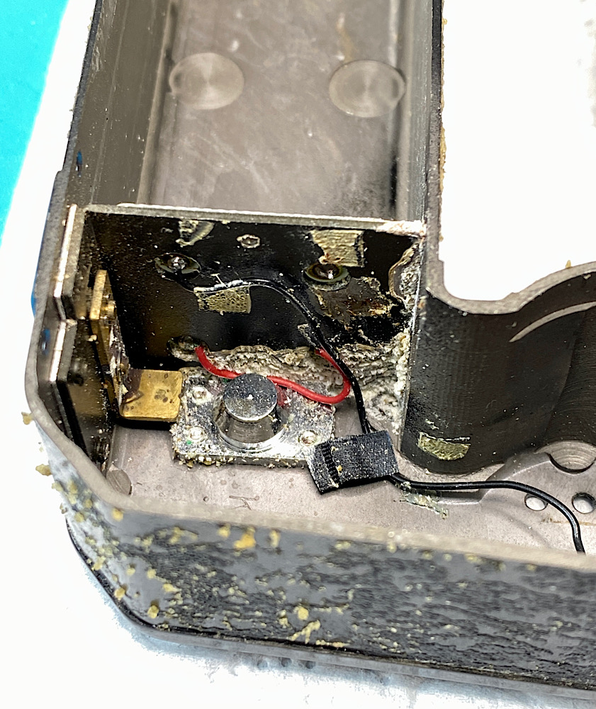

And that was required:
Another example of how batteries can take revenge over the years if you forget them in the device 🥶

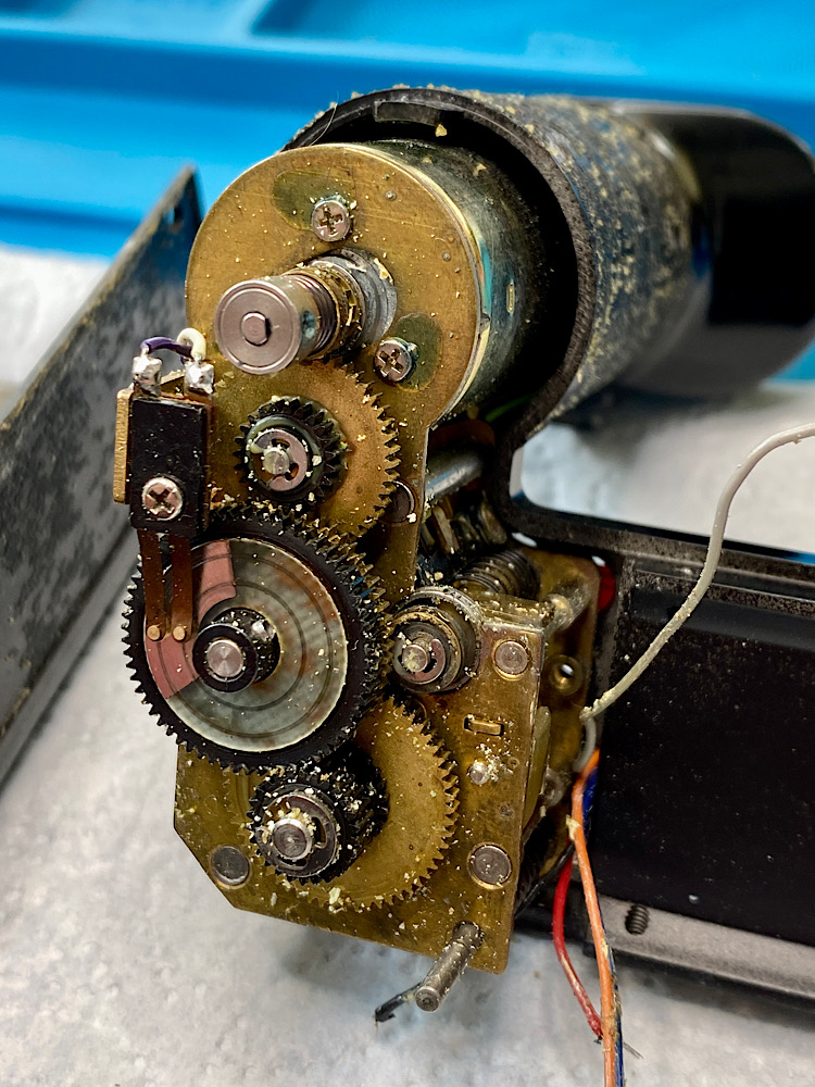

The motor control gear looked better.
Some dirt on the outside and on the gears which I removed. But otherwise the MD-12 is still good at lubrication:

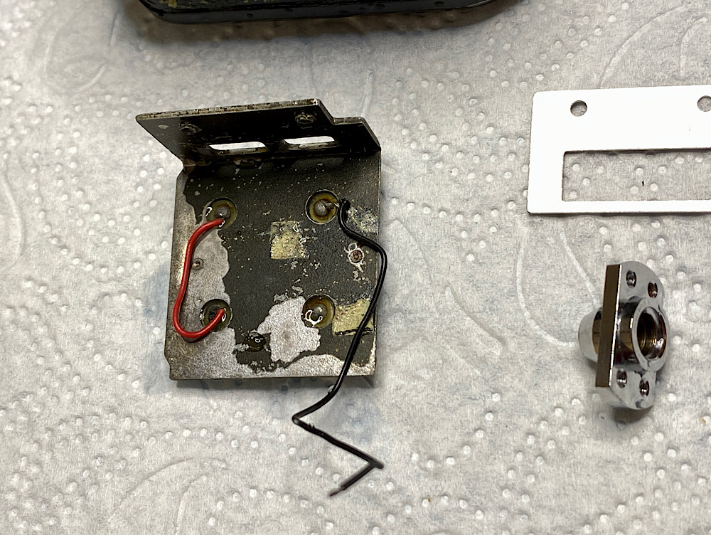

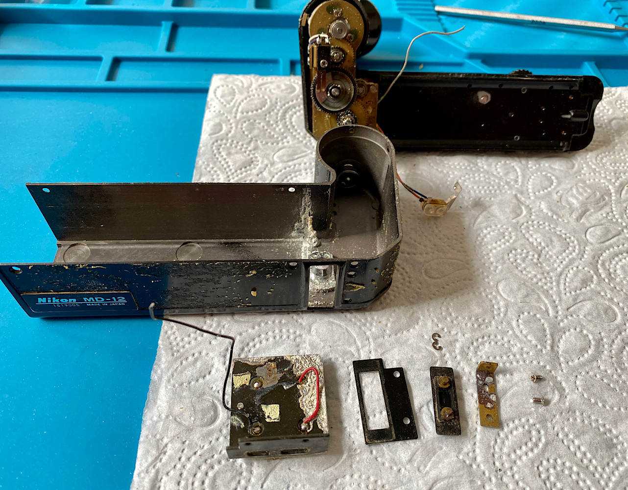

The battery compartment dismantled:
Close-up of horror:

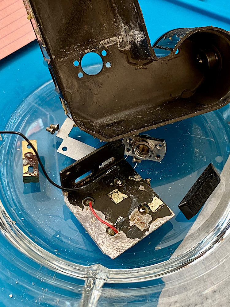

All parts were soaked in Durgol Universal descaler solution diluted with water for 40 minutes.
My best tip against battery acid residues:

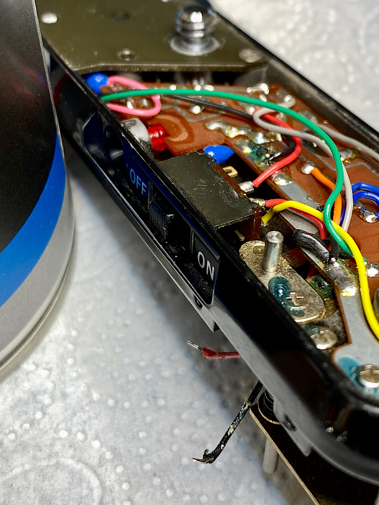

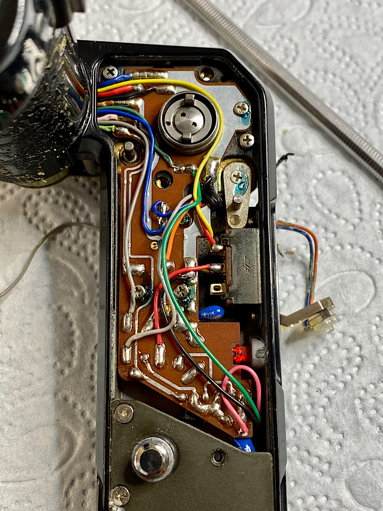

A look at the clean board:
The ON/OFF switch was stiff.
A dose of electronics cleaner, sprayed directly onto the built-in contacts of the slide switch, changed that:

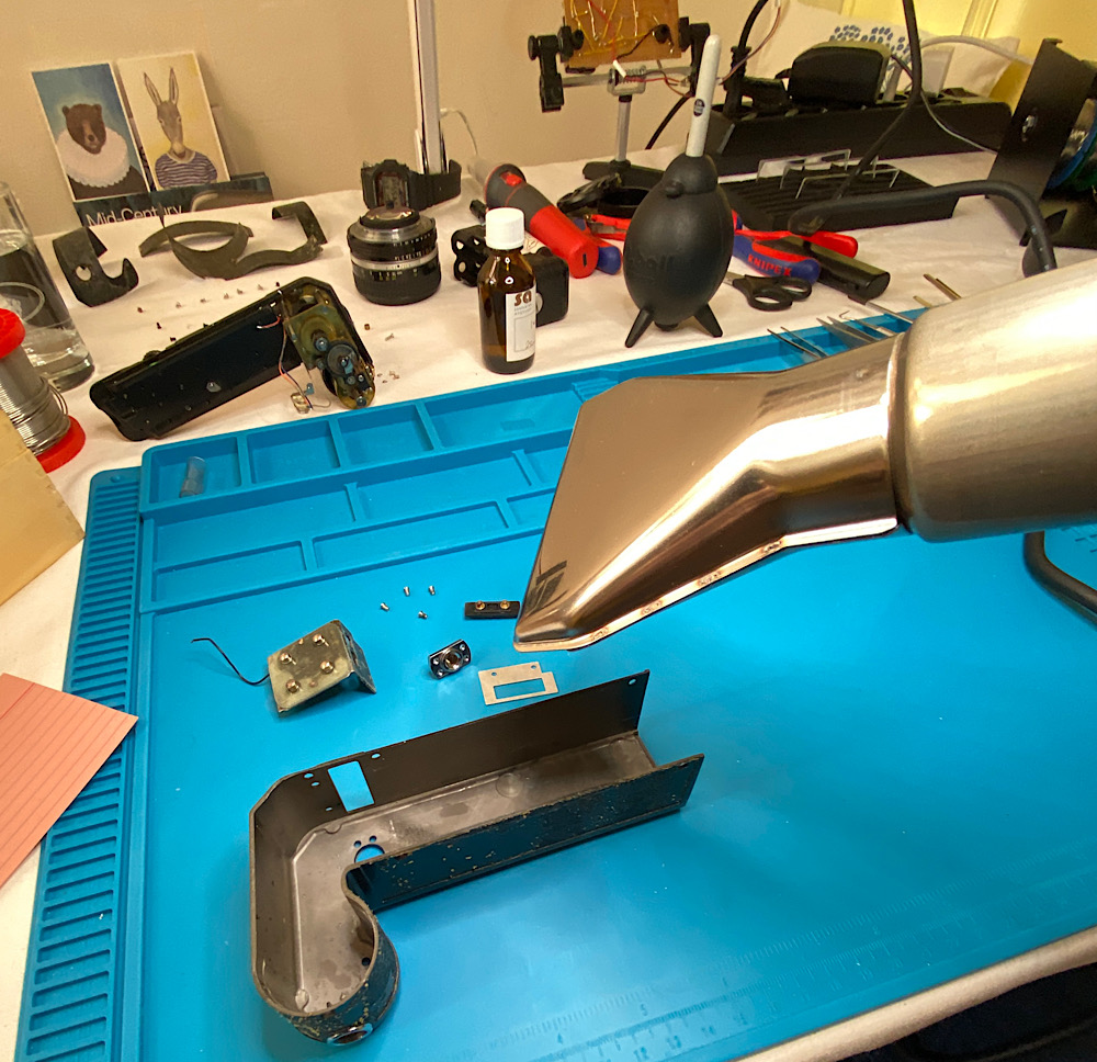

Meanwhile, bathing time in Durgol was over.
Rinse with water, dry:
Drying is quicker with a hot air blower:

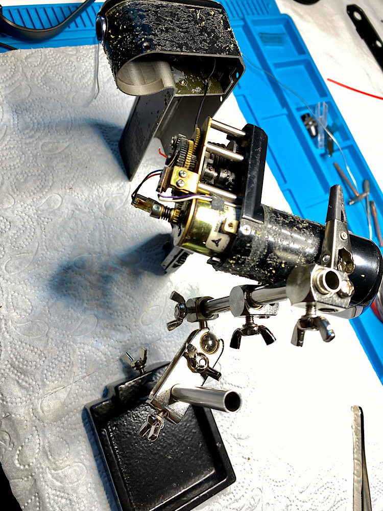

And now the hard part of the work began.

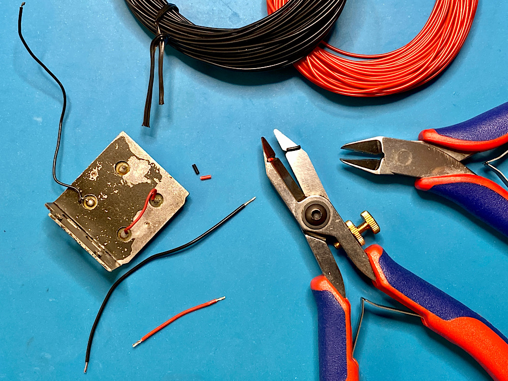

In order to be able to reassemble the motor, all cables must first be soldered back on.
Since the wiring is very tight, I extended the cables and replaced the soldering points.
It took several tries before I was happy with the result.
  • Insulation scorched by the soldering tip,
  • disconnected cables,
  • short circuit in the battery compartment due to solder bridge causing hot batteries,
  • ugly solder points that would haunt me into my dreams if I didn't redo them
and other adversities had to be encountered.

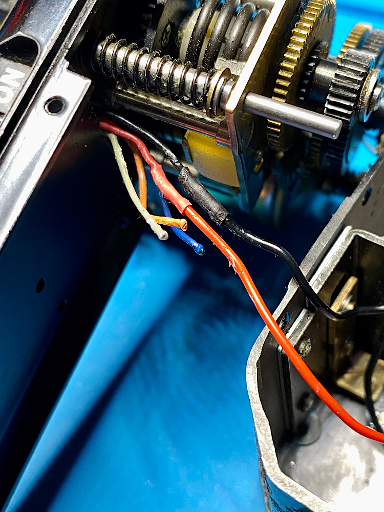

Slowly the MD-12 came to life
I was also able to solve the problem that the motor started rattling after I switched it on without me having pressed the shutter button.
And I solved the problem in a brutal way. 😎
The switch behind the plug contact on the motor handle was responsible for the incorrect switching.
I couldn't figure out how or why. Not even how the switch switched.
So I cut its wiring.
When I then put the ground cable to the plug contact back in place, the MD-12 was back in sync.
Doing this I sacrificed some of the functionality of the motor drive.
But it worked again.
Since the owner doesn't want to use the motor drive for photography, but instead wants to look at it in the display case, I was able to take responsibility for that.
Of course that's not ideal 😳

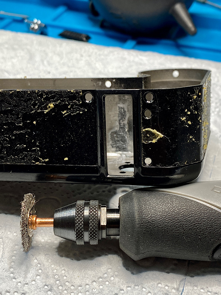

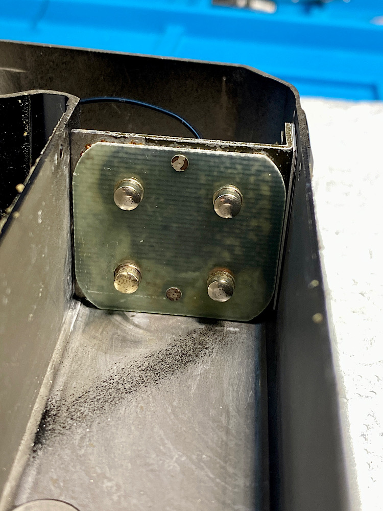

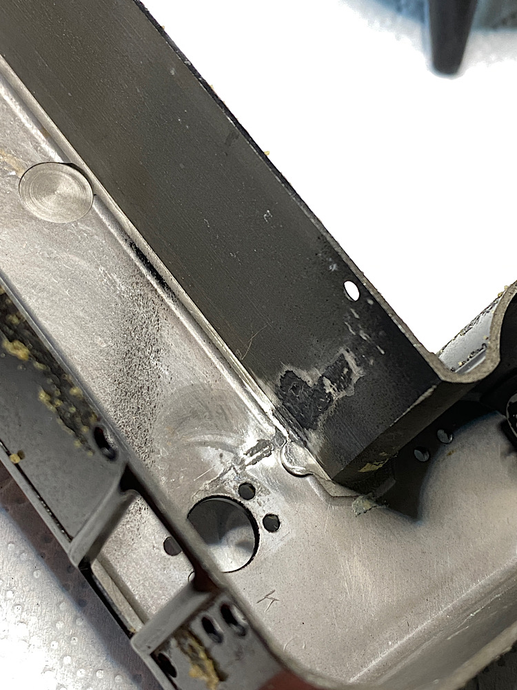

The Dremel Stylo removed stubborn corrosion residues:
The plate with the four battery contacts in the battery compartment.
I couldn't remove the acid residue under the plate because it is riveted:
A special kind of "soldering bridge" 😉
However, there was no other way I could get a certain cable into position for soldering:

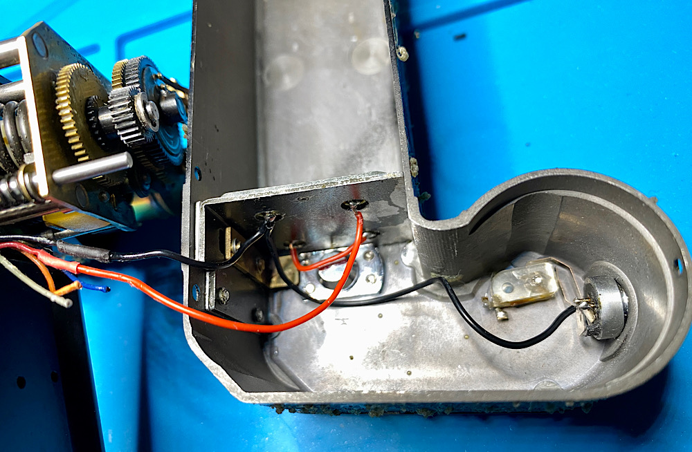

The new order in the cable world of the MD-12:
I sealed the ends of the cut cables with Loctite to prevent them from conducting.

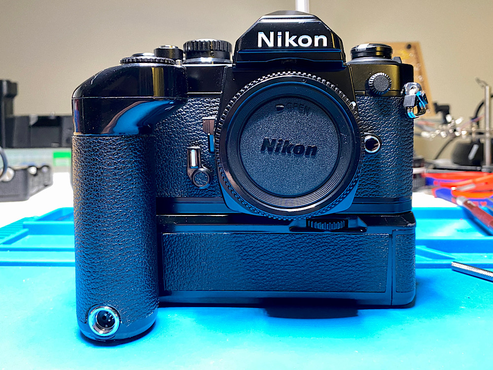

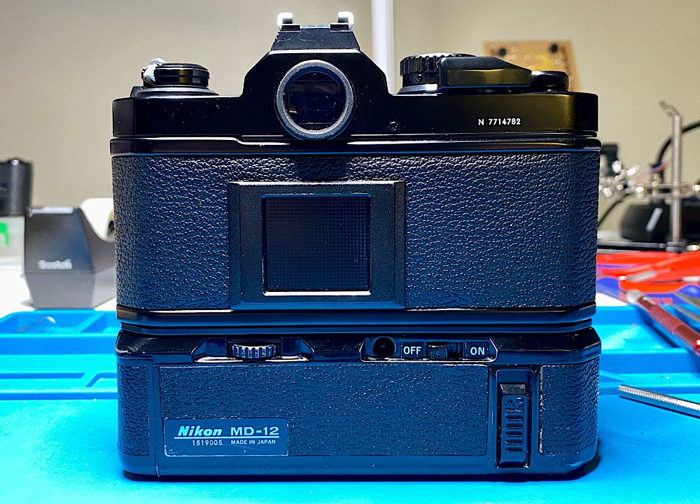

And there he is again, the MD-12, with his new friend FM2n, also cleaned on the outside and ready for work:
As always, the table had become too small after a day's work:
