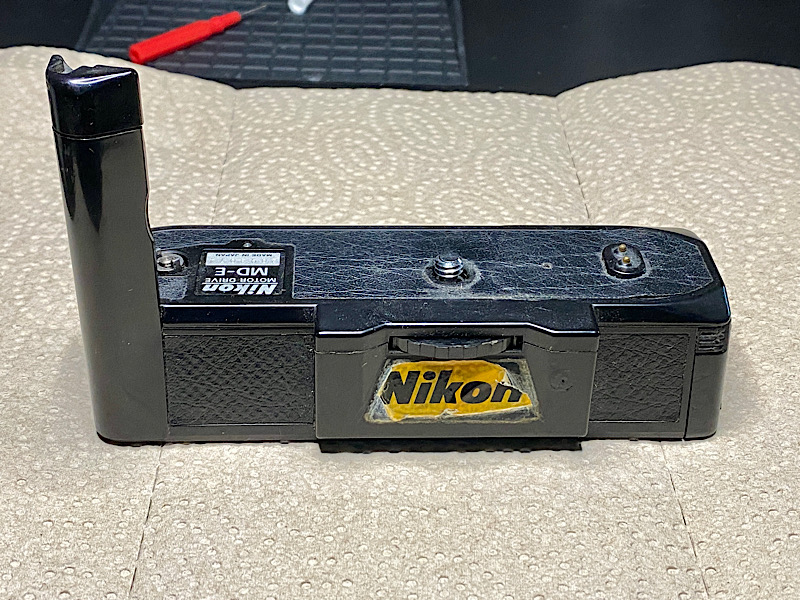

After taking care of my well-used and dirty Nikon EM
today I'm taking a look at the corresponding winder MD-E.
In a quick first test at the EM the winder doesn't work.
So let's take a closer look at it.

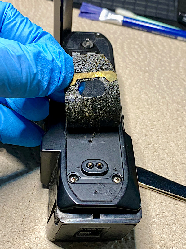

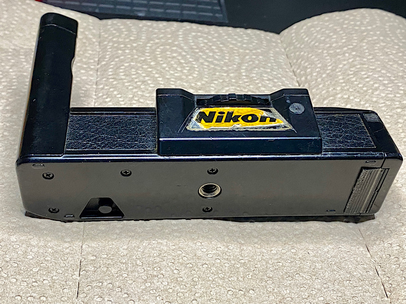

The winder has obviously been used a lot and needs cleaning. The Nikon sticker was probably applied by the previous owner.
There is no corrosion in the battery compartment caused by leaked battery electrolyte.
This is good because the aggressive stuff spreads further through the cables to the circuit board and can cause damage there.
The contacts and springs must be cleaned in any case, as there is a coating on them.

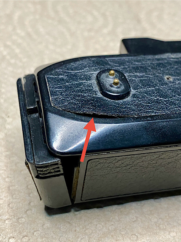

The leatherette is also a candidate for cleaning. It is already peeling off a bit.

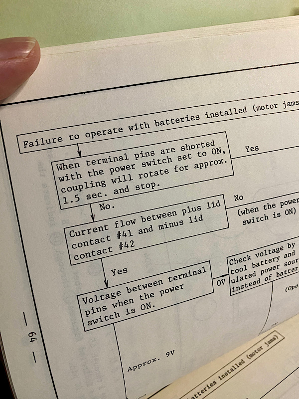

After treating the battery contacts with electronic cleaner, I put in the batteries and tested the motor function by short-circuiting the two contacts to the camera.
Since they were no longer shiny either, I polished them with the hard rubber attachment on the Dremel Stylo.
The instructions for this test can be found in the Nikon Service Manual for the MD-E, which I have in the original edition.
The motor should now start, but it doesn't move.

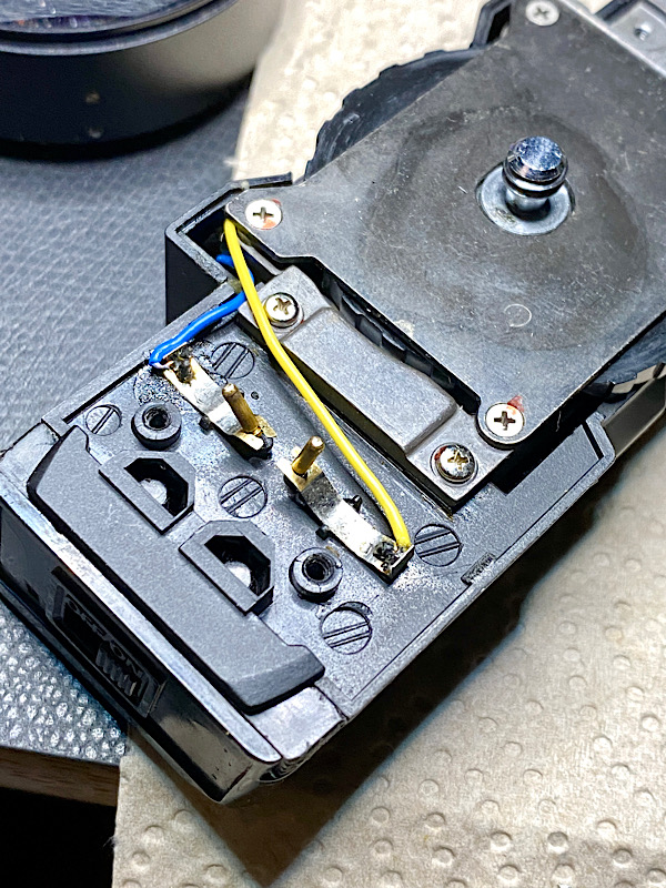

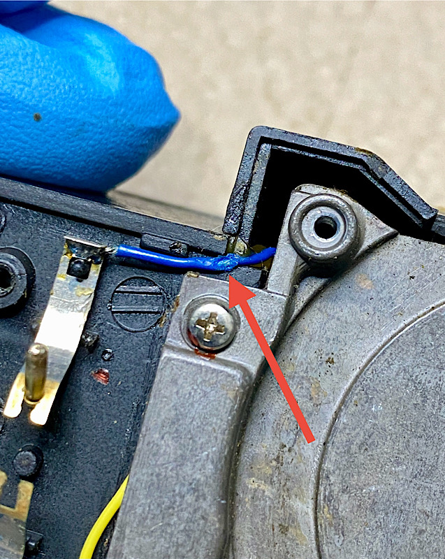

One of the cables to the two connection contacts is squished. This obviously happened during a previous assembly.

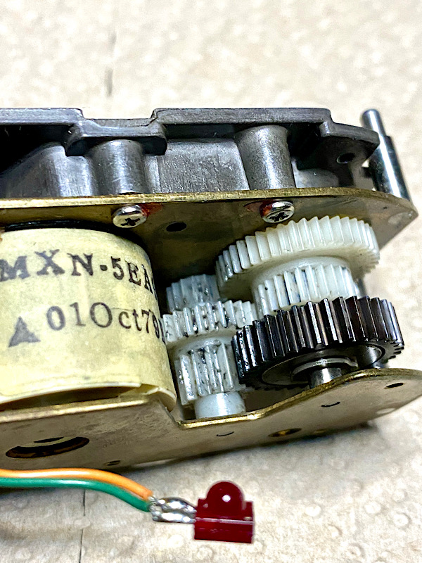

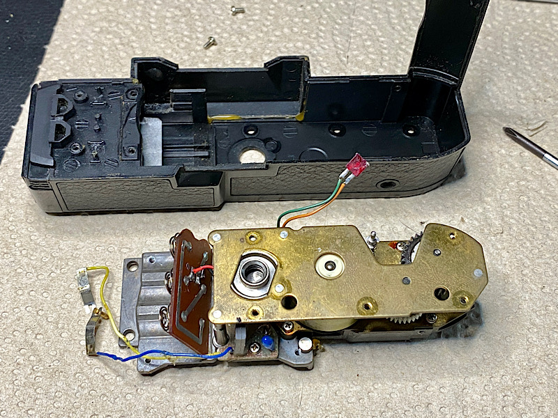

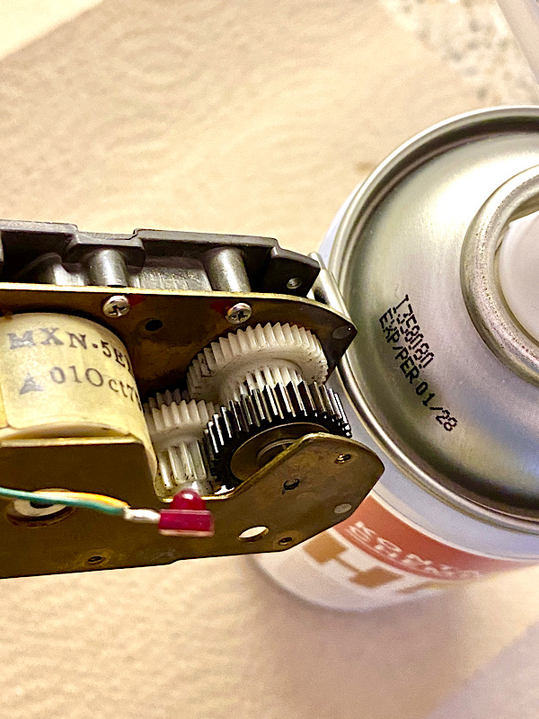

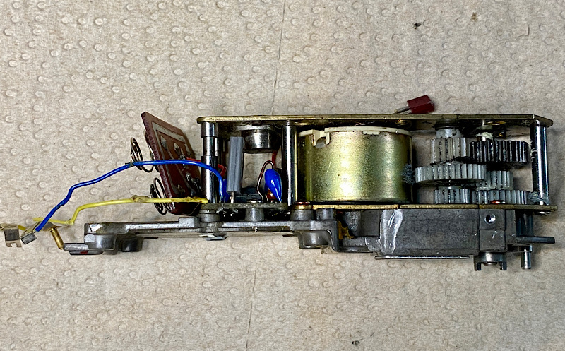

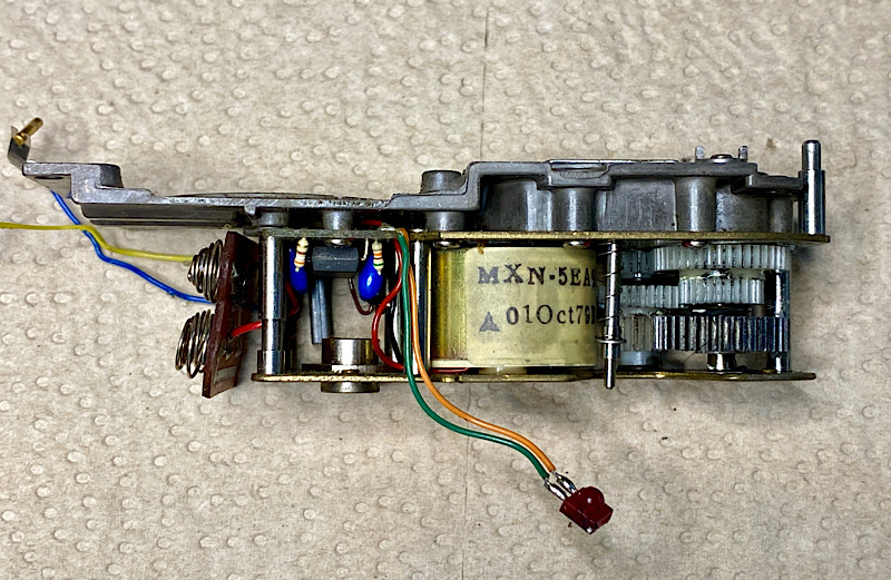

Removal of the motor with gearbox and circuit board.

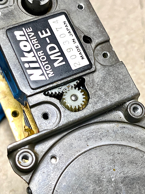

According to the imprint, the motor was manufactured on October 1, 1979.
The gearbox lubrication is used up. I will replace it.

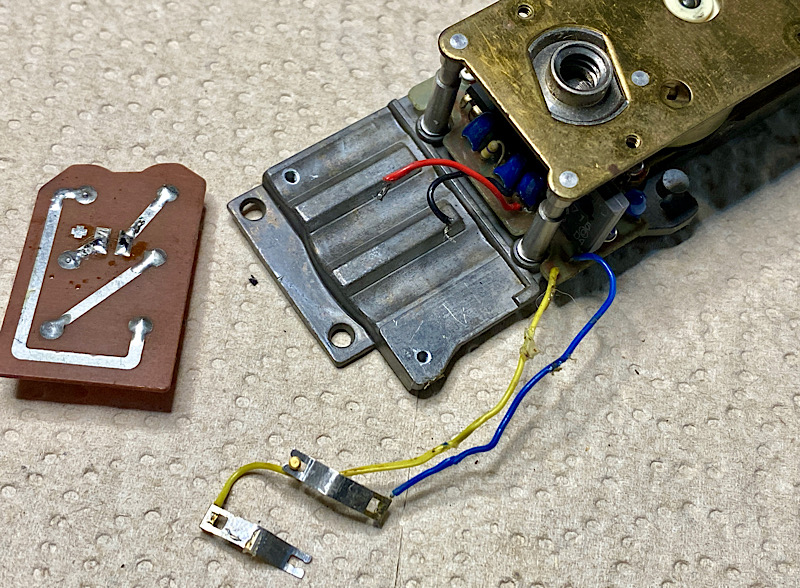

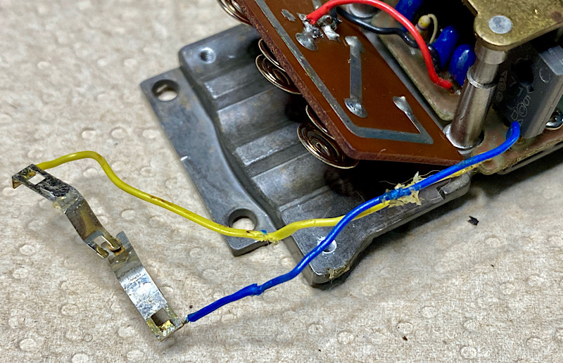

Here is the back of the plate with the springs for the battery compartment and the red and black cables for the power supply.
And here are the connectors for the contacts to the camera, which I had previously short-circuited for testing purposes.
Now I can clean the springs thoroughly with the hard rubber attachment on the Dremel Stylo.
The contacts on the battery compartment cover also get this treatment.
I use the multimeter to check the continuity of the two cables. The yellow one also shows pinching.
The continuity is OK, ie the cables are conducting.
Nevertheless, I will replace them, as small damages in the insulation can divert current towards ground, which can affect the function of the circuit.
To narrow down the problem, I unsolder the plate with the springs so that I can connect the motor directly to my laboratory power supply.
If the motor and the associated electronics on the board now work, I need to continue looking in the battery compartment for the cause of the problem.
The motor is connected to a 9 volt operating voltage.
By short-circuiting the two contacts, it comes to life, rotates and the red control LED lights up.
I am relieved because further troubleshooting in the battery compartment is much easier than having to search in the circuit.

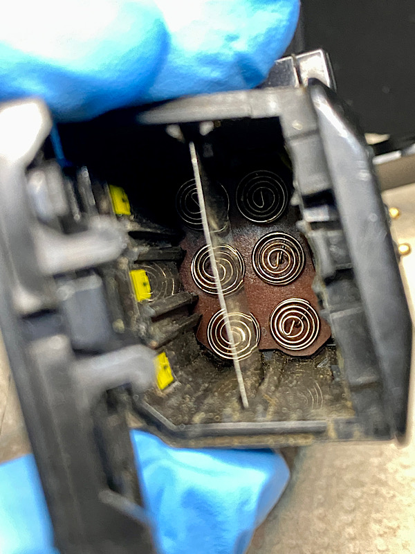

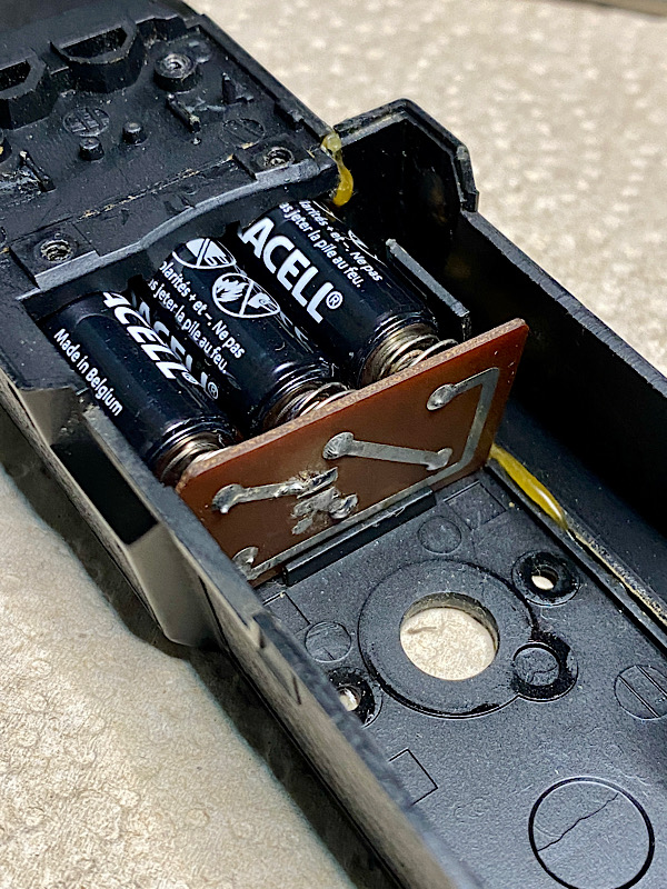

Next, we look at the battery compartment and its battery connections.

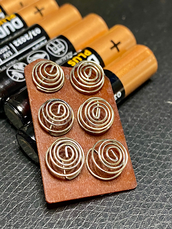

I put the batteries in and measure only 2.7 volts at the compartment's output instead of 9 volts. So this is where the error lies.

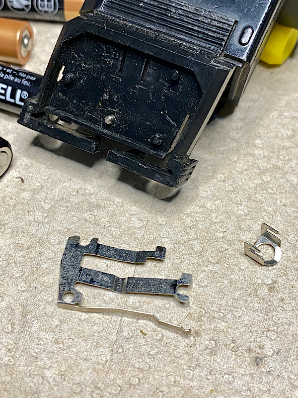

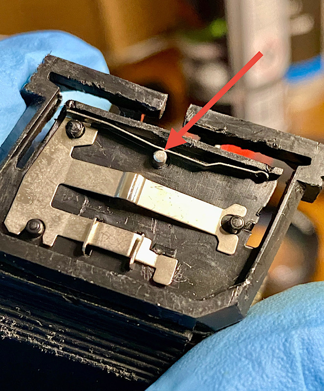

I disassemble the battery compartment cover to check the mechanism of the on/off switch and clean all parts with electronic cleaner.
Here too, I measure the continuity with the multimeter and find that no current is flowing through the ON/OFF contact point.
The cause is a stubborn coating, which I remove with the fiberglass brush.
Now the 9 volts are present at the output of the battery compartment.
This should have solved the problem and the winder should work again.

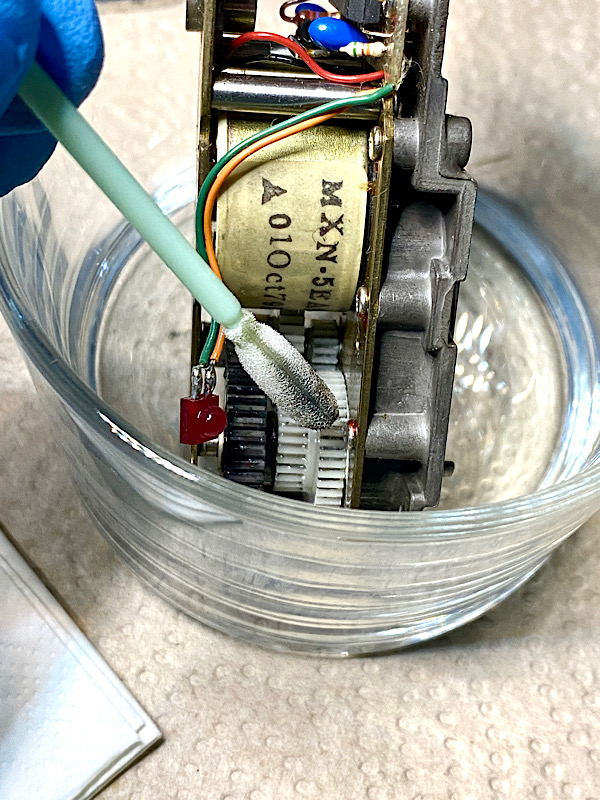

Cleaning/lubricating the gearbox

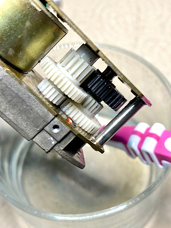

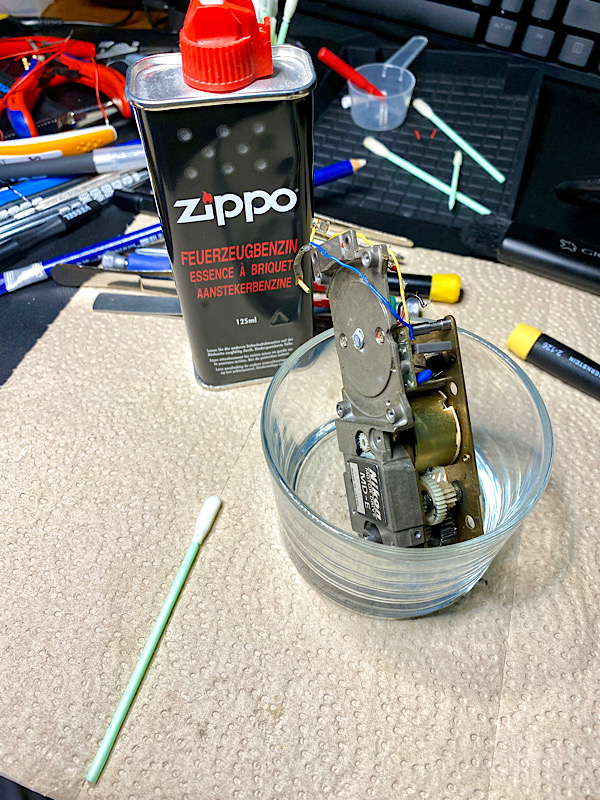

A bath in Zippo lighter fluid to remove the old grease.
I recommend wearing a protective mask for this type of work, as the petrol fumes should not be inhaled.
Please also remember that petrol is highly flammable.
Clean
Remaining Zippo grease mixture is blown away with high-pressure air.
The result.
I only lightly grease the first gears, as the lubrication is distributed by the rotation of the gears.
I couldn't clean the gears here because I would have had to dismantle the housing to do so. But there is still lubrication that I can distribute.
The housing is now cleaned - done.

New wiring
Old cables.
The new cables to the camera contacts and the battery compartment plate with the springs are soldered.

According to the service manual, the motor should only run for 1.5 seconds after short-circuiting the two camera contacts. Here the motor runs continuously. Perhaps that is why a high-frequency noise can be heard when the shutter is released.
I'll look in the service manual to see if I can find any information about it.

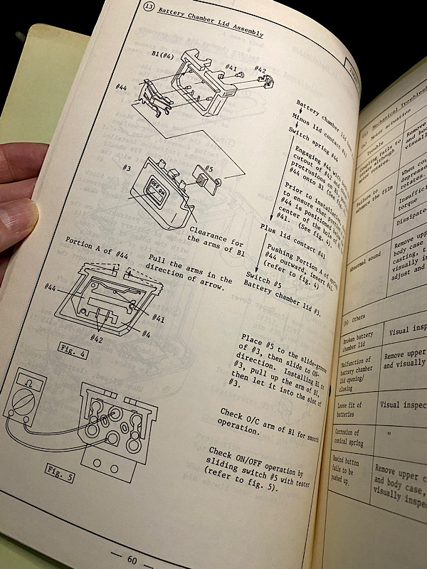

Here is further information in the service manual on the structure and function of the main switch in the battery compartment cover.
The figure at the bottom shows the ON/OFF contact.
If it is open, the multimeter shows high resistance; if it is closed, it shows low resistance (current does not flow or current flows).
This function can be checked with the continuity tester on the multimeter, which is what I did.

Cleaning and lubricating plastic gears is a tricky thing.
I used lighter fluid and Moly Lube, both of which are more commonly used for metals.
The alternatives would be isopropyl alcohol and silicone grease, but I don't have the latter in my supply.
From everything I've read, lighter fluid and Moly shouldn't attack plastic. Since it's not known what kind of plastic the gears are made of (nylon?) and what their status will be after a lifespan of 45 years, it probably won't work without experimentation.
I will report back with my observations - in another 45 years 😉
