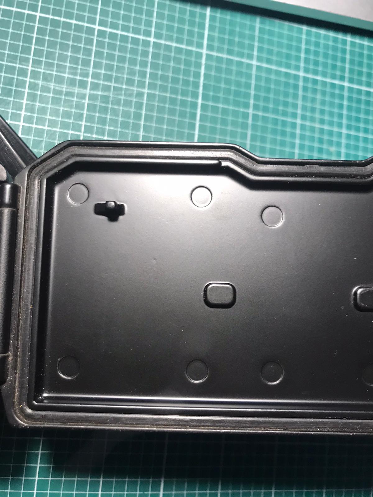

Thanks for the added advice. I have managed to source the larger door o-ring which is coming soon. So I have all the basic 4 o-rings now. The person I got the camera from said it was last used in the late 80s but wasn't submerged and was used for pipe inspections. What I thought was sand looks like it was just dust around the o-ring or maybe old grease residue? Pics below. I have looked at the Southern Nikonos method of removing the o-rings on this camera and it essentially says if you can't easily remove with your fingers its probably too flat and should be binned - but this is obviously in a diving context.
So my last question is should I not worry about it too much if its just for heavy weather / rain use and leave the existing ones in there but try and clean / grease without removal and save the new ones for a later stage. Or just bin the existing ones and put all the new ones straight in myself and maintain as I go even though I might struggle to get another set in the future. Cheers
