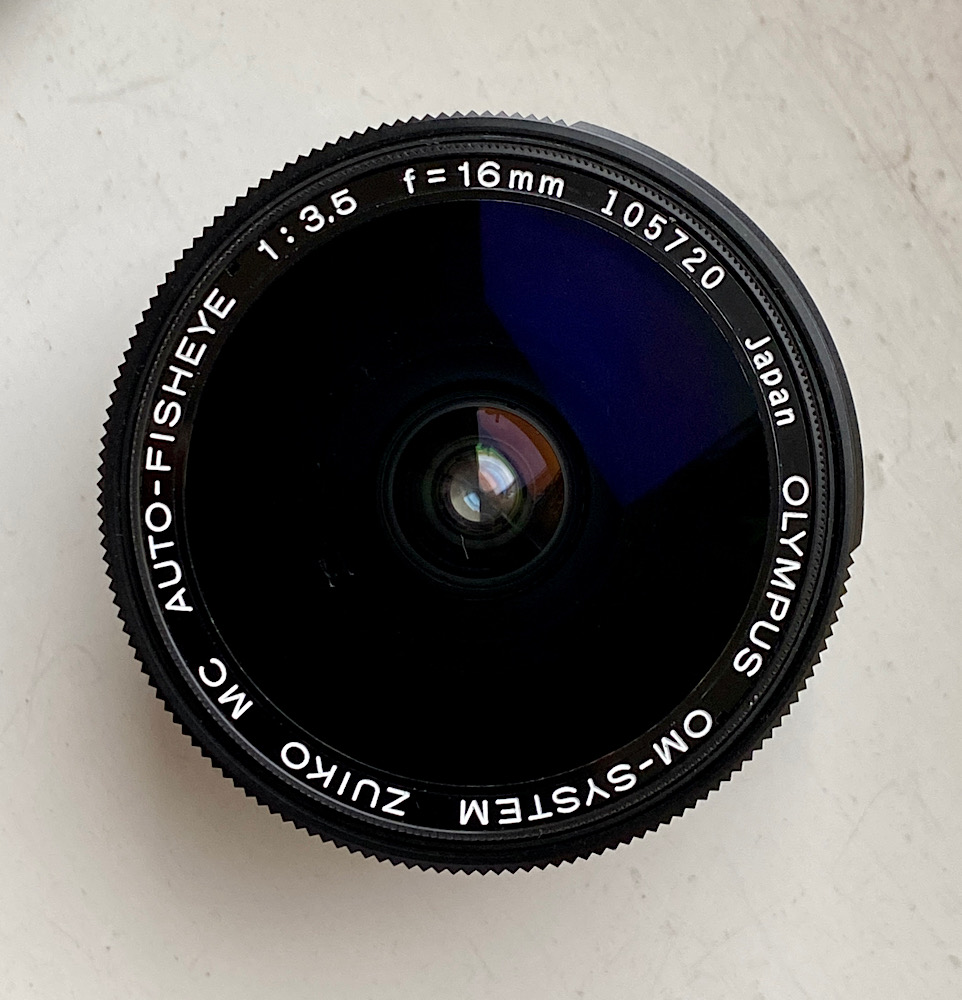

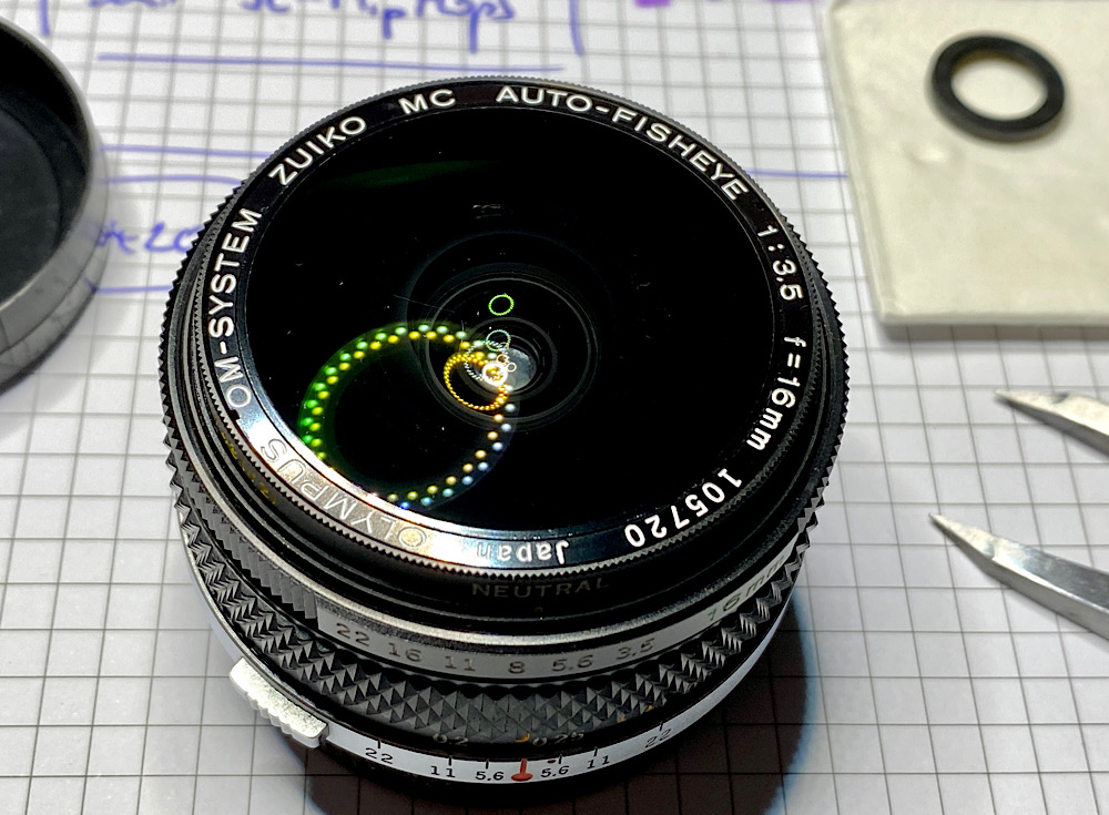

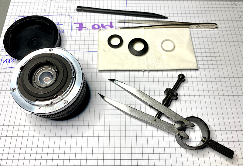

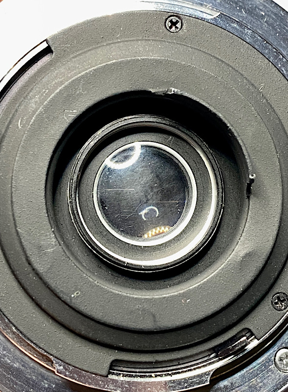

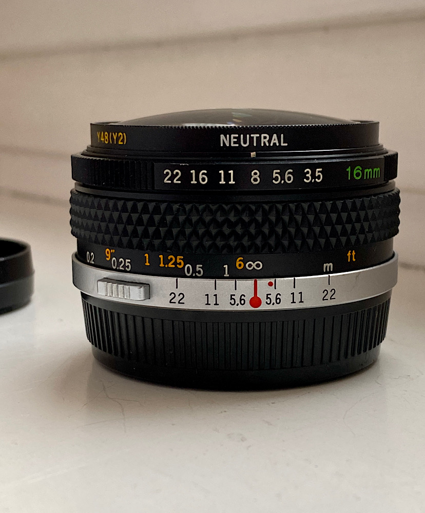

A rare fisheye in condition A, unfortunately with a damaged lens inside, namely the second element from the back.
Images shot with the lens were massively softened on the OM-4 Ti:
The damage was not on the lens surface, but underneath/in between.
I suspected a problem with the lens cementation:
Unfortunately, disassembling it didn't help, as I couldn't do anything else to repair the damage:
Professional help was needed
In Germany, the Optik-Labor is well known for its excellent and affordable services when it comes to lens repair.
New lens coatings, repair of lens separation, polishing, Dr.-Ing. Wolf-Dieter Prenzel and his team are doing amazing things.
For many users and collectors, the Optik-Labor is the last and at the same time the most promising hope 👍
Since it is recommended to call Dr. Prenzel directly, I explained my problem to him on the phone.
He asked me to send the lens to his partner
Fotoservice Olbrich, Andrea Schönfelder
who will remove the damaged lenses and assemble the lens after repair.

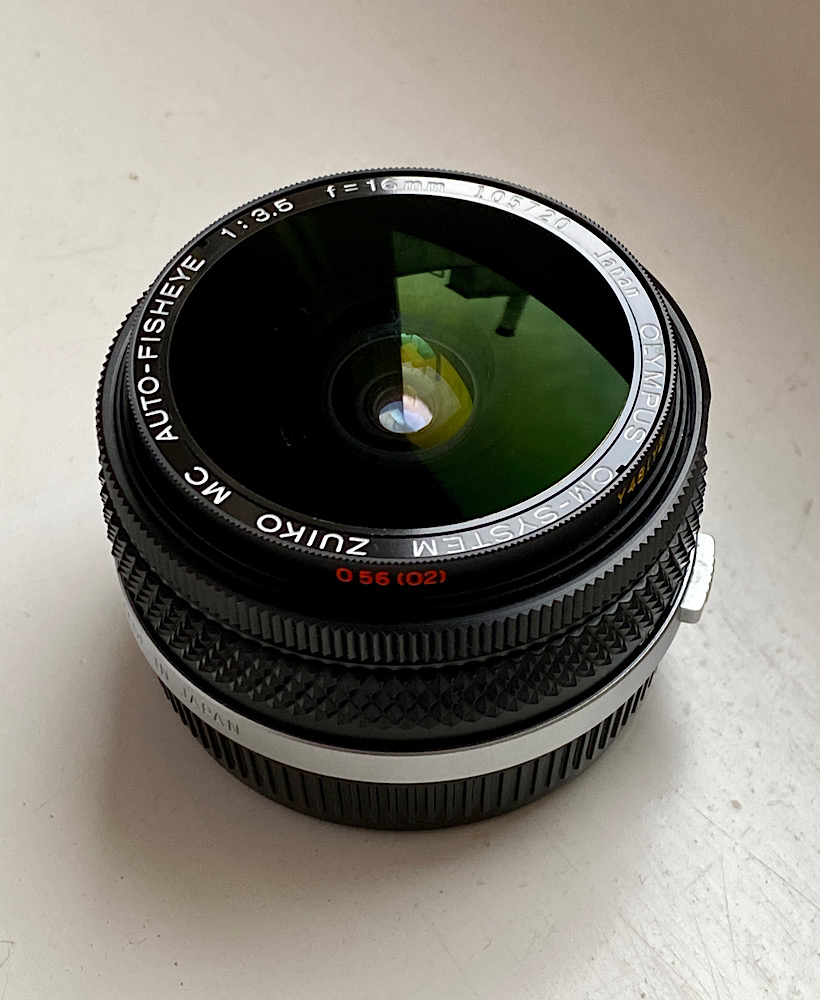

Dr. Prenzel and Andrea Schönfelder brought the piece optically back to new condition.
I am completely thrilled - nothing beats highly qualified specialist work!
In the optics laboratory were
  • a meniscus lens polished and coated on both sides as well
  • one cemented lens group separated,
  • three lens surfaces re-polished,
  • two lens surfaces tempered, lenses re-cemented and centered.
I would like to describe the price for this work as extremely fair.
The optical system is now “crystal clear” again and I’m looking forward to taking photos with it.

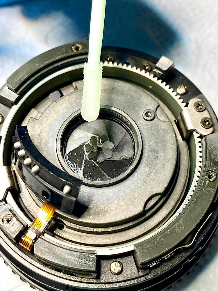

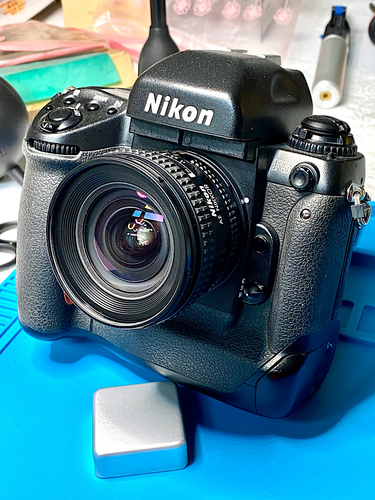

I cleaned the oily aperture blades on a Nikkor AF 20/2.8 D. But a lens group that is cemented is heavily fogged.
This will also be a case for the Optik-Labor 👍

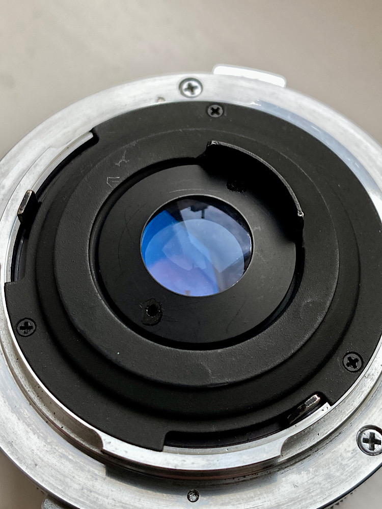

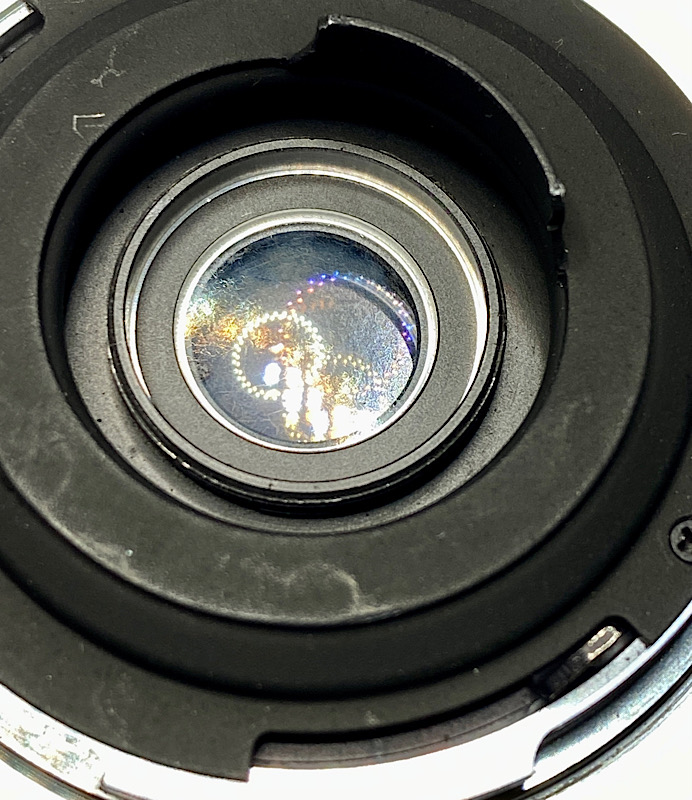

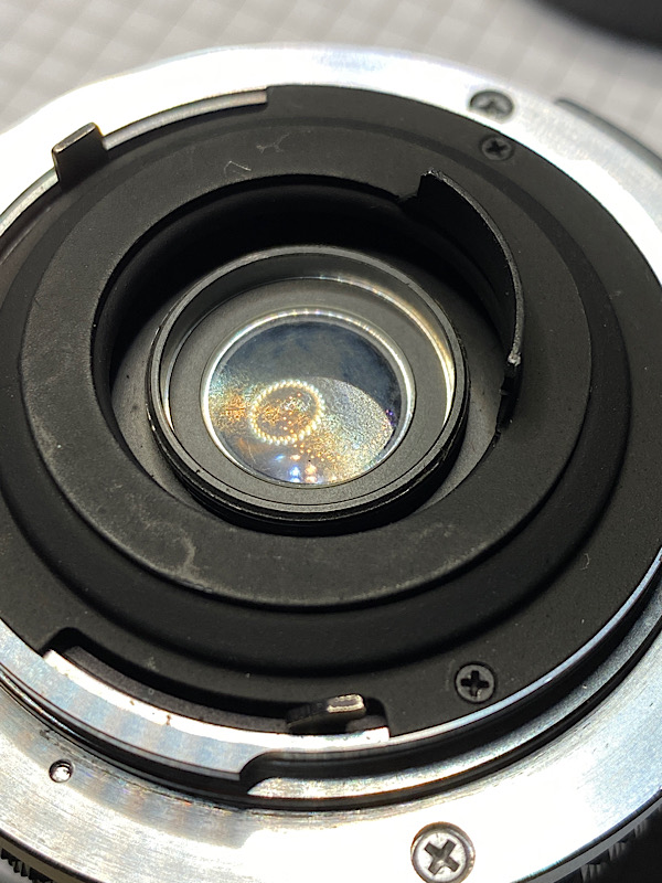

It can't be anything related to lens separation as the 135mm f2.8 lens doesn't use any cemented lens groups, it has five separate single lens elements according to this diagram http://omesif.moosemystic.net/om-sif/lensgroup/135mmf28.htm
It must be haze on the inner surface of the lens, whether it can be removed I don't know.
mmmmm, this diagram has given me some confident. If is fungus, doesnt look like have eaten the coating. Maybe is just condensation from some water accident or rainy day. I think I will send an offer to the seller and cut the price down.
Flighter
Mar 7, 2023
261
Scotland
It could also be outgassing from the lubricant used for the helicoid in the focus mechanism.
Flighter
Mar 7, 2023
261
Scotland
I don't know about whether it can be corrosive but I've come across lens elements in an old Olympusflex twin lens reflex which had haze on the surfaces of the two lens that were on each side of the shutter which I haven't been able to remove (I've tried isopropyl alcohol, acetone and naptha).
Andreas Thaler
Andreas Thaler
Nov 19, 2017
4,209
Vienna/Austria
That is my impression too. Fungus should not produce an evenly distributed haze, any structures should be visible then. But the pictures are not clear to me.
albada
Apr 10, 2008
2,175
Escondido, C
Retina IIa rangefinders with Xenon lenses often have haze on the two lens elements between the shutter. Nothing I've tried has removed it in any camera, so I believe it is coating damaged by humidity.
