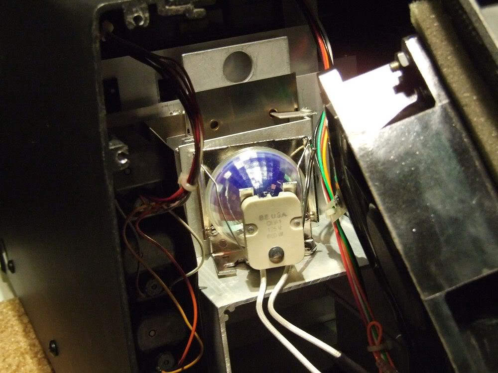

The socket is pretty easy to service. You can take off the back plate of the D5500 head. Some of the screws are sheet metal and some are machine screws. You can tell when one of these heads has been butchered when the threads are stripped when someone mixed up the screws. There are some cable ties that hold the inner wires away from the fan. I cut these then replaced them when I was finished. That gave a little more room to work.

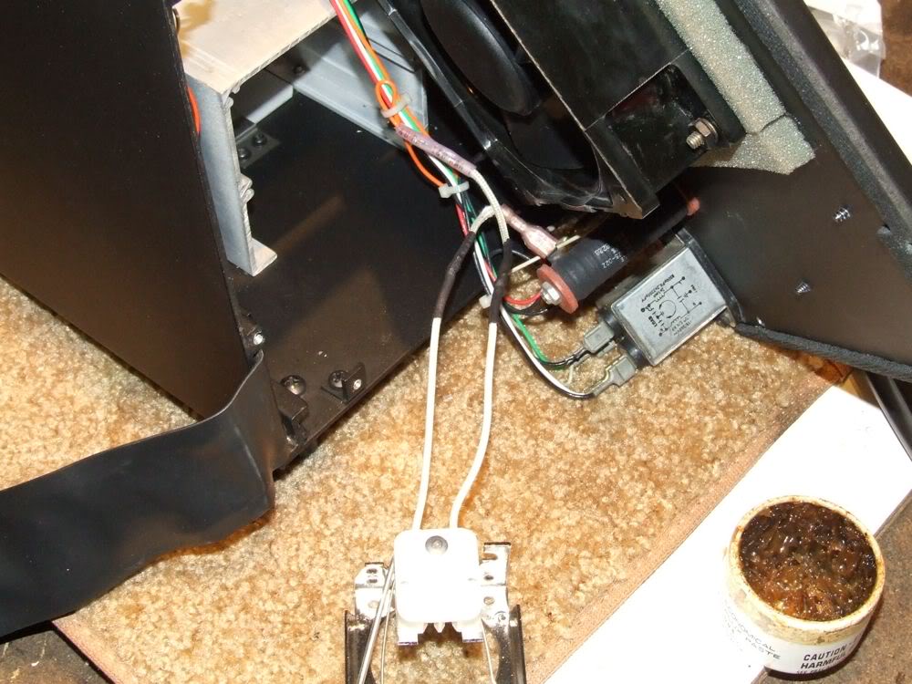

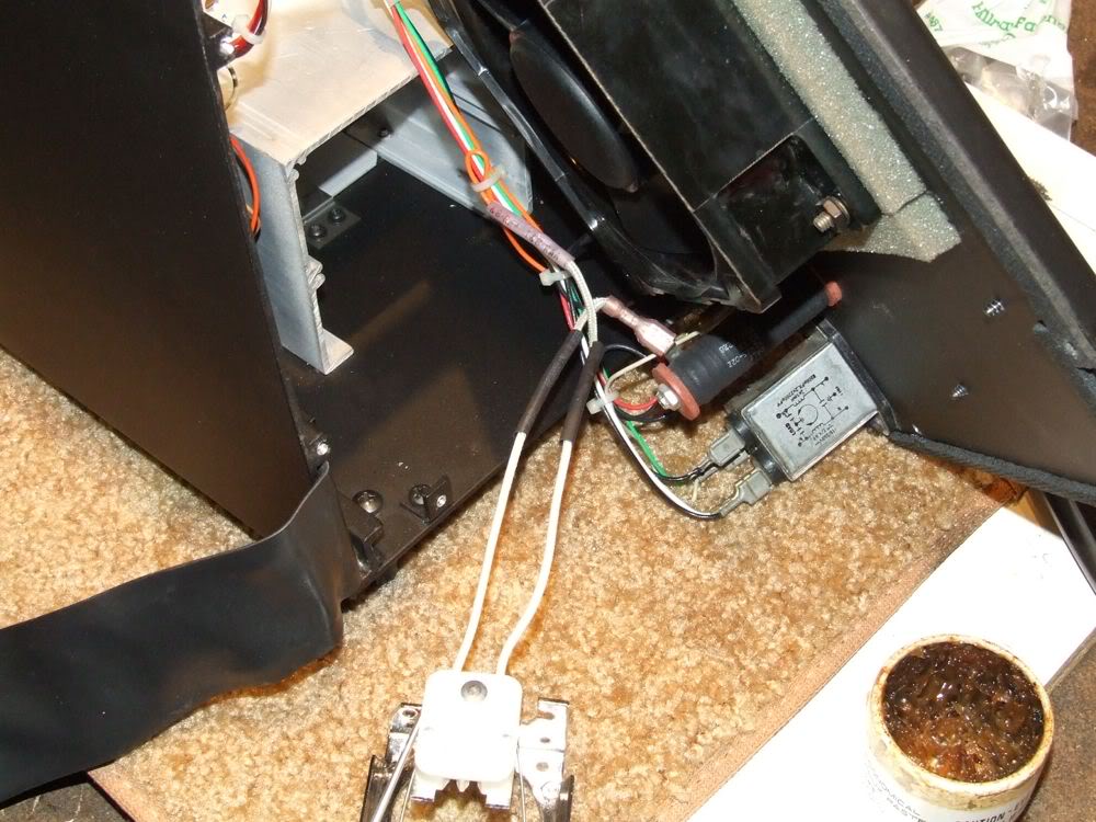

In this case I cut the old wires and spliced the new ones in-line. I used heat shrink tubing to cover the solder joint.

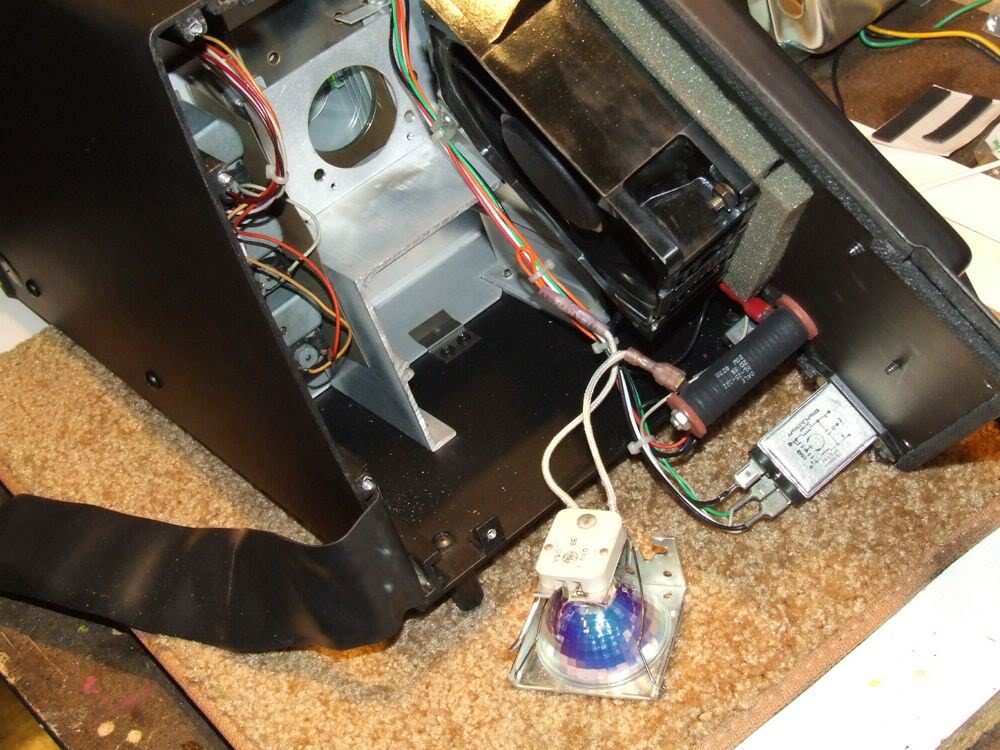

Two easy to reach screws hold the socket in place.
