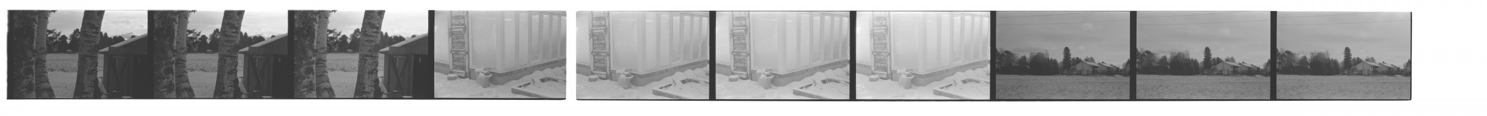

Big boys told me somewhere that Fomapan 400 is "OK film if you shoot it at 200". I thought I had done something terrible wrong, exposing it at 400 or sometimes at 320 (also this ISO speed is the "correct" speed told be another big boys). Maybe this why I shoot so bad photographs! Of course, this is it! I must try it!
So I did shoot a roll of 135. I shot few different scenes to see how my photography suddenly comes better. I tried to measure the scenes correctly (spot meter, zone measuring, camera measuring) and then I increased the shutter time for one stop two times - to get exposure at 400, 200 and 100 speeds.
I developed the test film at xtol 1:1 for 9min 30 seconds, so at "box speed". When I pulled the film from the tank I was like, yeah now we see some density difference! However I couldn't see any difference in the frames, I thought I did something totally wrong. I checked the camera exposure memory and yes, I had exposed everything like I planned.On any of the scenes I just cannot any dramatic changes. Or maybe I cannot even see any changes..
I was aware that negative film handles overexposure pretty well previously. One can overexpose 2-3 stops without any real "harm". Maybe a bit denser negative but nothing to worry about.
So should Fomapan 400 shot at ISO 200? If you have the extra light, sure - go ahead. Film loves light. Do you need to do that? Based on this experience, I would say I don't understand why one should. Maybe to avoid underexposure? I accidentally underexposed one frame by one stop and the film handled that well too.
Here is one video of me showing three scans (without any level adjustment with Epson V600). Right upper corner shows exposure information. Check how the exposure affects to the levels. The changes in levels is really the only real difference I can see. The negative frames are pretty similar, maybe the slowest frame is a tiny tiny bit denser. So the scans shows pretty much the reality.

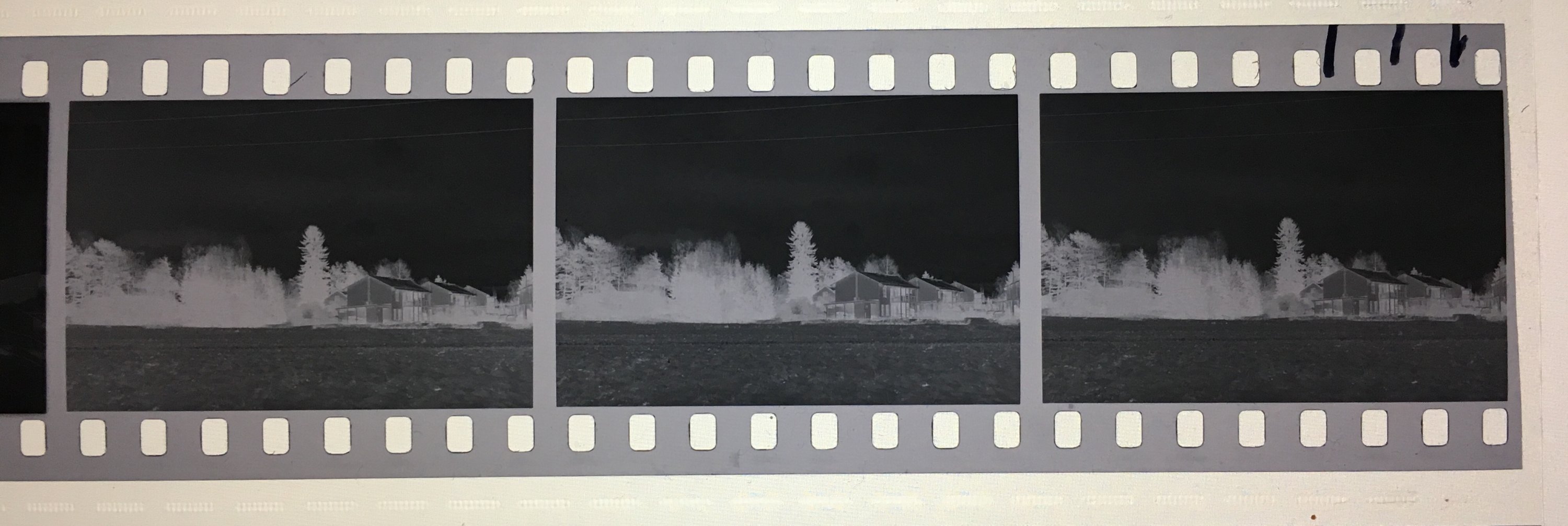

Attached is a mobile phone snap of the negative on light table:
(removed confusing strip here..)

It looks like the same strip to me :wink: (and yes, it looks underdeveloped to me as well, but I wouldn't venture a guess on development based on a digital snapshot).

The top version of the strip looks over-developed, while the bottom version looks under-developed.
Which merely highlights how difficult it is to do this over the internet.

First of all, apologies of the mixup with the two strips. They are both the same, I just brightened the second to make it easier to analyze but the explanation text between images were lost in translation.. Did not mean to confuse you!
So here is a quite huge image. The following strip was scanned on one single scan. No levels adjusted, reset all auto things on Epson scan and no post-process fixing. I only cut&copied the strips in a row but that's all there is. There aren't any scan / adjustment difference between the frames. So the negatives are pretty comparable.
All frames have increased time by half stop. The middle one have one extra too.
Here is a direct link to larger picture: http://vedos.tuu.fi/foma400.jpg
My thoughts on this issue somehow start to come clear. As overexposing or increasing exposure doesn't really do anything for the highlights other than those come "brighter" (aka denser) the increased exposure has a "real" affect to the shadows. So what we are doing when increasing exposure is helping out the shadow details and that is it. And that is totally normal. Maybe Foma 400 needs that, it is hard to say with these tests.
I still think it is wrong to say that "Foma 400 is actually ISO 200 film". However it might be true - what everyone says that Foma 400 - that you needs more exposure when you want shadow details. But still in my opinion far stretch from a statement that one should expose Foma 400 at 200 always and in all the scenes.
For example if you look at the strip and the middle scene (with four shots) there isn't any shadow details to save. Yes it is really low in SLR. But sometimes photographs are low at SLR. The negative just gets dense but one doesn't gain anything with that. Why would I need to shoot that kind of scenes at ISO 200?
Maybe the bottom line here is: "if you want shadow details, some films need one stop increased exposure" - what about this instead of the worn out mantra :D
