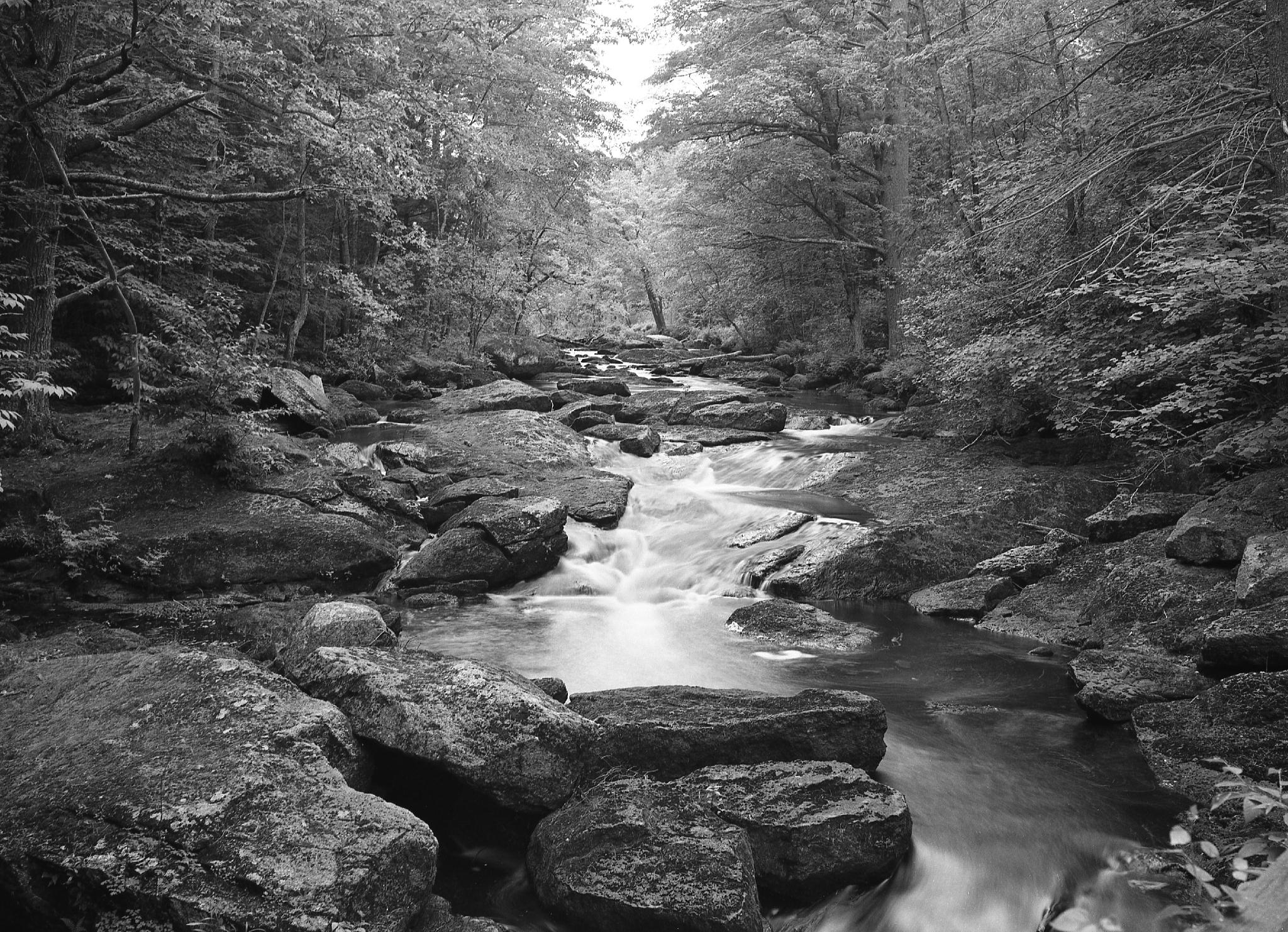

I have been using Pan F Plus for long exposure (3-10 seconds) for softly lit water scenes . . developed in d76 1+1. Lovely. Next roll will be developed in Microdol X to compare. I am visiting this same spot this weekend . . .

Great results John. I've had trouble with Pan F Plus in XTOL-R, but fine in XTOL 1+1.5. As you can see I've just today put some Pan F Plus / Tetenal Ultrafin 1+29 images in the gallery here. In the past I've had mixed results with Ultrafin but Iooking back on notes, I think I was using it too strong. 1+19 - 1+29 seems a good range.
Thank you Tom, I was admiring your North West Scotland images earlier.
