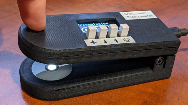

I figured it was time for another project update. So we'll begin with some quick photos of the latest prototype:
This prototype finally gets the whole hinge mechanism working correctly (with stronger springs), and can even detect when the device is fully-open or being closed on a target. Exactly how I use that information is still somewhat TBD, but right now its being used to turn the read lights on and off.
The buttons are still a bit on the tall side, but I'm going to be experimenting with some 3D printed alternatives to see if I can shrink them a bit. Most of my other options would require making the top cover thicker, which would have the undesired side effect of making the display appear more "sunken" into the device.
I'm also going to have a nice graphic overlay on the top cover, which will better protect the display and allow for nicer artwork. The first version of this (already ordered) is somewhat basic in its design, but I hope to eventually find a graphic designer to help make it better.
As far as the rest of the build, I'm going to likely end up doing a few iterations of commercial 3D printing options. What you see above was printed by me at home, but I need better for any sort of quantity. This is probably going to involve some trial-and-error, since everyone has long turnaround times and the material properties I care about aren't always listed on their websites (e.g. being completely opaque to IR).
I'm also still researching my options for the "stage plate" material (white concentric rings above). The stuff I'm using right now has a fairly glossy finish, and smudges easily. Meanwhile, what my X-Rite uses is a bit more matte. I'm limited to what I can easily order from Laser-cutting places (e.g. Ponoko), so that's going to take some trial-and-error as well.
Functionality-wise, reflection has been working well for a while. My results are generally consistent for the B&W paper I've tested, but handling colored targets (e.g. red or blue paper) is still a challenge. I'm probably never going to match the X-Rite units on those, but I'm still a lot closer than the Heiland TRD-2. Testing higher density (e.g. above D=2.05) targets is still proving to be a challenge as well, because calibrated reference materials don't go that high. The only thing I have that does go that high is the Dmax of an IT8 targer printed on color paper. I'm still not matching the X-Rite on this, but I might be matching or beating the Heiland.
For transmission measurements, I'm only just getting started with testing. I recently ordered a collection of materials from Stouffer to help fully test and compare transmission performance, and they should be arriving soon. The software for it is all written, and works in theory, but I still need to actually compare side-by-side graphs of step tablet measurements to be sure.
The software is coming together pretty well. Its already almost feature complete, as far as the important features go. There's still a lot of polish, of course, and I still need to come up with a way to make it easier for end-users to update the software. (I may switch to a microcontroller one more notch up the product line to help with some of this, pending availability.)
As always, I'm now trying to track the majority of my outstanding issues in the GitHub issue tracker:
https://github.com/dkonigsberg/printalyzer-densitometer/issues
The great chip shortage of 2020 is still a hurdle to making anything beyond a few prototypes, but if I'm really lucky I might be able to pull off a batch of evaluation units before 2021. (More than one component on this thing is affected by the shortage.)

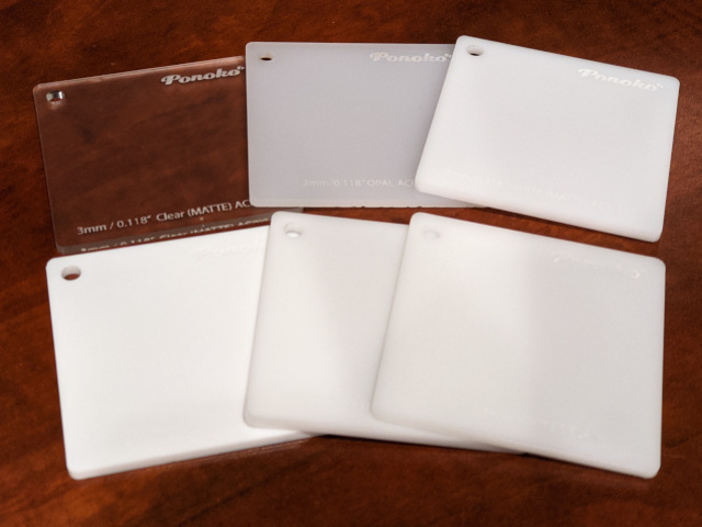

Thanks to today's UPS delivery, I now have a complete collection of white(ish) stock from Ponoko to evaluate for the stage plate construction:
I'm currently using the one called "Opal Acrylic" (upper-middle) but its a bit too shiny on top. (Functionally this is probably fine, but I don't want it picking up smudges or fingerprints.
While I'll give these a full round of measurement on my X-Rite densitometer before making a final decision, I'm currently leaning towards switching to the "White (Matte) Acrylic" (upper-right) one for the next revision. Its slightly less transmissive, but probably still okay, and will give a better surface finish.
I also now have more Stouffer calibration references and wedge/tablet scales, so I should be able to to a complete workup of reflection and transmission performance soon.

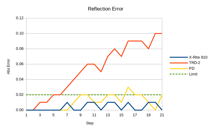

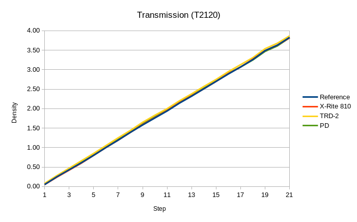

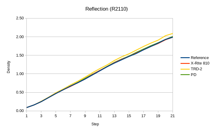

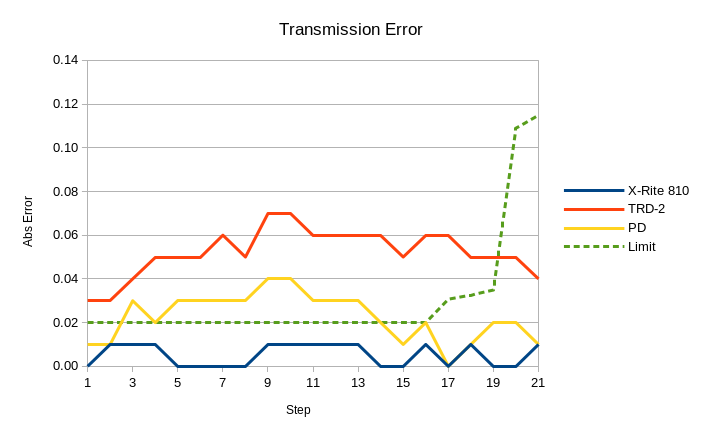

So I spent some time today doing a full calibrated testing workup of my Printalyzer Densitometer (in its current state) versus my X-Rite 810 and my Heiland TRD-2.
To do these tests, I used various calibrated reflection and transmission materials from Stouffer:
  • R550C 5-step reflection tablet (calibration)
  • R2110C 21-step reflection tablet (comparison measurements)
  • T5100C 5-step transmission wedge (calibration)
  • T2120C 21-step transmission wedge (comparison measurements)
(I also have some X-Rite calibration materials, which were involved in some of this, which I mention again below.)
I made sure my X-Rite and Printalyzer Densitometer were calibrated the same. The Heiland is impossible for the end-user to properly calibrate, so I just zero'd it on whatever seemed most appropriate and offset any affected measurements accordingly.
Including graphs as thumbnails to avoid overwhelming the post:
pd-comp-refl-meas.png pd-comp-refl-err.png pd-comp-trans-meas.png pd-comp-trans-err.png
(The "Limit" marked on the error graphs is based on the accuracy figures in the specifications for my X-Rite 810.)
From these tests, I've gathered the following takeaways:
  • I'm pretty darn close on Reflection, maybe even good enough
  • I'm fairly close on Transmission, but there is room for improvement. (The mechanics of keeping the device aligned need work, and the measurement/calculation routines could probably use some improvements as well.)
  • The X-Rite Reflection Calibration plaque matches up with the Stouffer reflection tablets well enough that either can be used for calibration with comparable results.
  • The X-Rite Transmission Calibration wedge (acquired via Acurad) I have appears to have been calibrated to a completely different standard than whatever Stouffer uses. I'm not sure which one is correct, but I can't interchange them. As long as I'm measuring Stouffer-calibrated step wedges, I have to calibrate the densitometer with a Stouffer-calibrated reference.
  • The Heiland TRD-2 is not very good. I think its biggest failing is that there's no way for the end-user to properly recalibrate it, but it has other issues too. Regardless, I think the only "competition" actually worth comparing accuracy against is the X-Rite.

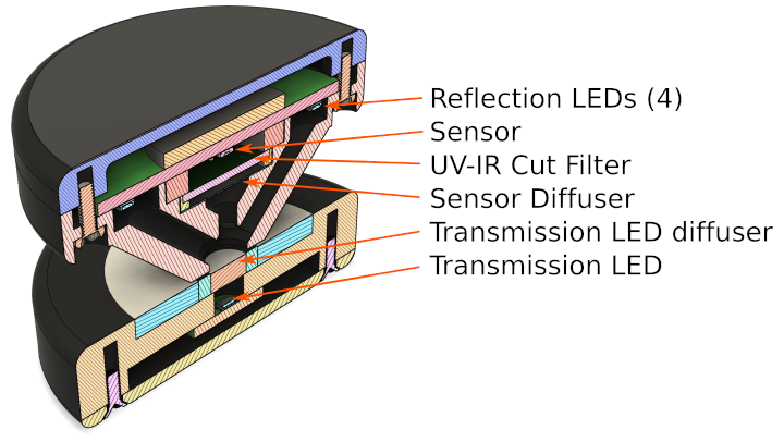

Also, because its a neat picture, and for reference, here's a cutaway view of what the sensor head on this thing actually looks like:
As far as changing sensors or adding complexity (and cost) to the whole sensor mechanism... The only reason to do that is if it actually gives me better data than what I'm getting right now, with an acceptable cost/benefit. If I define my requirements as "ISO 5-3:2009 Visual" (as the B&W side of X-Rite hardware does), then I'm already doing pretty well. I'm not even sure I can get much better without a major increase in cost/feasibility.
If I want to also cover the ISO 5-3:2009 Status A/M ranges, there seem to be 2 available approaches:
  1. Have a separate sensor for each "channel", tuned to the specific sensitivity of that channel (what X-Rite does)
  2. Figure out how to correctly interpolate the data from a multi-spectral digital sensor (e.g. AS7341 or AS7265x) to get data that's functionally close enough to the first approach.
Some of these may have geometric considerations that may make it impossible to use the same sensor for both reflection and transmission.

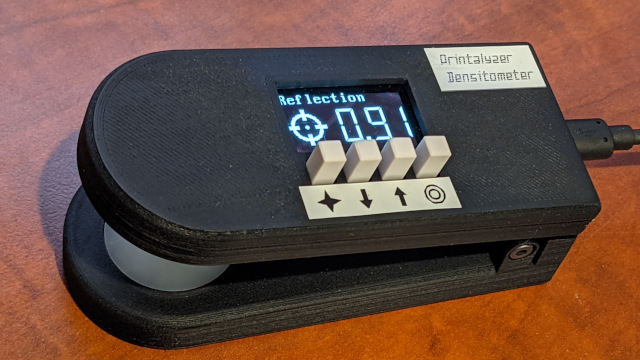

Its probably time for another project update, so I'll start it off with a photo:
The top two are the initial prototypes have the "Rev A" circuit board, and the bottom one has the brand-new "Rev B" circuit board. The differences are minor, and mostly have to do with switching to a slightly more capable microcontroller (more memory, easier to update) and fixing some nitpicks from the first version. All the important components are unchanged. I've also been continuing to refine some elements of the enclosure, but that's also hard to see in the photo.
These prototypes also now have a nice "graphic overlay" with printing on top. This is currently more of a proof-of-concept to make sure the mechanical aspects are right, as I absolutely plan to change the colors and some of the artwork.
The bulk of my current project work in the past few weeks has been centered around evaluating commercial 3D printing technologies for the enclosure. This is a summary of what I've discovered:
  • Fused Deposition Modeling (FDM) - This is what your home 3D printer does. Its great for its low-cost, and does a decent job with the internal components. Quality is generally good as long as your print doesn't need supports. The moment your design does need supports, there are a lot of tradeoffs to consider and its no longer the best option.
  • Multi-Jet Fusion (MJF) - One of the more popular commercial options. Doesn't come in a variety of colors, but produces a nice result. Biggest problem, however, is that the "dimensional accuracy" of a print seems unusably bad. On paper its excellent, but all the prints I've ordered (from companies that I don't have a personal relationship with) are off by just enough that screw holes don't line up and parts don't fit together.
  • Selective Laser Sintering (SLS) - Quality is good. Dimensional accuracy is good. Comes in a variety of colors. I've even found low-cost options for getting it done. Biggest problem is that the material isn't opaque enough for use around the critical parts of the sensor head.
So I think I've settled on what path I'm going to take. I'm probably going to have the bulk of the enclosure itself printed on an SLS machine, then use an FDM machine to make the light path components (sensor cone, etc) and some internal parts. This may end up with a cool two-tone design, with a blue body and a black cone. I'm probably going to make the first full-up version of this in the next few weeks. (Oh, and I also found a matte black PLA that I really like from 3DXTECH, so that's what all the FDM/black parts will probably be made from.)
The other thing I'm working on, now that the "Rev B" circuitry has been constructed, is getting back to work on the actual software development. First I'm making some architectural changes enabled by having more memory. Second, there's a lot of details I want to revisit about how I run the sensor and even how I calibrate/characterize the sensor. The hope is that this will make everything smoother and more accurate, once its all worked through. Probably not going to go into all the details of this just yet.
Regardless, at this point the whole project is just as much "developing a product" as it is "make a gadget that gives good numbers." As such, I've also been thinking through a variety of other issues from cost tracking through business concerns. Hopefully I'll have something more public-facing to share along those lines in the next few months.

Do I understand this is powered by and transmits data over usb-c? Cool.
dkonigs
dkonigs
Sep 17, 2009
384
Mountain View, CA
Technically its just micro-USB, but otherwise that's correct.
(Not yet sure if it makes sense to change connectors, as with a device like this the only real difference between the two would be which cables you can use with it.)
