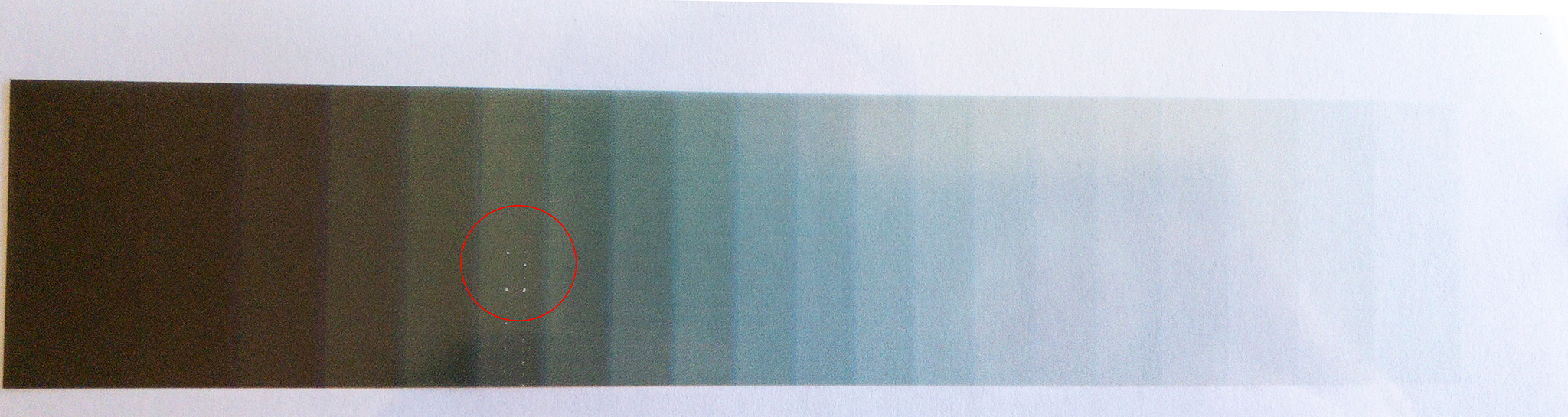

frankg
Apr 12, 2005
27
Yes, there is a 'rough' or 'textured' side to the film.
The quality of the transparency film may well not be good enough to hold the ink well.
I will try and source one of the better ones (pictorico or Fixxons) but they're impossible to find locally [Canada] & shipping costs from the US are v high
Good News! -
I just ran several cycles to align the head & make sure all the nozzles are firing.
I changed the print settings to:
Ps manages col
Printer profile - ultra premium photo paper glossy
Print mode - AccuPhoto(col)
Print quality - Best
Hi speed & Gloss optimizer - Off
A remarkable difference. Not perfect but vastly improved.
I still have a few 'pinhole' dots in one of the step wedge bars :-( Phone photo attached
Thanks for the help....getting there

nmp
Jan 20, 2005
1,995
Maryland USA
Pretty sure those are pizza wheels. If you want, they can be very easily taken out which is what I have done. I use a 13" wide carrier sheet on which I affix the transparency somewhere in the middle. Pizza wheels that come over just the transparency are then taken out, leaving the peripheral one in so they can still function to hold the paper down.
:Niranjan.

Andrew O'Neill
Jan 16, 2004
11,762
Coquitlam,BC Canada
Not sure I follow you exactly.
Are you saying not to print an entire sheet but to place images in or near the centre only ?
If so, how to determine the area to avoid on for example a letter /A4 size?
No, I think he means to centre and tape a sheet of film on a piece of paper, before running it through the printer. That's what I used to do when I had the 4000. Never have had pizza wheel issues with the P400, unless I was laying down too much ink.
