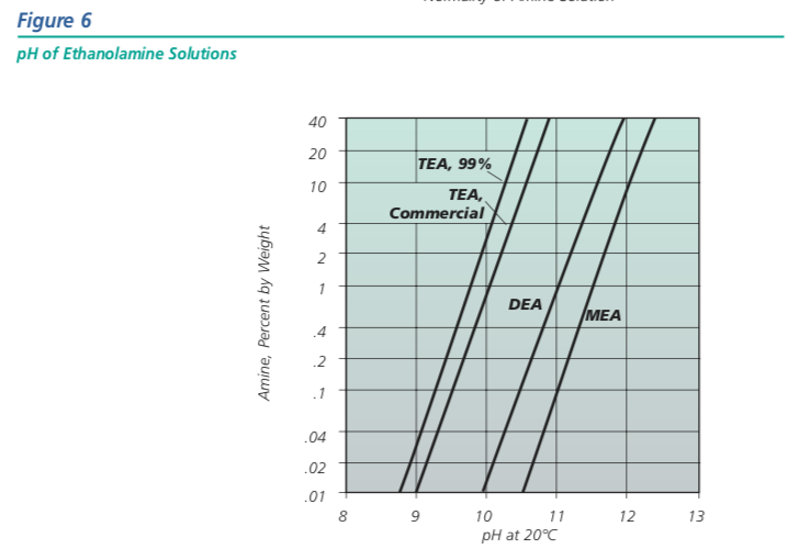

TEA, DEA & MEA pH data

Several of the compounds you listed have more than one pKa value. Potassium Carbonate and Potassium Sulfite are rarely used in photo chemistry because of their lower pKa value at 3.68 and 6.81, but rather for their higher pKa values. The pKa value sets of Borax and Boric Acid should be merged into one. The pKa value you listed for Catechol appears way off.
These tables are really a lot of work, and they are very error prone, which means we will frequently have to make additions and corrections. I don't think, that a forum thread is a good format to reflect this. I suggest we start some wiki or something like this. I will happily< submit my set of data once a suitable platform is created.

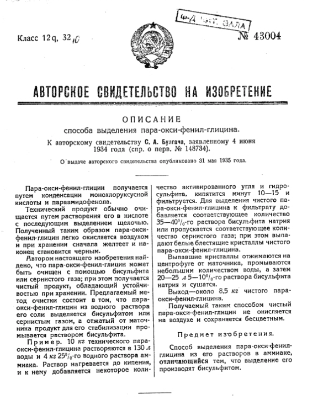

Off-topic
The method of restoring old paraoxyphenylglycine (glycine-photo) - is further referred to as POPG.
USSR patent No. 43004
10 kg of POPG is dissolved in 130 l of water and 4 kg of a 25% ammonia solution.The resulting solution is brought to a boil and a small amount of activated carbon and hydrosulfite (aqueous bisulfite solution) is added to it, after which the mixture is boiled for 10-15 minutes.
The mixture is then filtered. A 30-40% sodium bisulfite solution is added to the resulting solution. In this case, white shiny crystals of pure POPG fall out. The crystals are squeezed out in a centrifuge or filtered off, washed with a small amount of distilled water and then with 5-10% bisulfite solution. Then they are dried.
The result is about 8.5 kg of pure POFG.
The obtained POFG does not oxidize in air and retains its white color.
