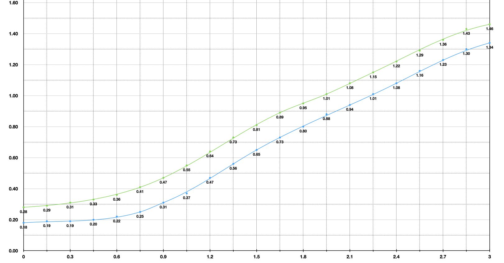

Kentmere 400 and Tri-X 400 have pretty much the same exact curve in XTOL 1+1, except Kentmere has a higher base fog. 0.18 for 400TX @ 6.5m, 0.28 for K400 @ 9m. Not sure if the base fog has anything to do with it but I find Kentmere to be grainier, but a great cheap alternative to Tri-X. I buy 100' rolls of it for shoots where I don't mind the extra graininess. I develop them both to print well at grade 3. My readings of 400TX (blue) and K400 (green) attached below.
