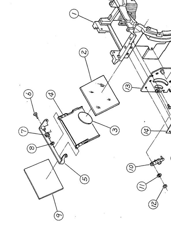

I was doing some repairs on a FX-3 Yashica today and noticed this. Seems the mirror is held on with tape. #3 in the picture is listed as "Mirror Tape."

Yes, I already knew about the tape. But what I did was simple and this really works. Gorilla glue is supposed to be applied with a bit of water. I did not know how profound that directive really was, so I did just that. The bond is inseparable now.
The problem with the mounting tape is that it has a considerable thickness. THAT will modify the precise alignment of the mirror and might cause VF focus to be a bit differently from REAL (film plane) focus. I take no chances. And the amount of Gorilla glue (with water) I applied was minuscule, thus no expansion worries. - David Lyga
