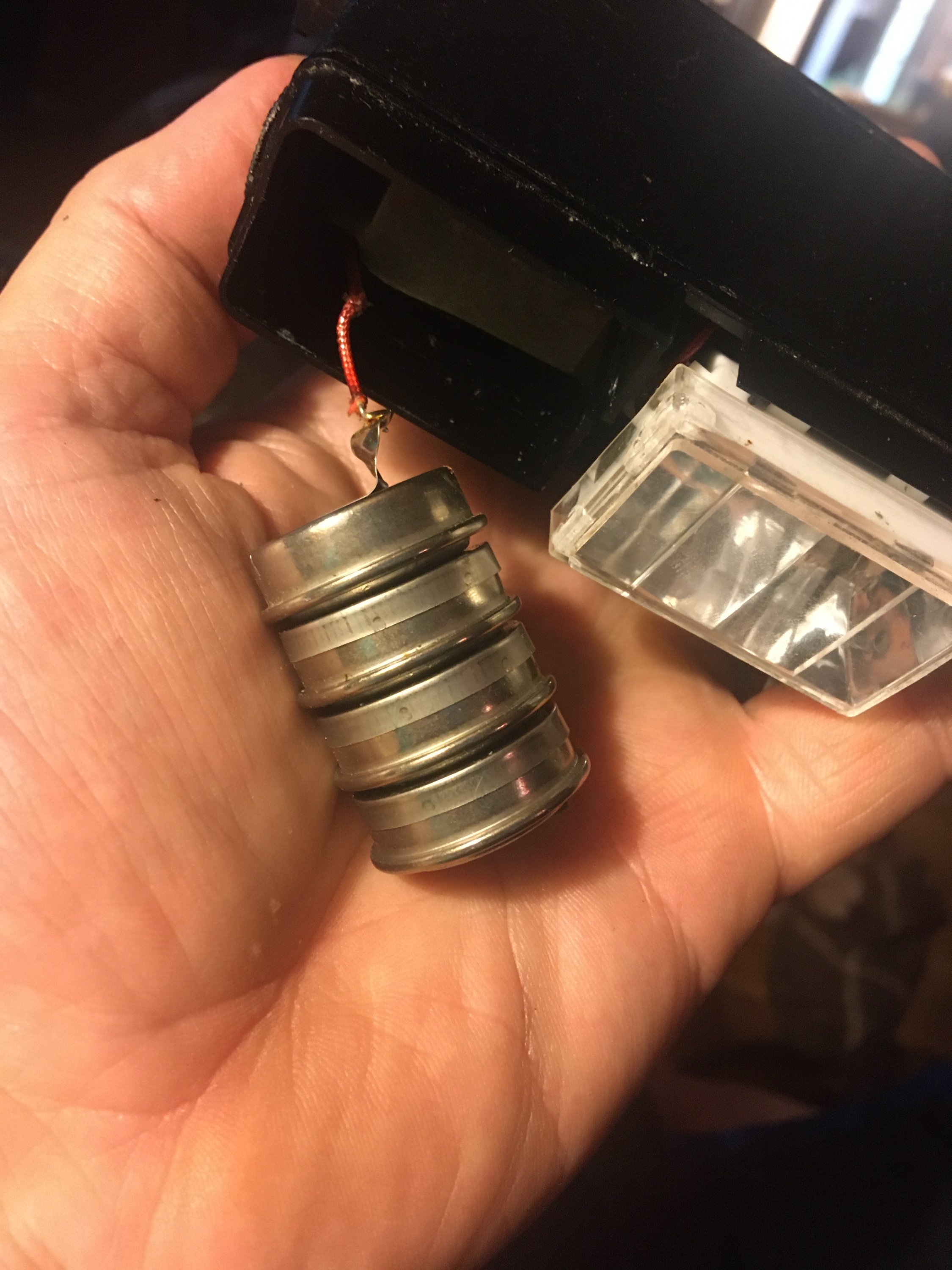

This looks fairly easy. Batteries are coded DEAC. Four cells in series. Now I just have to find them.
Andy

Yes by all means! Replace with NiMH batteries.
Flashes of that generation have built-in batteries. Exchanging them for NiMh ones, if dimensions fit, means needing to exchang the charger too (which typically is also designed as feeder for mains operation).
Some sizes of NiCd batteries are still available, thus the flash can be left in original state.

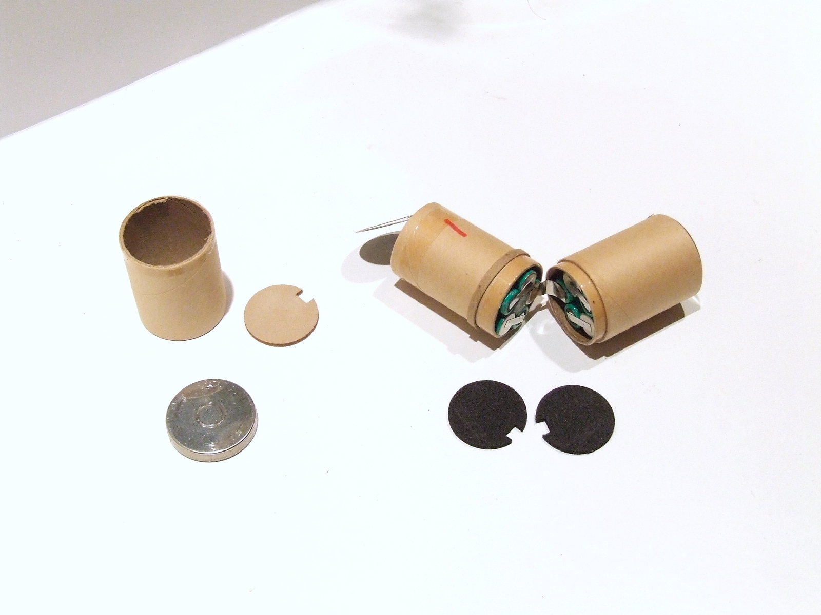

Too bad it is not 5 cells because I believe those button cells are not available. Stacks of 5 of those button cells can be duplicated with 5 AAA cells. Duplicating a stack of 4 will be difficult.
I wonder whether I could simply unsolder one of those and reassemble the stack with four?
Andy
ic-racer
Feb 25, 2007
16,480
USA
Andy
That is the one made of 5 AAA cells, but look back at the post #9, I think I found the flat cells you need already welded together and updated the post.
