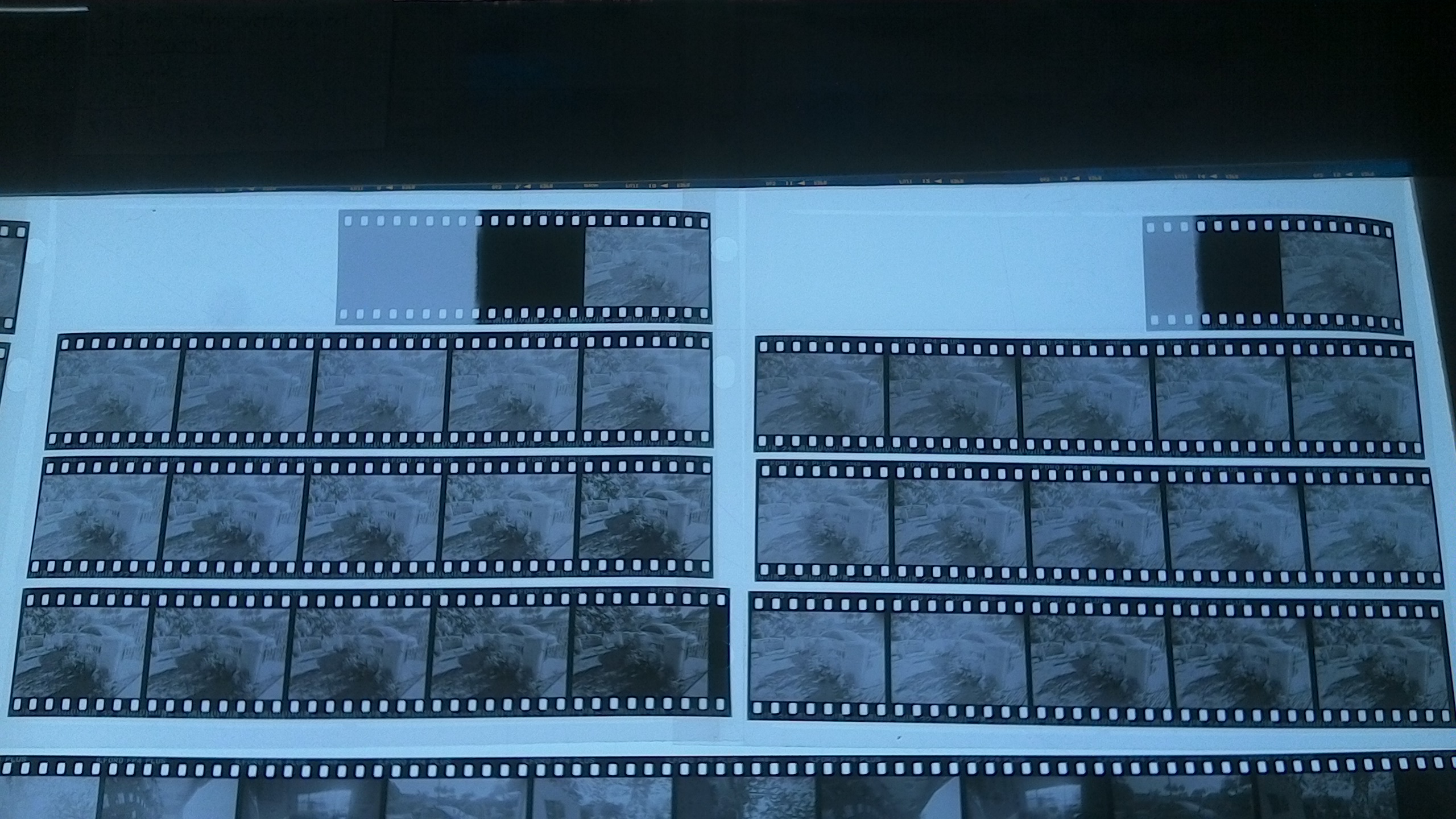

I've been trying to get reversal processing to work. My goal is to be able to shoot FP4+ at box speed and have the option of processing it either as a negative or a positive. For a little while I though I might be getting things dialed in, but after 8 tries my results have stopped making any sense and the exposures are all over the map. If I compare a roll developed at 16:00 minutes to one developed at 19:00 minutes, overall the 16:00 minute roll is brighter.
Could the first developer chemistry I'm using be all wrong and bound to cause problems? I suspect that my cameras light meter might be glitching out. I've had problems in the past with the leads in the ISO dial not making good contact. When I had it overhauled 10 years ago, the technician told that the ISO dial is the only thing that isn't weather sealed. Since then it's been through dust storms, rain storms, smoke and fire, ocean spray, and getting dropped in the mud ISO dial first. So, the leads might need a good cleaning by now. Still, I've been shooing a lot of Velvia 50 and Provia recently, and I see no indication of exposure problems.

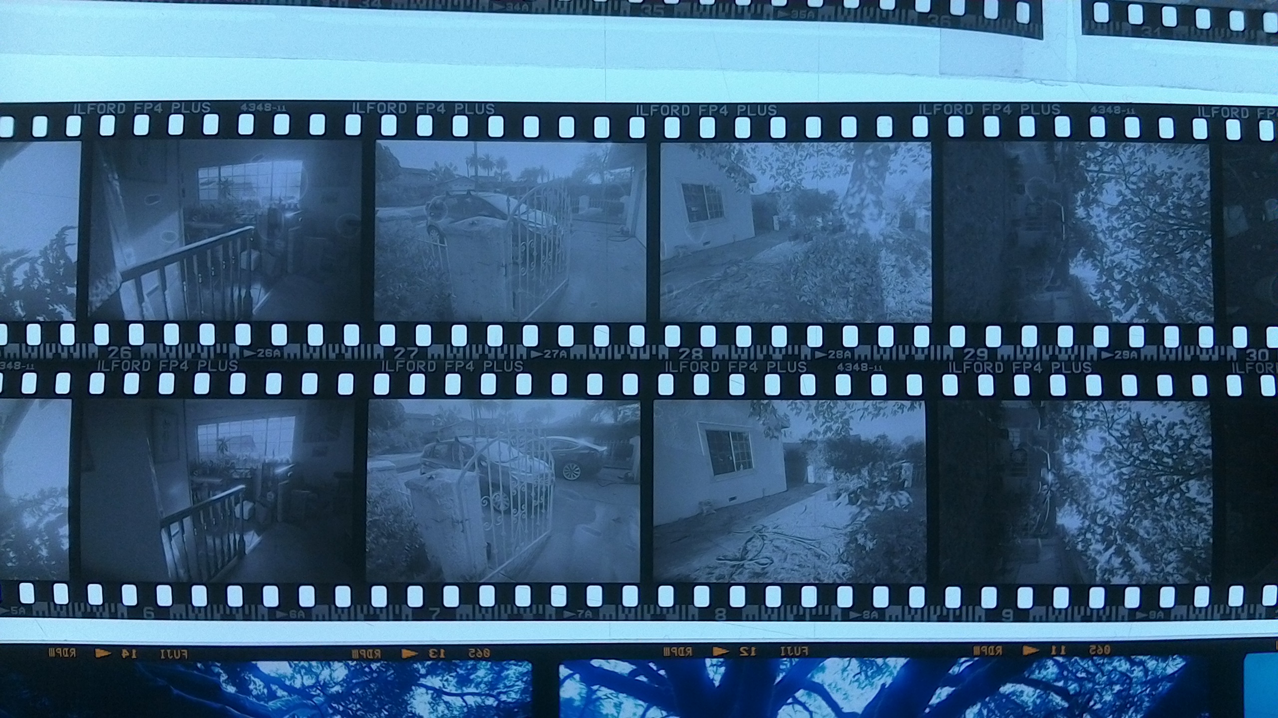

The second problem is that I'm getting all these weird marks that look like water drops. It seems like drops from one of the baths are sticking to the film in between baths, and continuing to react with the film. I try to get the baths changed out as fast as possible. I really have no idea what's causing this.
Here's all the details of what I'm doing.
1. 1st dev: Rodinal 1:25 with 2g Sodium Thiocyanate, and 250mg Sodium Bromide in 1 liter of distilled water
Development times are from 13:30 to 19:00 minutes
2. 3 tap water rinses, 10, 20, and then 30 inversions
3. Potassium Dichromate bleach, 3 minutes continuous agitation
4. 3 tap water rinses, 10, 20, and then 30 inversions
5. Clearing bath, 2 minutes continuous agitation
6. 3 tap water rinses, 10, 20, and then 30 inversions
7. 1 minute light exposure
8. 2nd developer: XTOL stock 8 minutes
9. water stop bath
10. TF-4 fixer, 6 minutes
11. A thorough rinse
12. Edwal wetting agent bath

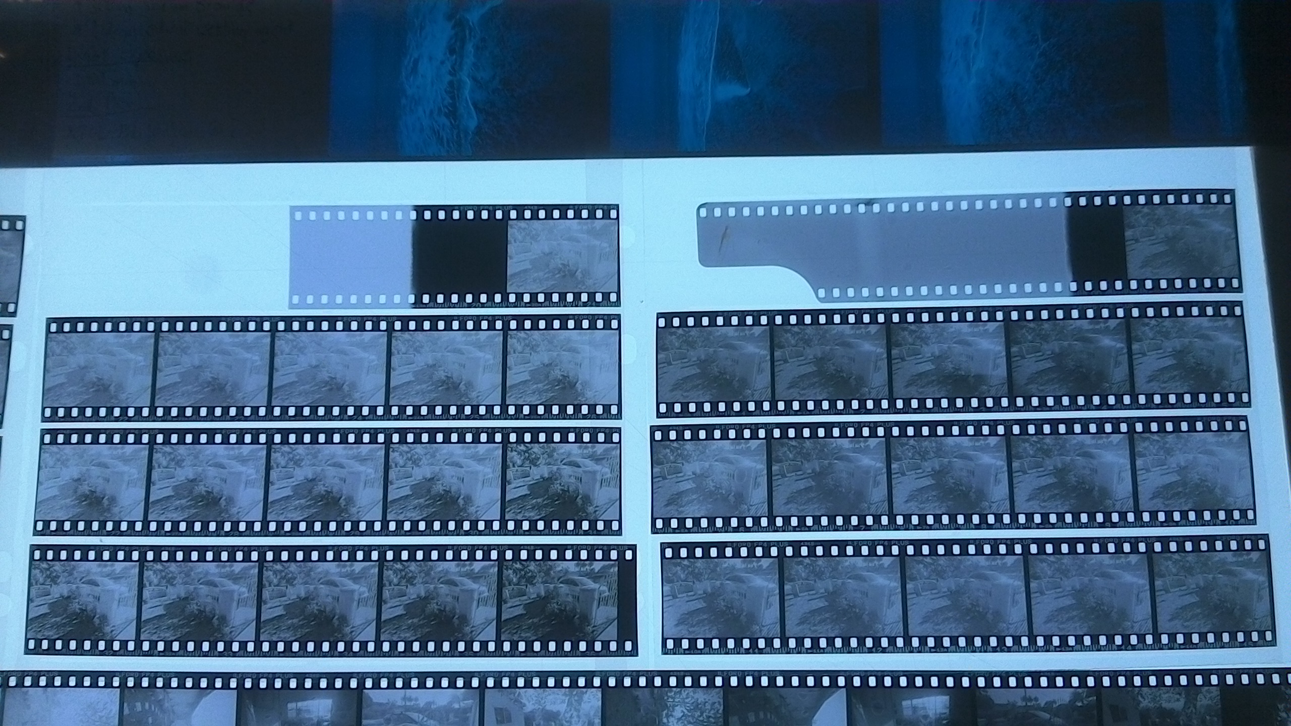

The left has 19 minutes of development, while the right has 16 minutes. These are from ISO 12 to 400 in 1/3 stop increments. Some frames are randomly brighter, while in should be a even gradation.
The top has 13:30 minutes of development, while the bottom has 15:30 minutes.
The weird drop like marks. My Nikon Coolscan is out of commission, so this is the best image I could get.

You should do the light exposure for two minutes (one minute from each side) under water in a white pot. The film can remain on the reel if you use a white plastic reel. I think the light exposure outside a water bath could be responsible for the weird water marks on your film.

The marks being caused by the light exposure makes sense. I'll try to do it in water. If that fails I'll go with a fogging bath. Fogging baths look like another large topic to spend some time digging through.

The marks being due to light exposure is plausible to me. When I was first doing this, I was rotating the reel around a foot from the light for two minutes, and the film on the outside of the reel ended up uniformly faded. I could see the shadow cast from the leader on the rest of the film. When I exposed the film from across the room for a minute to 30 seconds, this problem went away.
The plan is to put the reels in one of those white semi-trasparent nalgene bottles filled with water, and expose it for a minute. I'm luckily working in a bathroom without any windows, and I can just turn the lights on and off.

- I believe that the blob-shaped mottle that you show is due to water droplets on the surface of the film during light exposure. Holding the film under water during the 2nd exposure should help, as well as possibly increasing the amount of exposure. Rotate the reel during the exposure and flip it over several times, even with translucent reels to prevent shadowing. It's hard to over-do light fogging using artificial light. I would err on the side of more rather than less. I suspect 1 min may not be enough in a nalgene translucent bottle unless you hold it close to a very bright light.

I was wondering if uneven development may have caused all that variation in the brightness across the film. Continuous agitation is something I'll probably try. I've been using the fairly standard one minute continuous inversions, and then 3 inversions every minute. I'm using a Paterson tank, and I've done continuous agitation before with the spin stick. In the past I'd though about rigging something together with a slow moving motor for continuous agitation.
I may mix some D-19 and give it a try. I have enough chemicals on hand to mix up a range of different developers. Interestingly, I did some digging around and found a post where the DR5 guy had positive things to say about Rodinal and reversal development.
This last result is really messing with my head. The left is 19:00 minutes. The right is 13:30 minutes.

I re-exposed the film underwater, and all of the marks are now gone.
