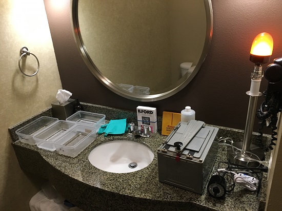

I develop film on the road all the time with beer. I have a small kit I bring with me that has the stuff that I can’t easily get at my destination like Ascorbic Acid and anhydrous sodium carbonate. I can get beer, and salt just about anywhere. You could do Caffenol the same way, all you would need to get is instant coffee and distilled water.
I’ve made contact prints in a hotel bathroom, but that was after driving to the destination.
