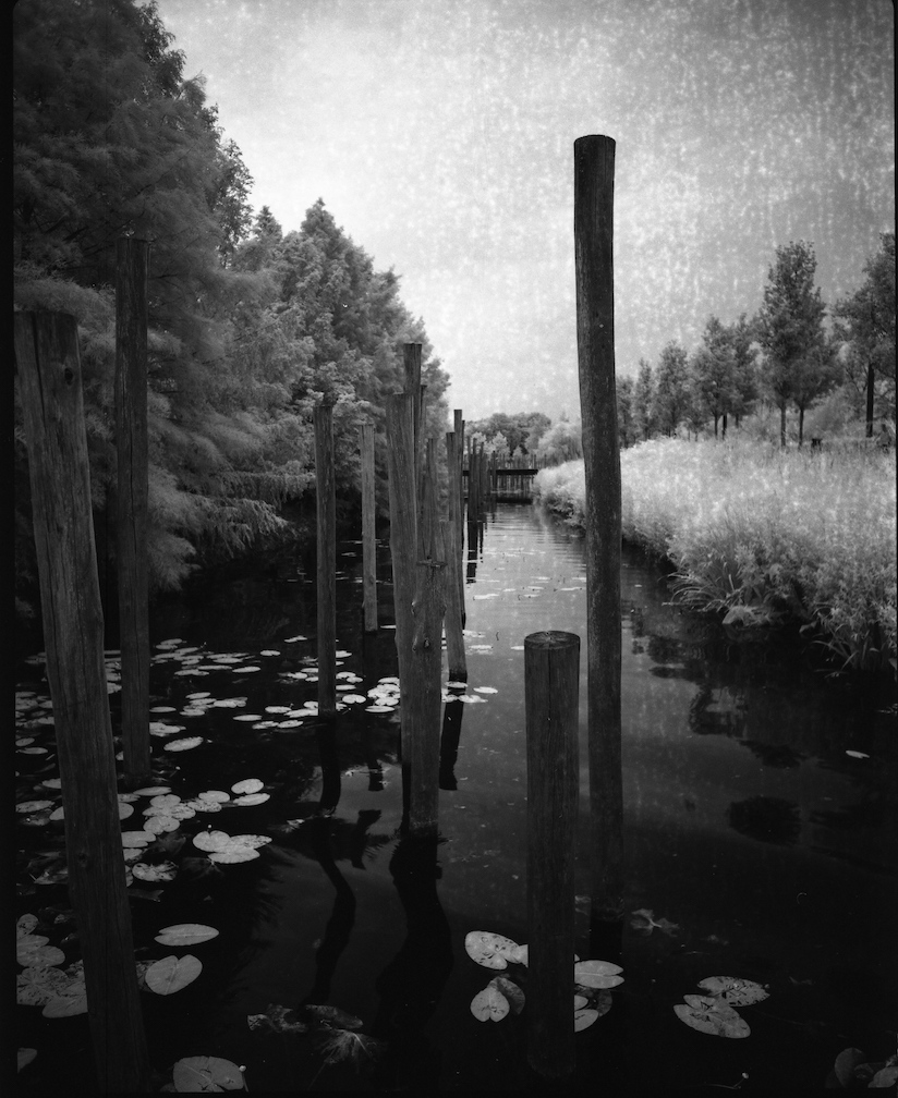

Hi,
I got weird spots in the dark areas of Rollei IR400 120 developed in DD-X. Is this the infamous mottling caused by backing paper? In the same tank I developed another roll IR400 120 (bought at the same time), same problem. I also had a roll Fuj Acros 120 in the same tank which looks okay, so I'd say that the chemicals and process was okay.
Developed in unicolor film tank on uniroller: presoak 5min, DD-X 1:4 10min (72F I think), ilfostop 30s, 2x ilford fix 3min, 6x water wash 2min each, photoflo 1:100 soak, dried in Prinz dryer.
IR400 was shot in a Plaubel Makina with IR 720 filter, no red window. The backing paper looks okay, some scratches but could easily have happened when I was putting the film on the dev reel. No pattern like on the photo obvious on the paper. It does smell, the ink I suppose, the acros paper seems odourless.
What could cause this? I'm about to develop some Delta 400 rolls so I want to make sure it is not my process before messing up my trip photos.
Thanks!
Gijsbert

Did you soak the film first in a water bath to remove the anti-halation layer?
gijsbert
Jun 17, 2014
218
I did for 5 minutes, probably more, I just let the uniroller roll with water while I prep the chemicals.

To me it looks like the classic humid storage induced mottling.

when did you buy the IR film? where did you buy it from? did you contact Maco yet?
I had this same issue a few years ago and was hoping that it was a one time issue.

Bought in July in Amsterdam, it was just in a silver wrapper no longer in the canister thingy. I was surprised they had it, I thought IR400 was no longer available and was using Retro 400 for IR.

I would suspect the film had been frozen and thawed multiple times and what little moisture was present in the wrapper finally had an effect on the emulsion.
yeh, that would be a good guess. the fact that it wasnt in a box would be a sign to me of improper storage

Looks like backing paper issue.
Well, there are several "backing paper" issues:
-) related to long storage in extreme humid condition
-) related to chemical interaction between backing-paper/printing and the emusion
-) abrasion/stress between paper and emulsion
Regardless, it all points to the backing paper. Never used to be an issue...or has it?

Well, the humidity cause basically applies on all rollfilms. Since ever.
The other causes so far were reported for Kodak, Ilford and Foma.
Actually it did, but for quite a long period when 120 volumes were very high and photographic product shipping was quite efficient - from the 1970s or maybe a bit earlier - it wasn't often seen.
