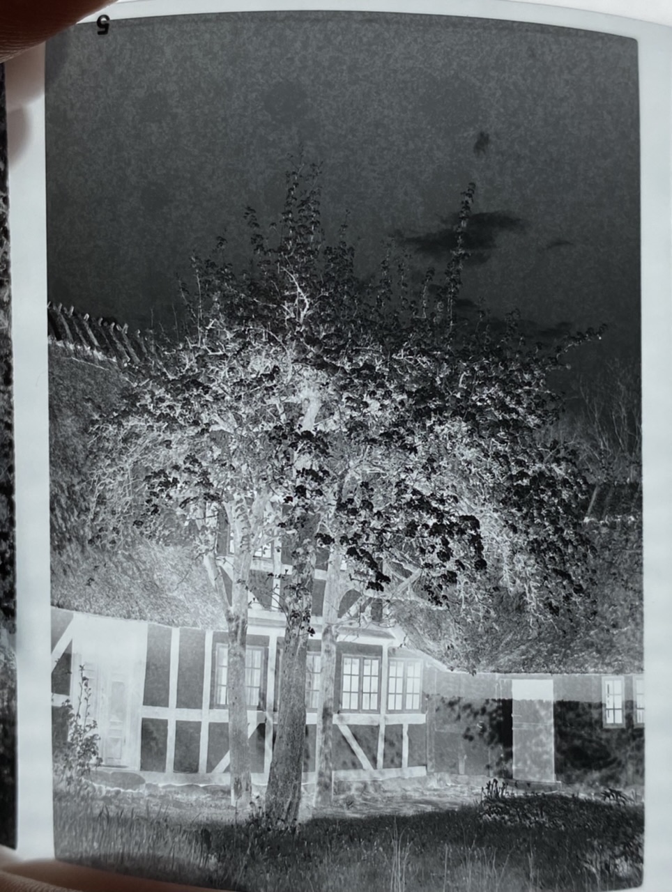

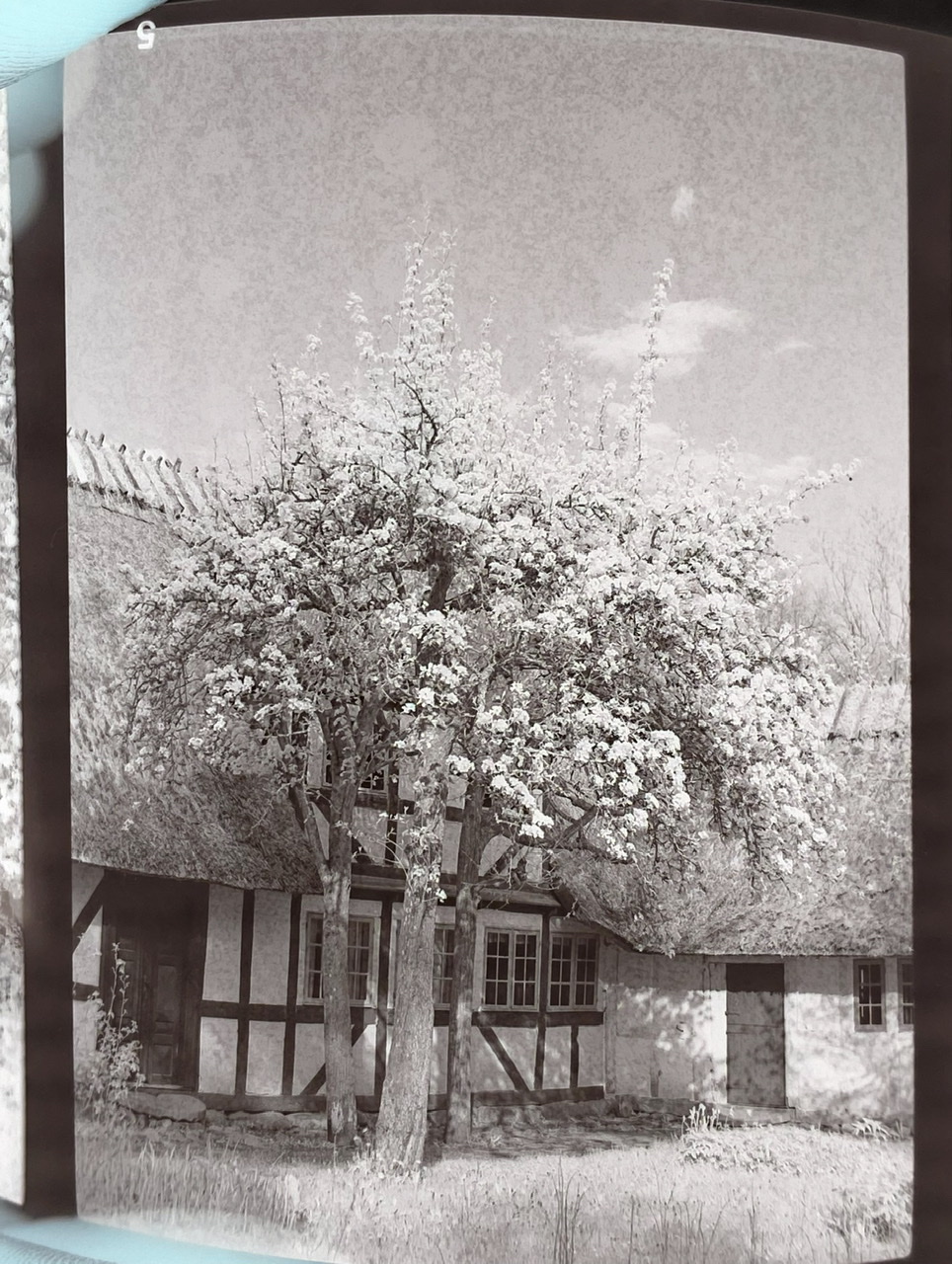

Just a quick snap of a frame straight from the tank where the effect is quite evident in the sky above the house.
There is very visible countdown print from the backing paper, and then there is the mottled texture, which seems to be of the same kind and nature as the print-through.
I'm using Adostab for final wash and D-76 1:1. But I can't fathom how that would result in what I'm seeing
It's a red window folder, but the effect seems to be about the same overall on all the frames, only masked by the image structure.
And it's not more intense in the middle of the frame, which would be the case if it was light contamination from the red window.
Is this something other people have noticed?
What could be the cause?
The particular roll had a couple of months back to expiration, but I didn't want to make a fuss about it in then store. Could age be the cause?
Non of my 135 Rollei or Adox seems to be affected.
Could it be the confectioner? Retro 80s I'm told is rolled by Foma and some of the other "Rollei" Aviphot film is rolled by Ilford.
Could that be the cause?

Your film got wet before it was shot. I've had it happen twice now, first time with a roll of svema and again with a roll of holga 400.
Helge
Helge
Jun 27, 2018
3,938
Denmark
Then it happened at the factory or by condensation during transport.
Storage in the fridge can’t possibly result in that kind of pervasive and homogenous humidity.
The film is rather well packed, so it’s hard to imagine how it would happen.

Retro 80s is notorious for this. Back when I tried it, the film was packed in a plastic box but no sealed wrapper, which likely contributes to moisture problems. In any case, you're not the first to run into this and probably not the last either.
laingsoft
Apr 30, 2020
187
Edmonton
Any idea of how to prevent or avoid it?
I suppose you could physically go to the factory and grab the rolls hot off the confectioning machine :smile:
In my case, I started putting my rolls in ziplock bags, then putting the bags in the fridge. In my case it was caused from condensation on the inside of my fridge though. You could probably throw a few silica gel packs in there for good measure.

The dots are the telltale signs of print-through from the paper. If you look closely you might also be able to make out the frame numbers. I've only encountered this with Shanghai GP3 (years ago); my solution was to stop using it. I think this happened to Kodak a few years back, and they solved it by using a different ink to print the backing. In any case, a little humidity should not be enough to cause this kind of print-through. At the very least ask for your money back or an exchange.
Helge
Helge
Jun 27, 2018
3,938
Denmark
Yeah, it’s most definitely print-through from the paper. The texture is probably the paper structure too.
Problem is, I really, really like the film.
It’s absolutely superb for a lot of things. And it appears to be the only game in town in 120.
The 200 - 400 varieties are good too, but not as extremely fine grained and high resolution.
Is there any other confectioning of it?
Does age and or production badge have any bearing on it?
Is the condensation theory tested/verified? I find it hard to believe.

It seems to be a problem at Foma factory. The 135 films are converted and packaged by Harman and the 120 films by Foma.
I have twenty of those films. The seller don't want to take them back (Retro Camera Belgium).
You could try RPX 25, it's the same film (Agfa-Gevaert Aviphot 80 PE1) and both formats are packaged by Harman.

I concur it is a backing paper issue....or at least the backing paper interacting with the film. You can see the dots leading up to the frame numbers. I wouldn't discount the fridge theory depending on how well the films were sealed at the factory. Roll films are usually sealed in a metallic wrapper with inert gas inside to prevent condensation. If the process isn't perfect or if the seal is broken then condensation *will* happen in a fridge, which is a very humid environment.
Either way it's bad luck. I've seen this with Retro 80 reported a lot in here. I haven't used that film but I've shot a fair amount of Retro 400 without any issues other than one single frame had spots missing in the emulsion. I don't believe this was user error but it's possible.

Had similar results with a couple of expired rolls of Rollei Retro 80s as well, though not as bad as Helge's
Mottled 80s in a Weltax.
So you mean that different films from same manufacturer may react differently on same backing paper under same circumstances?
Actually Harman's statement on their mottling issue gives a hint in this direction.

I had this same issue with all the rollei retro/ superpan films in 120. 35mm and sheet film had no problems. maco told me to get lost and learn how to properly develop film, so I gave up shooting them. too bad as they are nice emulsions with a different look because of the extended red capabilities. shoot the 35mm and develop a lot as slides. the clear base makes for nice projection.
AgX
Apr 5, 2007
29,990
Germany
Yes, a good offer but, but really weird people. I made even worse experiences back when they started their web shop and never ever was served by them. But I kept on hinting at their products (and their faulty descriptions) nonetheless, just because their unique range of films. And as seemingly others did not make such bad experience wth them as we did.

You should have had them explain to you how development can get backing paper texture and symbols onto the film.
It very visibly the naked emulsion touching the next layer in the roll, and not anything like exposure from the back.
The numbers and dots don’t line up.
It is so clearly a manufacturing, and/or storage problem, that they not only should be embarrassed to say such nonsense as a company selling film, but should be called out on it to a far larger degree, than seems to be the case.
Feel free to post the email correspondence here.

Hello Helge,
I’m curious how do you know it’s cut and rolled by Harman?
that is the easiest thing to recognize: Each 120 manufacturer has his own, very specific/individual 120 confectioning/converting. Spools, backing paper, lettering, end seals, additional features (especially Fujifilms superior easy loading system, easy end seal and unique barcode system) are all very different.
Therefore you can easily see whether a 120 film is converted by Kodak, Ilford, Fujifilm, Foma, ADOX or Shanghai.
Adox has 135 well covered with HR-50.
Perhaps they should think about doing a 120 version too?
ADOX is working on generally bringing 120 format back, and then in improved quality. I've talked to their engineers at my last factory visit there.
When they will have finished their work (which will still take some time), also HR-50 and SCALA 50 will be available in 120.
The Aviphot Pan 400 is not listed on the Agfa site (it did exist at some point). Isn’t it just 200 optimistically rated?
1) The Wikipedia list has some mistakes: Aviphot Pan 400 is long gone. Last coating run was in 2008. In 2013 the last film of it left Agfa and Agfa listed it on their homepage as discontinued. And some time later also this discontinuation notice vanished.
2) Yes ISO 200/24° is too optimistic if you want real shadow detail and refer to the ISO norm. Agfa's aerial films are measured at Zone III instead of Zone I for light sensitivity/speed. So if you want sufficient shadow detail, you have to give them about two stops more light.
Best regards,
Henning
