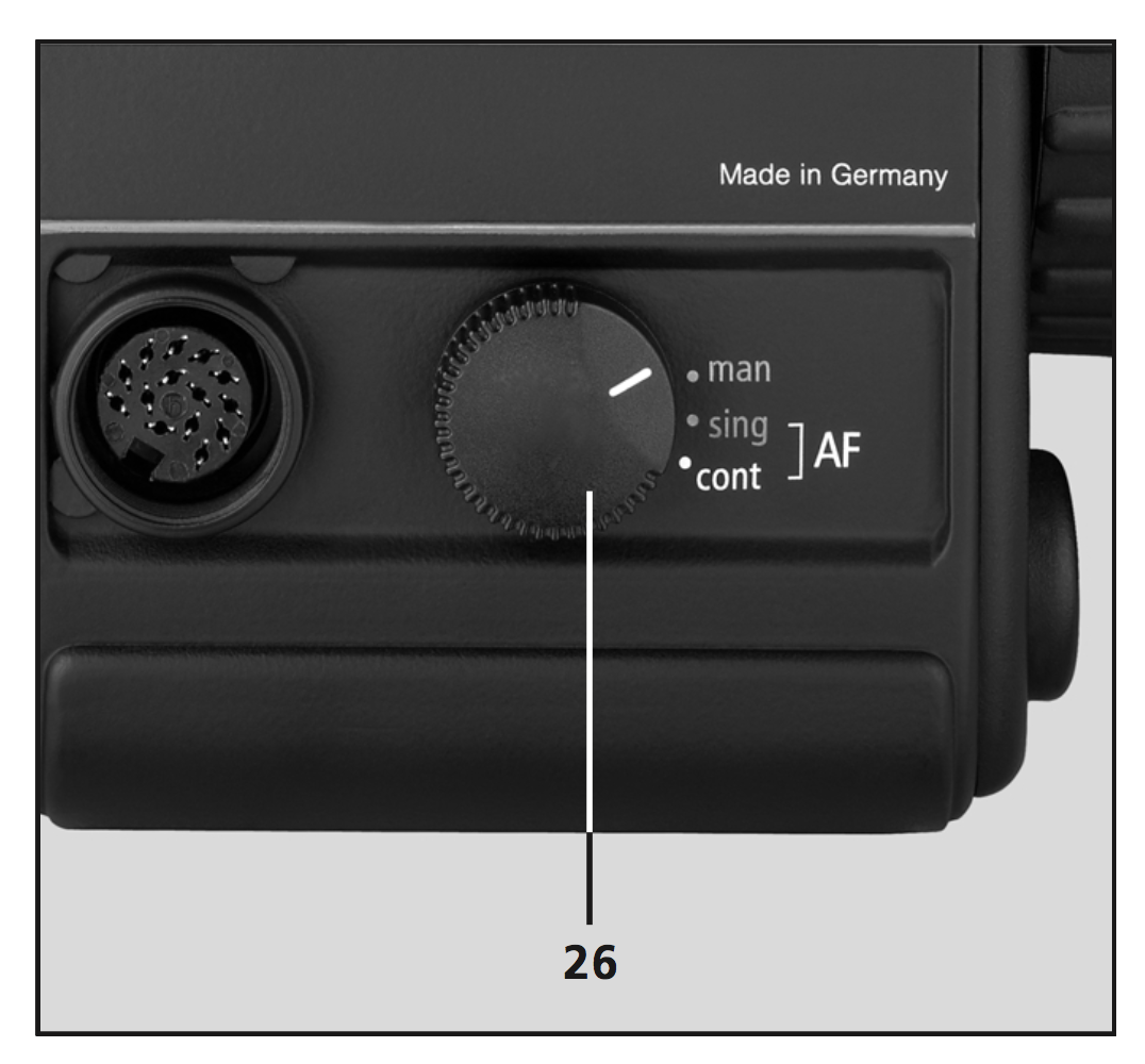

I started using a Rolleiflex SLX in the mid 1980s and a knob like this on a camera that is a continuation of the SLX line, was science fiction.

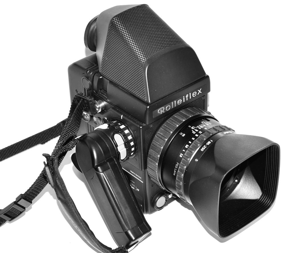

The AF lens I got for the camera is an 80mm/2.8 Xenotar AF PQS. So it has shutter speeds up to 1/1000 and has an aperture ring (unlike the 80mm AFD lens)

The lens looks like lenses that would fit the older SLX and 6006 but there is a warning on the lens not to use it on those older cameras.
It does, however, work fine on the newer Hy6.

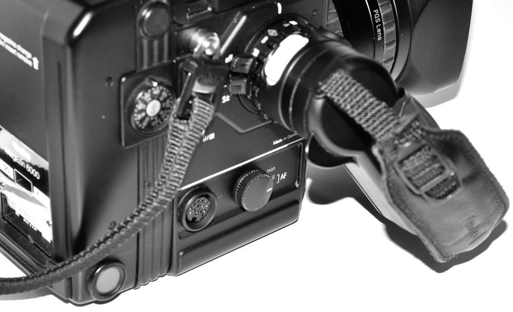

The form of the 6008AF is very similar to the other 6008 models. The main differentiating control is the AF knob on the right side.

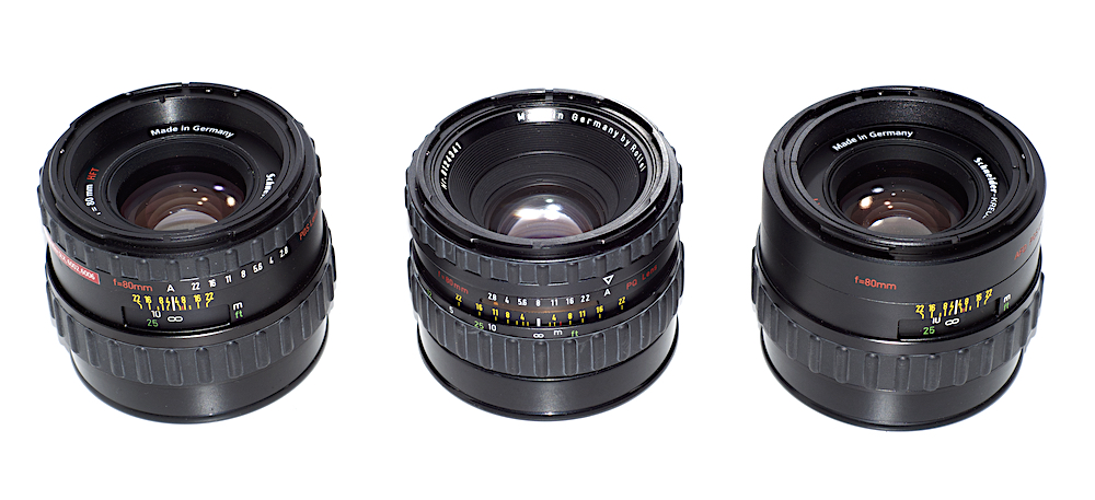

Comparison of three 80mm lenses. I also had the older SLX 80mm lens but sold it with the SLX quite a few years ago.
Right to Left:
80mm f2.8 Xenotar AF PQS (6008, 6008AF, Hy6)
80mm f2.8 Planar PQ (SLX, 6006, 6008, 6008AF, Hy6)
80mm f2.8 Xenotar AFD PQS (no aperture ring for Hy6 only).
Not shown is the current 80mm lens for the Rollei system; the 80mm f2.8 Apogon AFD. It is nearly identical to the Xenotar AFD.
