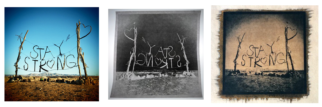

This is a digital capture, inverted in PS, printed with a $50 laser printer on regular paper, waxed with paraffin, toned cyanotype made on higher quality paper. I did have some banding with the economy laser printer but they gave a better final print than negatives made with a high quality inkjet printer. I say try it...
It's looks amazing.

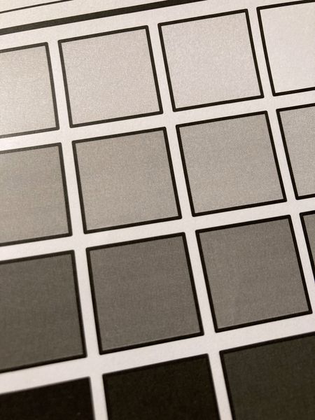

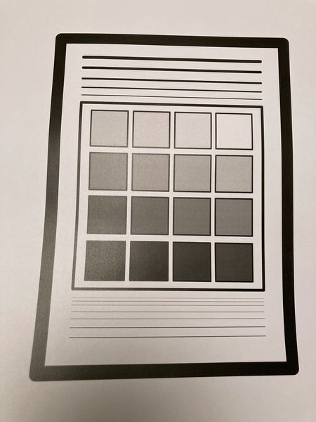

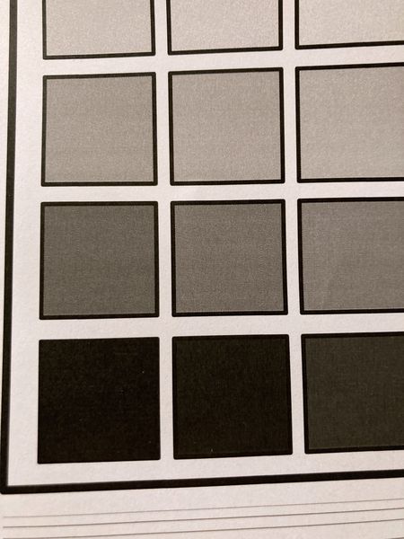

Got my color laser (cost 170 euros = 201 USD). Here is my self-made calibration sheet printed ready for testing. I tweaked the printer settings a bit and the dithering got better. Altough it is visible still, I think it is quite nice. I will print tests tomorrow to see how it transfer to RC paper.
Off-topic but I tested color + B/W printing too, I'm pretty blown away of the quality. I was really skeptical of the outcome but I could actually frame some of those prints :O
