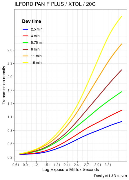

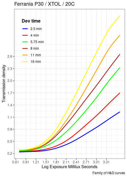

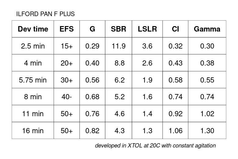

I started a project testing slow B&W films. To begin with, I chose the Ferrania P30 and ILFORD PAN F Plus. If you are interested in a particular slow film (ISO 50 or lower), please let me know. I will try to add it to the list.
I enjoyed working with both films. The PAN F Plus was a typical, nearly flawless Ilford product, but the Ferrania P30 surprised me. It comes beautifully packaged, in well-made boxes and high-quality cassettes. Additionally, each roll comes with a unique QR code. Ferrania says that "From now on, every roll of film we produce will come with a QR code that links to a secure database, making every roll completely unique!" More on this on the company's blog. Whether it is a useful feature or a gimmick, remains to be seen. Still, it's a novel idea in the film market. The film seems like a terrific product, at least superficially. Ferrania might have had some problems getting the project off the ground, but the company has remained fairly transparent about their process and engaged with the community.
Judging by the information provided by the manufacturers, Ferrania P30 and ILFORD PAN F Plus should have similar speed and, possibly, other characteristics. Let's see how they perform.

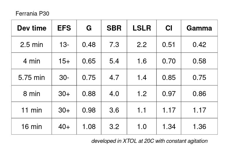

I ran my usual six-curve family test of the two films, targeting ISO 50 exposure. I processed the samples in XTOL (stock) for 2.5, 4, 5:45, 8, 11, and 16 minutes at 20C in a Jobo 1510 tank. I have detailed test reports available as twelve-page PDF documents, so please, let me know if you'd like me to upload it.
For now, let's look at the curve families and analysis summaries. In terms of film speed, the Ilford film is close to the ISO 50 box speed, but the Ferrania P30 appears to be much slower than the manufacturer's recommended EI 80, at around ISO 15. The speed discrepancy did not surprise me, but the response to development did. Ferrania needs very careful processing. In Kodak XTOL, the film needs less than 4 minutes of development at 20C to give "normal" contrast. I would not recommend using stock XTOL or D76 with this film, unless one wants a high-contrast negative. I think a low-contrast developer or a dilute standard developer are probably better choices, otherwise, you're running the risk of producing negatives that might be hard to print or scan.

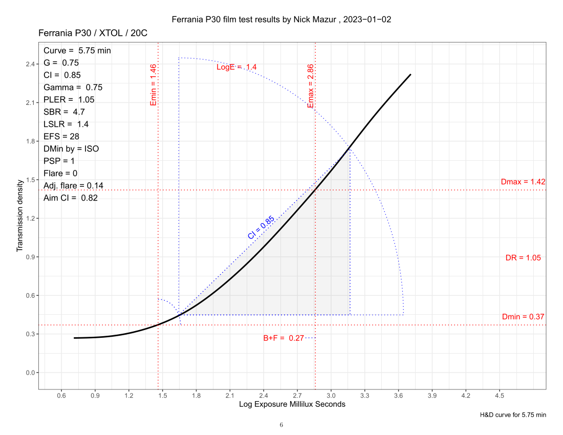

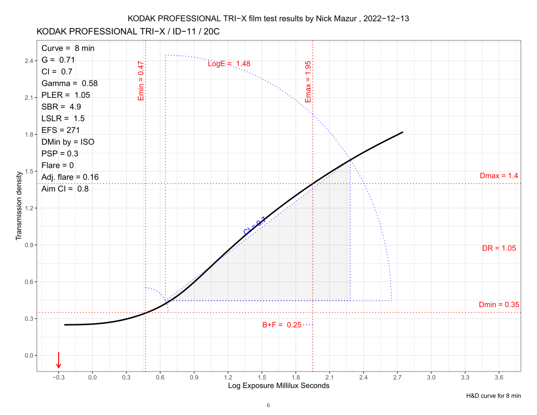

aparat, for what it is worth in terms of a comparison with your tests here's the Greg Davis video on P30
pentaxuser
aparat
aparat
Sep 5, 2007
1,177
Saint Paul,
pentaxuser
Thank you! That is a fantastic video. He got the same overall curve shape, but the way the TRI-X and P30 curves are shown highlights the differences in shape, rather than relative position along the log-E axis. It's a very interesting test. Here are my P30 and TRI-X curves in isolation for comparison:
ferraniaP30Plots.pdfabsolute_finalP6.png 400TX_ID11Plots.pdfabsolute_finalP6.png

Thanks for posting this. It supports my entirely empirical experience that P30 is nowhere near ISO 80. I wasn’t going crazy!
I figured my best results were around 15-30 depending on lighting, and still haven’t worked out development to prevent excessive highlight density.
When P30 works it is very nice, and certainly unique, but definitely not flexible in the ways we’ve gotten used to with other films.
PanF+ has been much more predictable. I should use it more often.

Thank you very much for your detailed test. Again very good work, highly appreciated.
As someone who used and tested both films intensively as well, I can confirm your results. I just want to make some additions:
Ilford PanF+:
Old "trusty workhorse", I have used it a lot in the past. And really loved it! The only reason I've switched after several years of regular use was that Ilford with Delta 100 introduced a new film which has been even better for my personal needs:
In direct comparison Delta 100 delivers even higher resolution and better sharpness. And that at about a stop higher light sensitivity.
These advantages were the reasons for me to switch from PanF+ to Delta 100.
PanF+ has the advantage of a bit finer grain compared to Delta 100. But as Delta's very fine grain is really fine enough for me (and for big enlargements from 35mm negatives), Delta's overall performance matched my needs.
Film Ferrania P30:
I've tested it intensively in several developers, different dilutions, with diffuse pre-exposore etc., but no matter what I've tried, the result has never been really convincing.
Like you I had to go down with the real film speed / EI below ISO 16/13° (!) to get shadow detail, but then with most developers I had also to go down with development time below 4 minutes, which makes processing precision more difficult.
And the curve shape has also not been optimal, and significantly worse to other low and medium speed films.
And if you are working with higher EIs trying to get standard density at Zone V, you'll loose shadow detail and get too high densities in the highlights (blown out highlights).
Offering this film as an ASA 80 film is really completely misleading. And compared to other films in the ISO 50/18° to 100/21° speed range like for example ADOX HR-50, Ilford PanF+, Ilford Delta 100, Fujifilm Neopan Across II or T-Max 100, Film Ferrania P30 is not offering any advantage. But has the severe disadvantages of a very problematic cc shape / tonality, much too low real film speed and higher price.
P30 unfortunately is not really a competitive product. I hope Film Ferrania can introduce much better film(s) in the future. I know the staff there, very nice guys, I've visited the factory. They are really dedicated to film and hard working. And I wish them success.

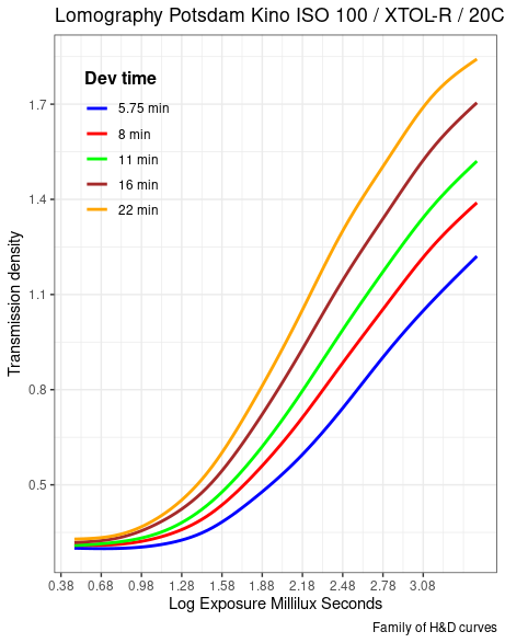

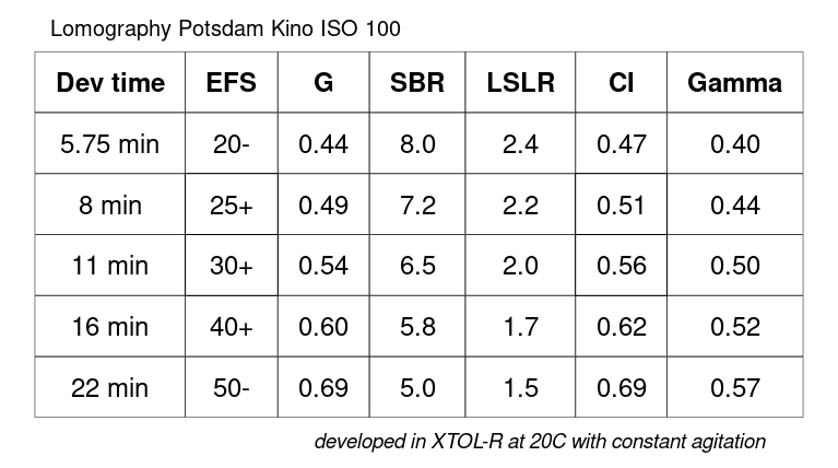

Here's another interesting slow film, the Lomography Potsdam Kino 100. It is supposedly ORWO UN 54. Like the Ferrania P30, it is a cine film, but unlike the P30, it seems to be inherently a low-contrast film, needing a long-ish development time in XTOL to reach the "normal" CI of 0.5-0.6.
In my test, the Potsdam Kino 100 is approximately ISO 45, so close to the ILFORD PAN F Plus but with a different tonality.
