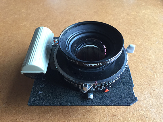

Hallo all,
I found the solution.
As I needed 4,5 V to operate this shutter, I thought that 3x1,5V might do.
So I Googled for a battery holder for 3 batteries, and found something on Amazon.de.
It was an offer for a set of 5 little holders with a switch built in for less than € 10,-, which took about 4 days to be delivered.
With some phantasy and fiddling, it doesn't look that 'pretty', but it works as a good as could be, see the picture.
I opted for rechargeable AAA batteries as they have only 1,2V but a lot of Ampères, perhaps to much, and I was afraid to burn the electromagnetic resistors in the shutter mechanism.
What do you think?
The only thing I have to figure out is hou to attach that battery holder to the camera (a Linhof Kardan GT 4"x5"), right now I use a rubber band...
A ruber band sounds like a good approach, if there is an easy piece to attach to. Slighly more pemanant would be to use velcro somewhere. I assume you might change out the lens for another at times, and if those lenses don't need the battery, I'd definitly want to quick to attach and quick to remove.

This is a good way to verify if the shutter works. A frequent seller on the 'Bay listed a 240mm lens in one of these shutters for months. I wrote her several times and could not get her to expend even a calorie on connecting some 1.5 volt batteries to test the shutter. Odd, as if she really didn't want to sell it.
The shutter works good, I can't check the speed accuracy, but I will assume that's allright.
According to a technician of Linhof I mailed with, these shutters are rather robust. Linhof used them in their Aerotechnika camera's and at a power of 6 V!
As aero camera's have to undergo an intensive use, heavy environmental changes like pressure and temperatures, and vibrations, I am confident.
The main reason I want to keep this shutter running are the long exposure times, this one goes till 32 sec.
