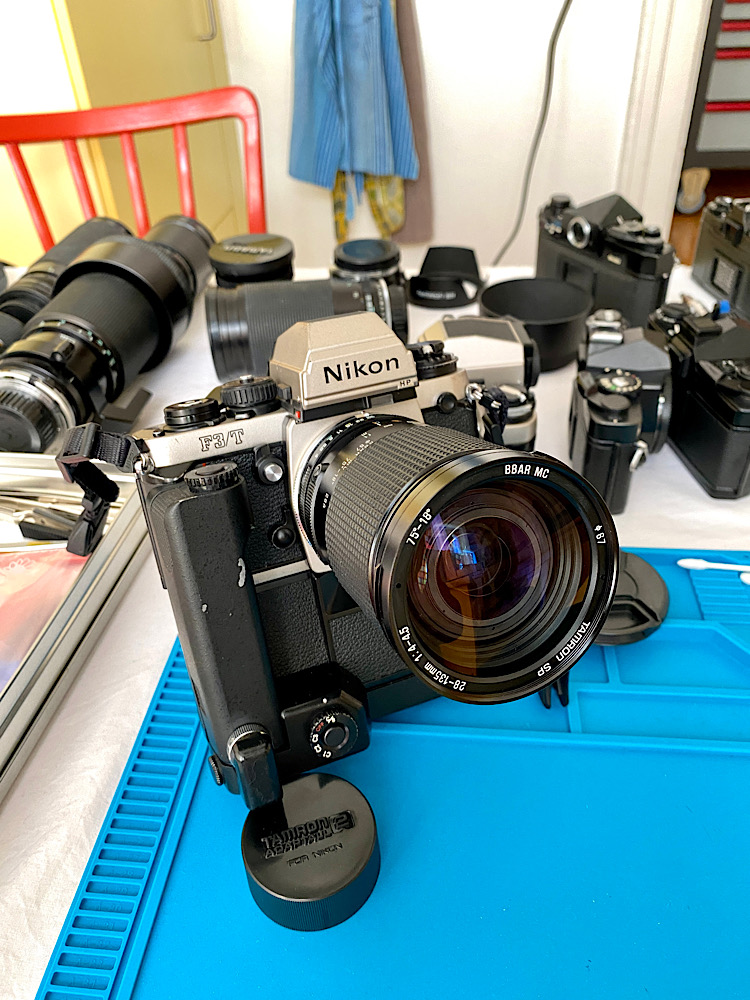

I noticed it on my first trip with the zoom: the smallest aperture of 32 was not formed on my Nikon F3/T.
It didn't close or open completely, but the next smaller 22 did without any problems.

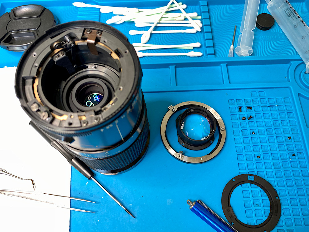

Grab a screwdriver

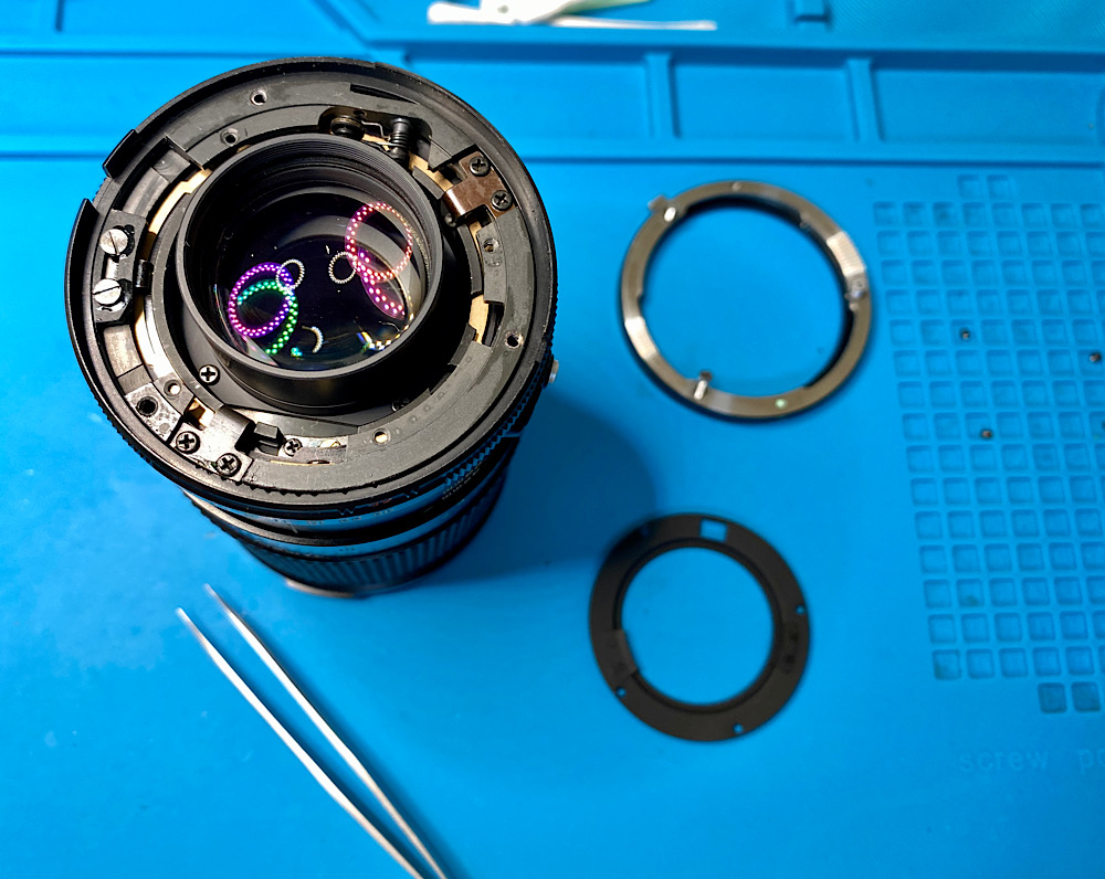

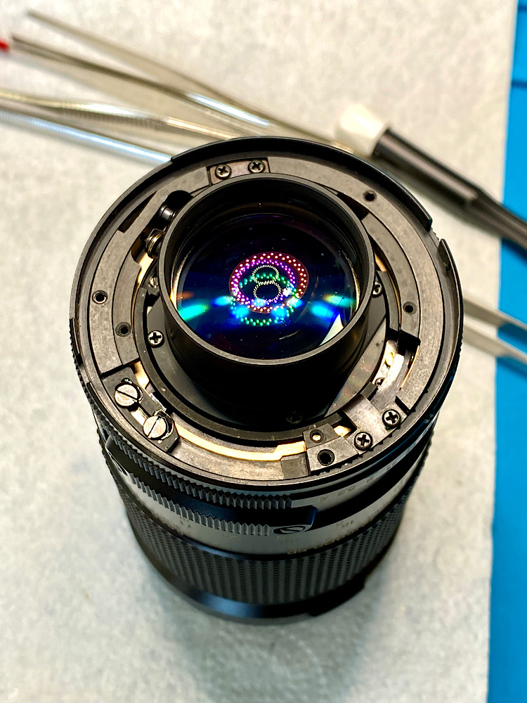

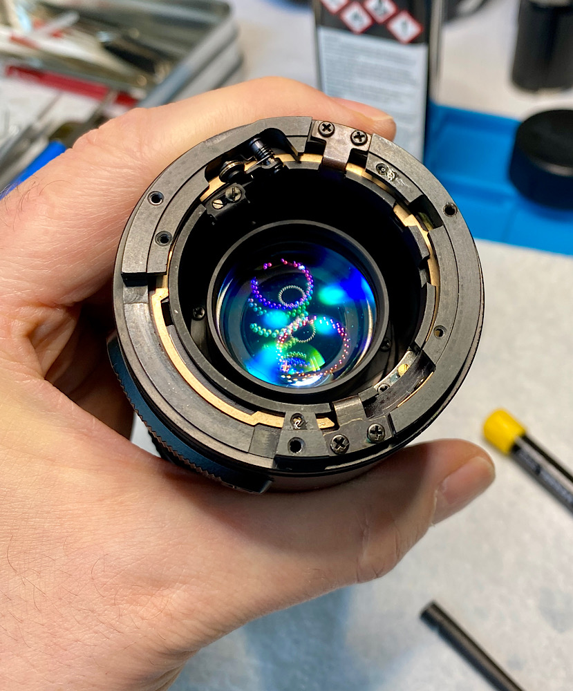

To access the aperture mechanism, I dismantled the lens from the back.
The place has been reached.

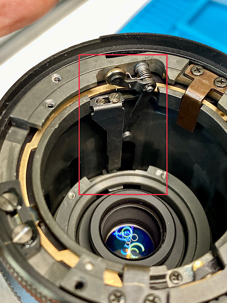

The marking shows on the left the lever that transfers the set aperture value to the aperture register.
The lever on the right closes the aperture when you press its small wheel. The Adaptall-2 adapter is connected to it.
I removed the left lever and after a few tries I was able to put it back in correctly.
And that solved the problem instantly, the aperture now worked as it should
Perhaps the position of the lever, which is attached and adjusted with two screws, was no longer correct. Or had dirt actually come loose?
I don't know it.
Adjustment of the aperture
When screwing the lever tight, I set the aperture to the largest to be able to align the aperture blades. If they disappear in the aperture register when the zoom is extended, it is correct.
In the retracted position they protrude slightly - this is achieved using a control cam to adjust the aperture to the set focal length.

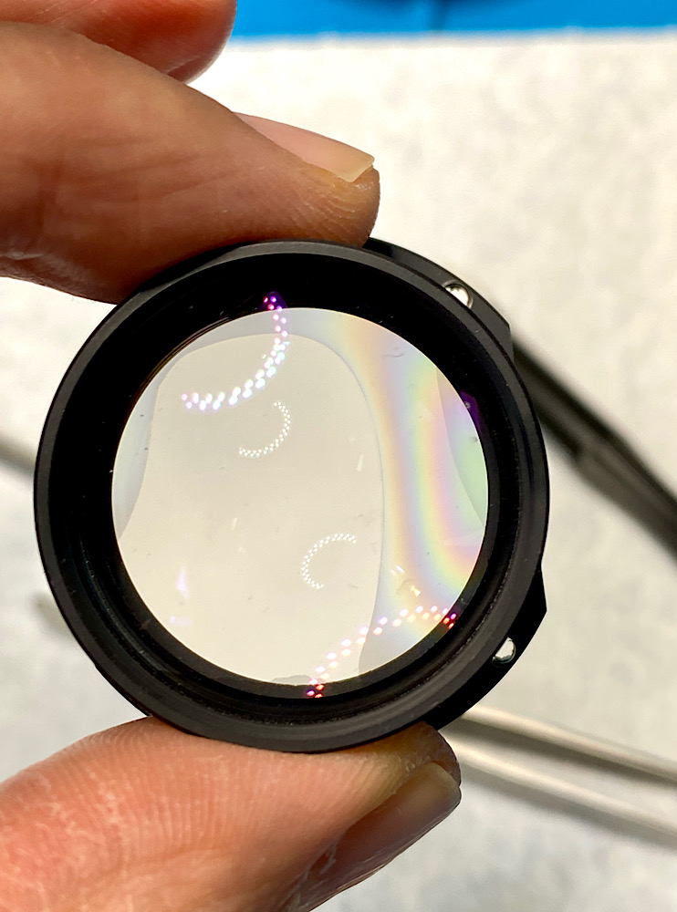

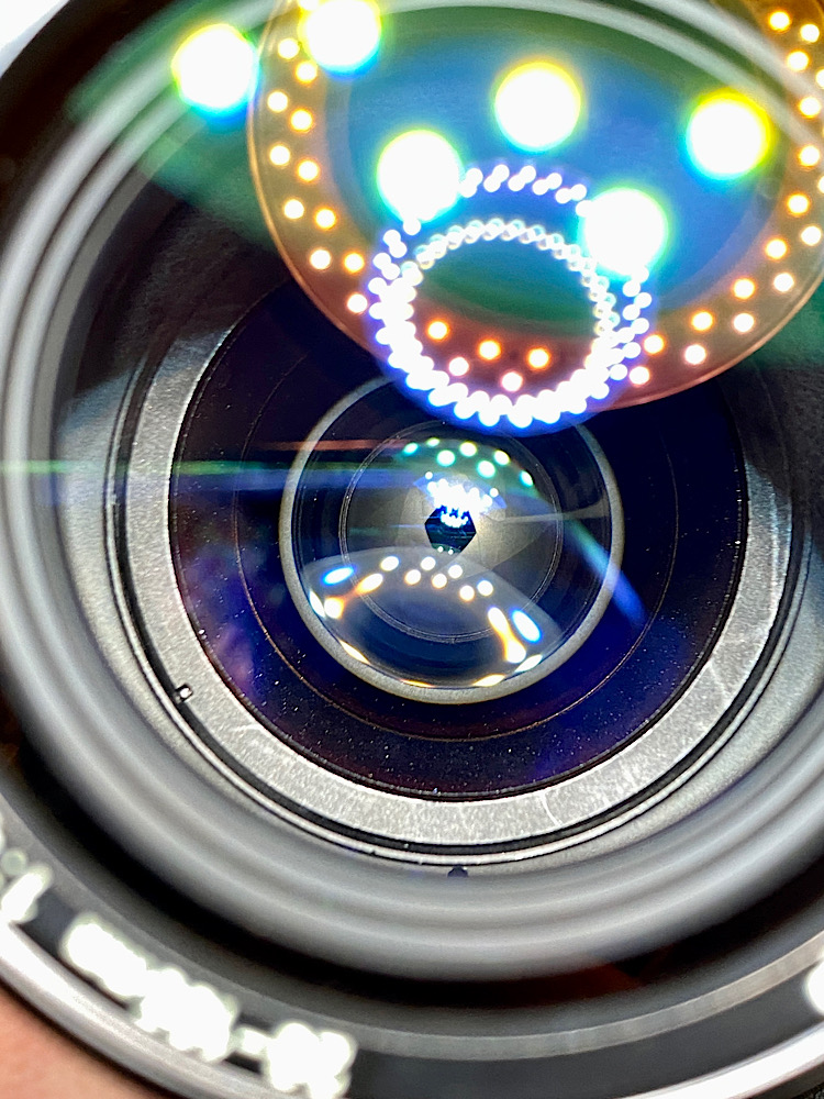

While looking at the rear optical unit, I noticed these neat artifacts.
It could be lens separation. Or the cement is not even.
There is no order for me.
This could be repaired by Optik-Labor in Germany, but the costs do not bear any reasonable relation to the market value of the lens.
In any case, I didn't notice anything disturbing in the last photos I took with the lens.

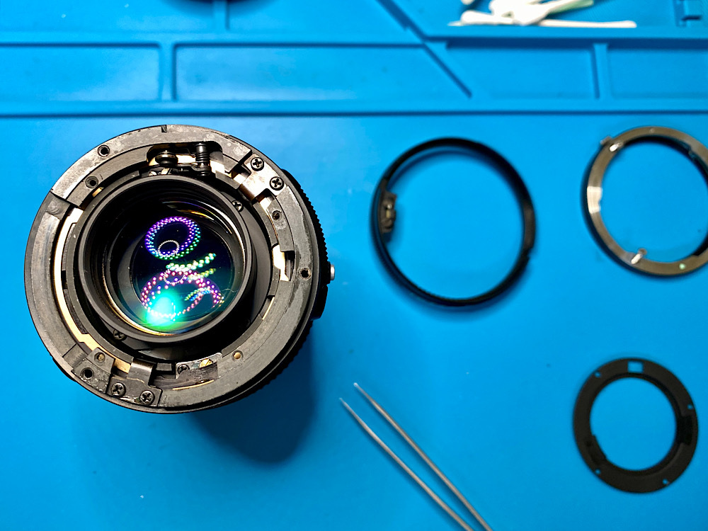

Assembly

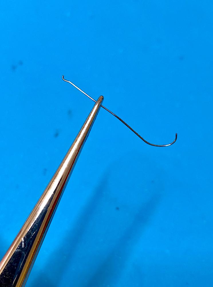

This spring came loose from the aperture mechanism when the aperture ring was moved, namely below the bayonet. The ring jammed and one end peeked out. I couldn't figure out where the spring was inserted.
Of course that's not fine, but I didn't notice any functional impairment after removing it.
So it stays outside and hopefully everything stays peaceful in the lens.
The service manual would have been helpful here to determine the position and function of the spring. But unfortunately I don't have it.
Aperture 32 now fully functional.
I don't know it.
