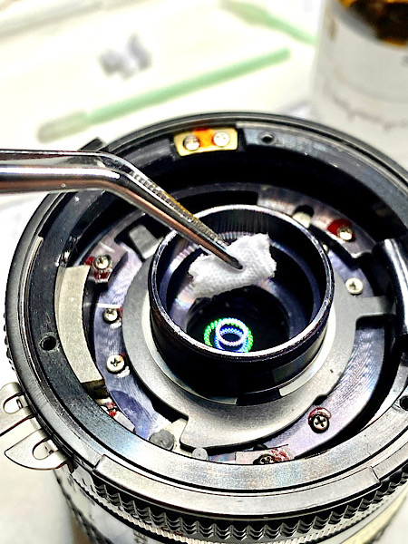

I have tried many things when cleaning lenses and other optical glass, but no matter which method I use, streaks always remain.
These then have to be removed in another cleaning process.
If it works.
Annoying streaks to be removed
What so far works best for me is
  • blowing off with the bellows,
  • cleaning brush,
  • blowing off,
  • isopropyl alcohol on a lens cleaning cloth to remove greasy residues and then
  • removing the streaks with a cleaning cloth moistened with a trace of Aqua Purificata. This way the cloth does not glide dry over the glass, which prevents any scratches.
How do you proceed?

I find the streaks come from grease & oil trapped between the lens and the retaining ring (or other metal hardware). If the cleaning tissue touches the periphery then the oil wicks onto the tissue and streaks across the lens. As oil is already on the tissue the more I try to wipe it off the worse the streaking. I often just put up with a small amount of streaking - better than damaging the lens.

Keep the tweezers tip clean as much as possible. Sometimes it is from the previous cleaning, the oil has been carried over by the tip to the next lens cleaning paper.
And I tend to do cleaning slow with alcohol, from the center going circular towards outside, and once it reaches the edge, I discard this tissue paper and get a new one to start from the center again.

With the rounded ends of the tweezers you have to try very hard damaging the lens.
I recommend just trying things out, with a little caution nothing can happen.
I have tried the methods I show here several times.
