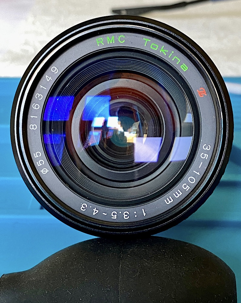

Here I have a Tokina 35-105 on my table:
The overall condition is excellent, only the aperture blades lacked the necessary jaggedness when closing.
The examination revealed that the aperture blades were dry.
However, I couldn't see the entire aperture register because the aperture blades are only partially visible from the outside through the tube.
Oil in the background?
I suspected an oil contamination problem and wondered what I could do.

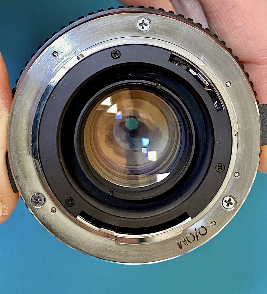

All I had to do was remove the rear lenses and access one side of the aperture blades.
Apply Zippo lighter Fluid several times with a cotton swab to the aperture blades, move vigorously and dry with warm air.
Now the aperture snaps back into place as expected.

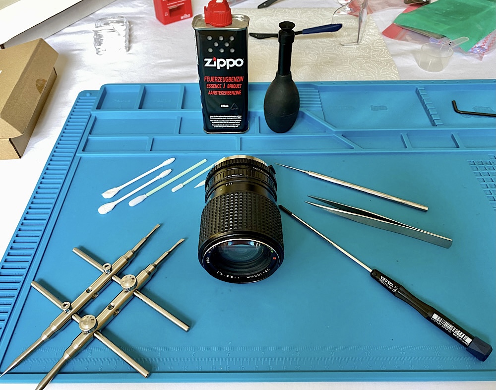

It doesn't take much - all the tools you purchase remain for future projects:
- a spanner wrench for loosening retaining rings
- cotton/cleaning swabs
- a JIS (Japan Industry Standard) screwdriver for recessed head screws, size 0
- a pair of tweezers
- a probe for moving small, difficult-to-reach parts, for example in the lens barrel.
- lighter fluid
- a lens sucker for holding lenses, ideal with different sized attachments.

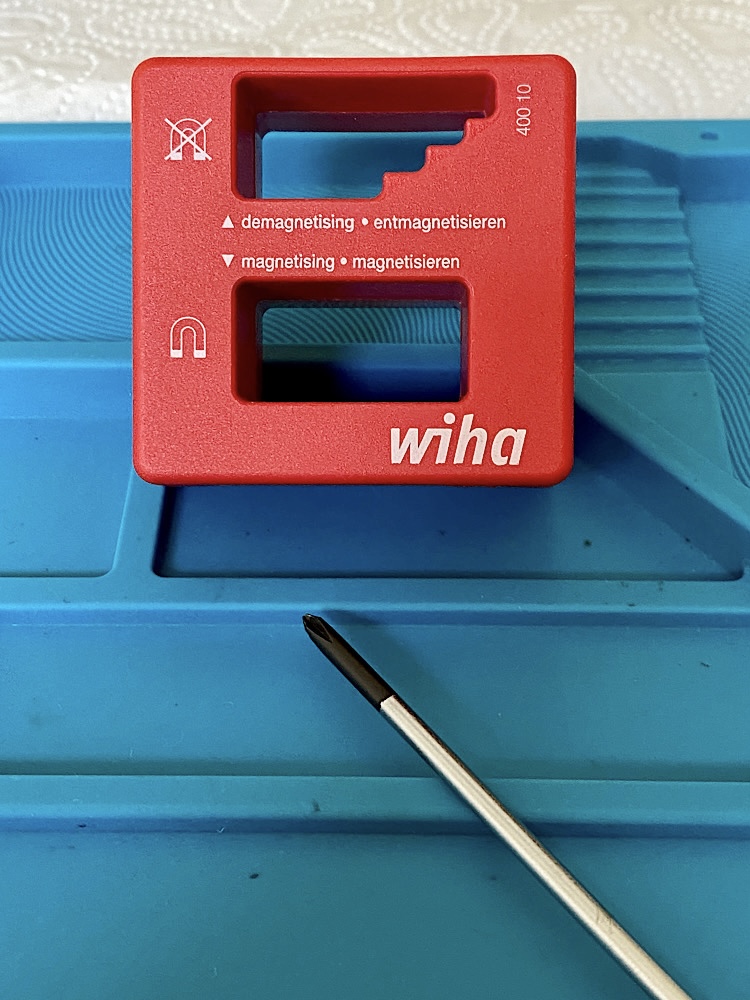

Actually indispensable:
A magnetizer/demagnetizer - this is how screwdrivers become masters of small metal screws
