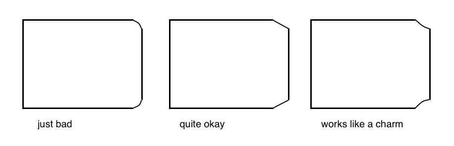

I usually trim the edges of my 120 films before loading them into my Jobo 1520 tank. Over the time I tried various ways to do so because these plastic reels can be really finicky and it occasionally happens that the film gets stuck. I did cut the edges straight for a long time since that´s what I thought would work best. Recently I experimented with curved cuts using a nail scissor and to my surprise that last cut depicted below worked perfectly. How do you trim your film edges?
Yes, I clip the edges at about 45 degreesjust slightly to eliminate the sharp corner on which the film could get caught sometimes, but having film and spool perfectly dry is a higher priority and getting nervous about it does not help.if it doesn't work right away,I try to calm down, pull the film out and start over;wrinkled film doesn't work at all.:sad:

OP, I use JOBO reels as well and they do catch all the time. I am too lazy to clip the edges which is the smart thing to do to avoid it. I can usually find the catch with a finger or just jiggle the reel a bit. Most of the time it catches at the thin cutout part of the reel and you can feel the film offset there and pinch it. To load the film, I don't use the wind method but the push method. I simply push the film on the reels. You need to keep the reels clean to do that but it is incredibly fast. Once the film is started, I offset the sides so the spines don't line up. It helps a lot. With 120, once I get the film on the reel I hold the film then spin the reel to get the first roll all the way to the core so I can load a second roll on the reel. This is all easier done than described. I have been loading them so long that it is all automatic and I don't even think about it anymore.

Never used Jobo reels before. Are they the same design as Paterson? Like Ralph, I always give a little 45 degree snip and never had any problems loading Paterson reels after doing so.

I do the same with my Jobo reels and tank, however I've couple of steel reels that I don't use them (simply because I prefer the Jobo) but I practiced loading film on them and I found out that I don't need to trim the film with the steel reels.

Clipping the corners have made loading up on plastic reels super easy. I actually make a point of when I rewind the film I leave a tail hanging out so I can do the trim in the light then into the bag.

I use Jobo reels and I give a small clip to the corners about 45 degrees . I prefer the Jobos to the Pattersons because they don't have the stainless steel ball .... which I've found to be unnecessary.
I always heat the reel a bit with a hair dryer immediately before loading. It makes sure the reel is absolutely dry and it seems to make the film slide in the reel more easily ............ more slippery some how .........

I switched all my 120 processing to Jobo reels in 2001. I found that trimming the corners makes the film more likely to come out of the groove. In the last 3 or 4 years I have been turning the film around and loading the end with a perfect 90 cut on to the reel. I have always cut the tape-to-paper end, rather than peeling the tape. I can't get the cut exactly 90 degrees and thought that was making it hold-up in the reel.
The other thing I have noticed recently is that I can push a 120 roll of TMAX (with its thick base) all the way to the center with no twisting sometimes. I always load two films to a reel and use the red tab.

I have to try this, but normally I just cut a 45 degree angle and it works fine on Paterson reels.

I clipped the edges for years w/ 120. It works OK, but it makes it hard for my fingers to find out where the film edge actually is when starting to load it on the reel when it's all inside the change bag. Now I bend the film back against the curl the first few inches or so, and it works better. I found that it wasn't necessarily the edges that were the problem, it was the curl (especially w/ films like Shanghai GP3 that are really curly).
