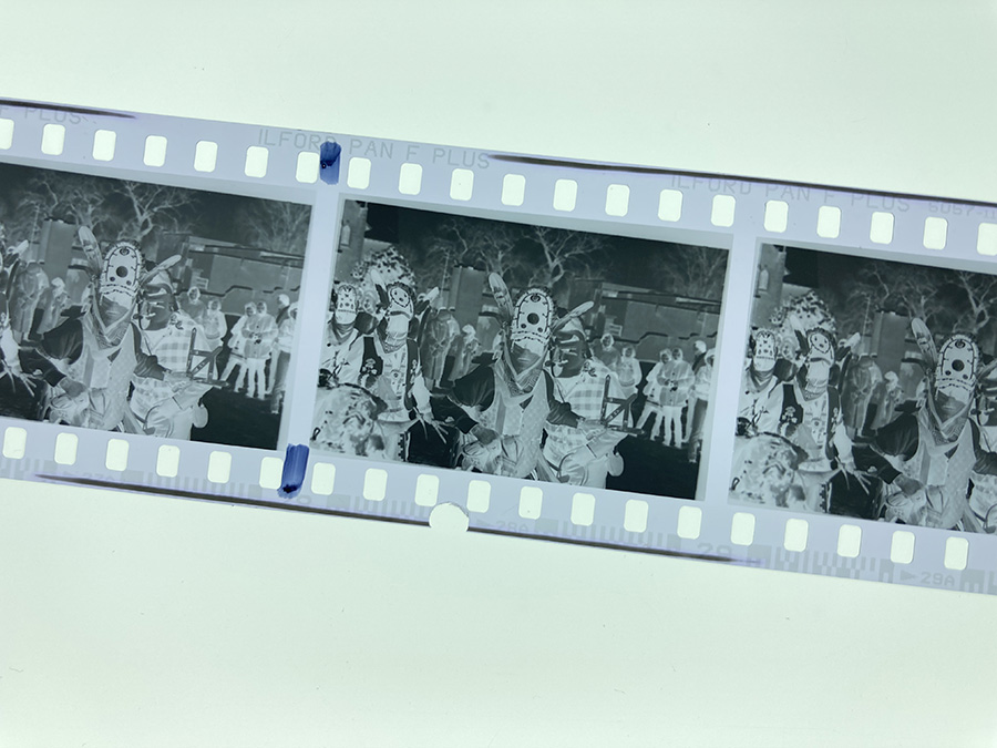

I'm copying with a slide copier to PanF processed in D-76 1:1, 7 min @68degrees
Printing on MGFB Ilford. Image is printed #2 contrast, with the highlites burned with a 00. The left side was dodged some...
I know a 4x5 interneg might be better, but I'm not set up for 4x5 film.
I chose this image for a test because of the bright snow and dark reds and blacks in their outfits.
What could I have done differently to make the print better?

I think you're doing great. The print is punchy, ao is the negative. In case you want to subdue it, you could work on contrast control of the internegative, but of course you could also do the usual burning, dodging and flashing while printing. Not that I feel you must do any of this - I quite like what you got.

Thanks! I was Photo editor and head photographer at a newspaper in Santa Fe New Mexico in the 70s-90s. Now the Museum of New Mexico wants ALL my work. I've been making B&W prints for them for a couple of years and I'm experimenting with B&W from some of my color slides. I have a You Tube channel that you can look through and see some of the stuff I'm doing as well as a bunch of videos on setting up my darkroom and my 'process'. https://www.youtube.com/channel/UCvTm7EIbd4gh-hctrz-UBeQ
As far as contrast control I've been experimenting with the 'interneg' development times. I've lived in HP5 so the PanF takes a little experimenting.

I agree. You're on track. The problem you have is that while PAN F is a great film, it's also relatively high contrast. An easy way to control this is to over expose it -- ISO 12-25 -- and under-develop it -- 25-50%. This will produce a flatter negative. You could try a lower contrast B&W paper or filter, but a flatter negative will capture more in the slide -- because it's over-exposed. How much exactly to over-expose and under-develop? I'm sure you can handle a little trial & error -- just take good notes.

What I don't understand is how you are getting negs like that with only 7 minutes development. Are you sure dilution/time/temp are correct?

I think I'd use Tmax 100 instead of PanF. Tmax is excellent for copying. You can also experiment using filters on your lens to adjust how the colours come through in terms of contrast. Filters should work the same as they would in the actual world. Not sure what kind of slide copier you're using, so I don't know how filters would fit. If you have a lot of slides to copy, you may want to get an Illumitrans.

I would be cautious with overexposing Pan F. The shoulder sets in early; that would compress the highlights of the slide, while they already (on the slide) have a lower contrast than the dark tones.
That's why you under-develop to avoid blowing out the highlights -- flatten out the curve.

Which will leave the highlights muddy and flat.
Keep in mind that reducing development does not flatten the curve per se.
It works for me and my gear, and it might work in this case as well. Those highlights could use a little "mud".

I lived in Tri-X and HP-5... back when, and since my return I have still yet to try/use T-Max. Maybe now's the time. I do think the internegative gets the tweaking first. I've got a fixed barrel copier that has a lens built into it. It adapts to my Nikon like a normal bayonet lens. I'd have to cut some gells or something so that's not and option. Thx!

Yes sir. Did it myself! ;-) Actually I ran a strip before in straight D-76 and 6;30 time ( I think- Id have to look) and they were too dense so I went 1:1 and pulled 30 sec. Agitation was the same 2 slow inversions every 20 secs. A little less might 'help' but not enough, so that's what I know. I'd not tat well versed in Pan F. I'm more of an HP-5/Tri X kind of guy. I just wanted to try it for the tiny grain. I think trying some other films might be good. I just want to get a 'baseline' so I can adjust from there as necessary. Thx!

Tmax is about as good as you can get for a copying film.
The device I mentioned, a Bowens Illumitran, can probably be found pretty cheaply if you keep on the lookout. It has a macro-bellows built into it, you use a 60mm enlarging lens, it has a built-in flash (you can vary the intensity). Because of the separate lens, you can use filters. Something to keep in mind if you want to copy a lot of slides.
