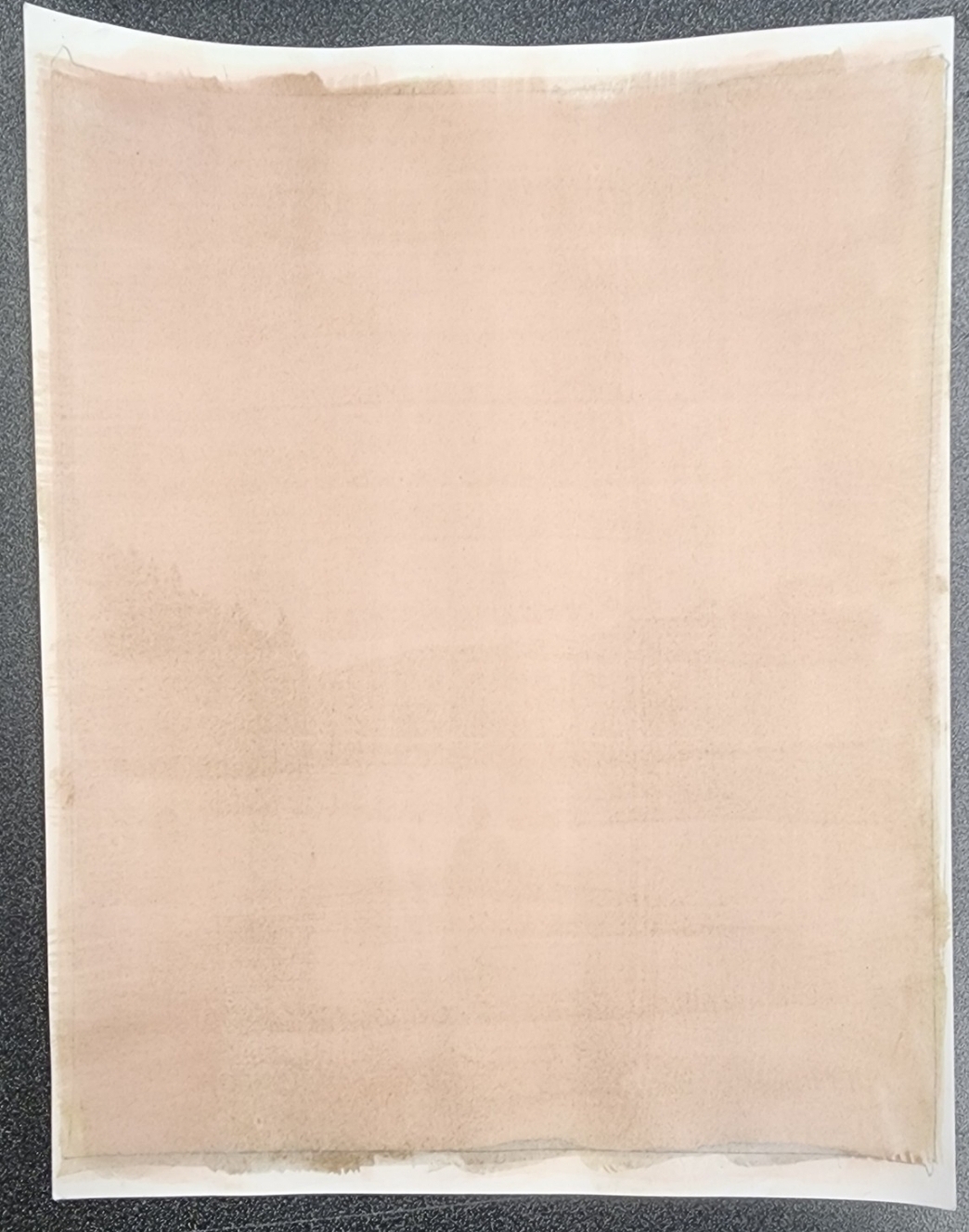

Dry print:

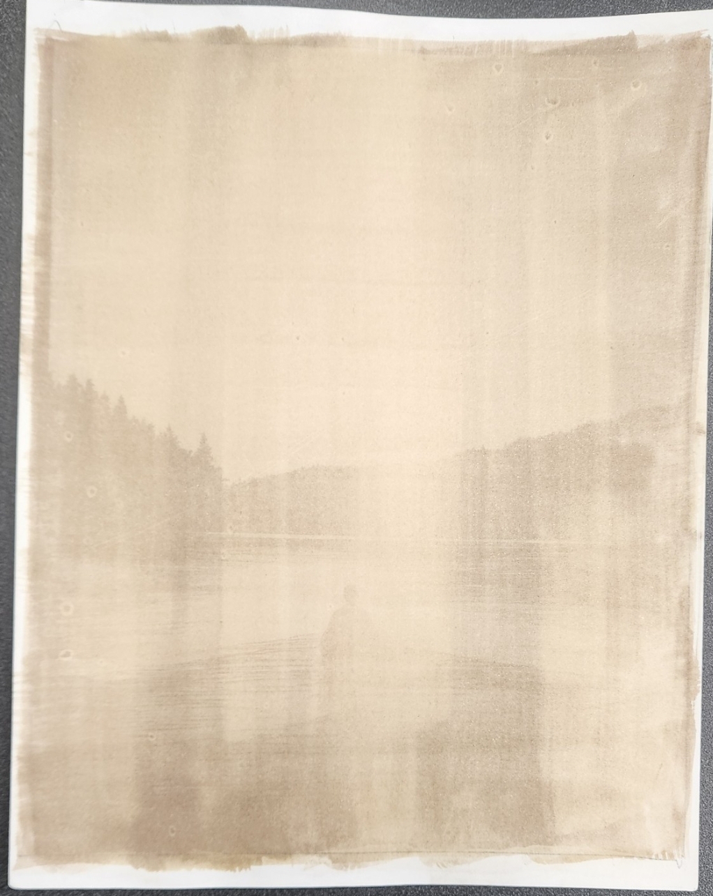

Still wet, with longer exposure time and a very high-contrast image of my own (not a photo, a drawing):

It seems to when I coat the page (darker than a van dyke), but much of it washes off.
The very slight image that appears after exposure might be the FAC? It's a very faint yellow, invisible in low light.
The image forms immediately upon brushing on the copper sulfate. There also appears a very dark (almost black) liquid that washes off when I put it in water.

Example of bleaching, which lessens as the brush becomes contaminated:
Original (underexposed, with some bleaching):
After applying potassium ferricyanide:

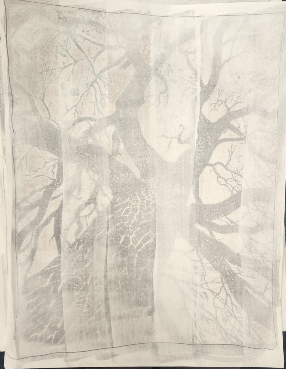

I'm still not sure how I managed to get a brown image initially (maybe improperly mixed citric acid? I'm not the most careful), but I can consistently get a very pretty silver image by washing in 3% copper sulfate.
The pink staining was because the sensitized sheet wasn't totally dry prior to exposing. I'm also impatient. The silver image is probably actually silver, it bleaches with potassium ferricyanide. I'm assuming it's a double displacement, and the copper precipitates silver out of the thio-silver complex. Basically a salt print, but cheaper than toning a cuprotype in silver nitrate.

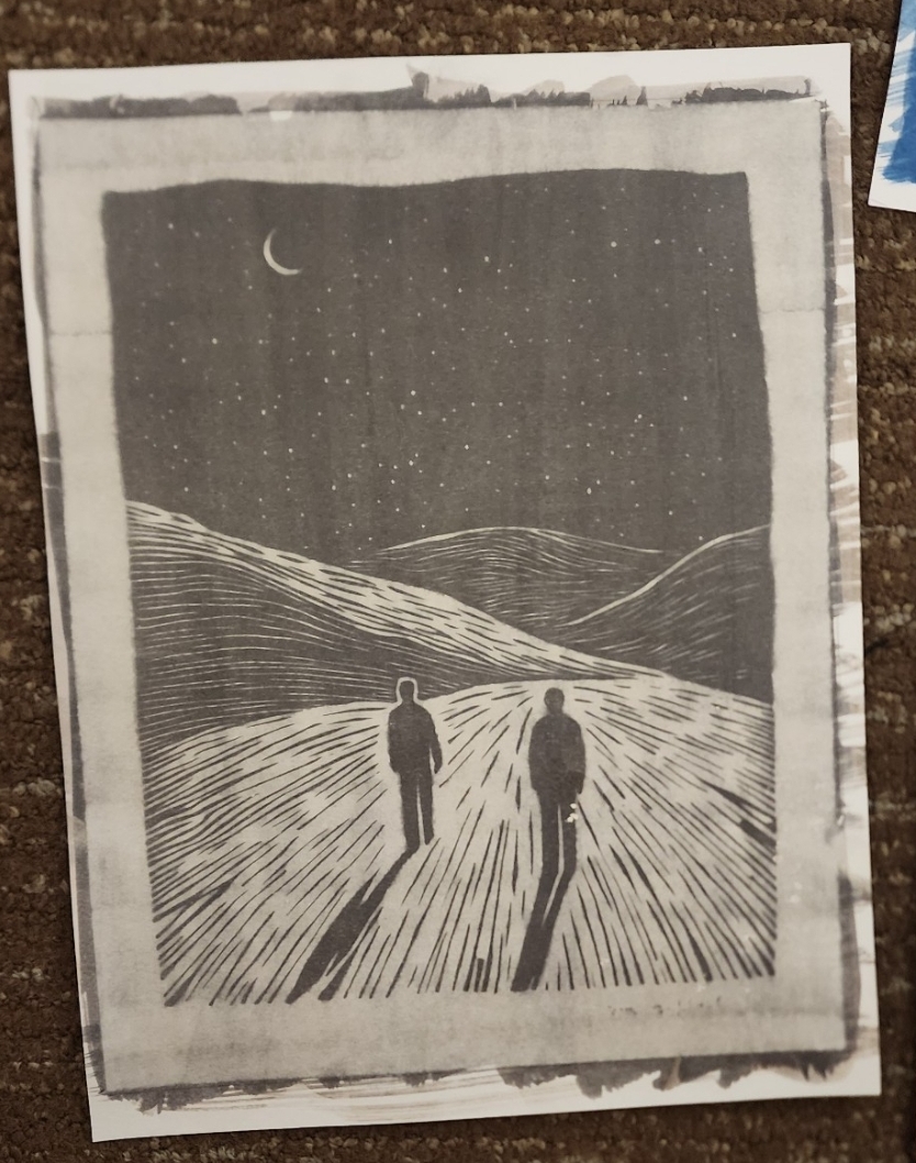

I get the same tones using this formula (10g water, 4g ferric ammonium citrate, 1g citric acid, 0.4g thio, and 5g 5% silver nitrate solution; post exposure bath in 3% copper ii sulfate) that he did with a silver-toned cuprotype, without having to develop back.
The copper bath I use here is pretty finicky, it took me a while to figure out what exactly was happening. Too dilute (around 1-2% or less) and it washes away; too concentrated (above 10%), and the image bleaches. Brushing on the developer doesn't work, unfortunately—too much smudging/bleaching—but my next step is to remove the citric acid in the sensitizer and see if this speeds up development time, maybe making brushing less impractical. I feel like I could get greater dmax if it "worked" faster, right now the reaction seems to take a second or so to really "set."

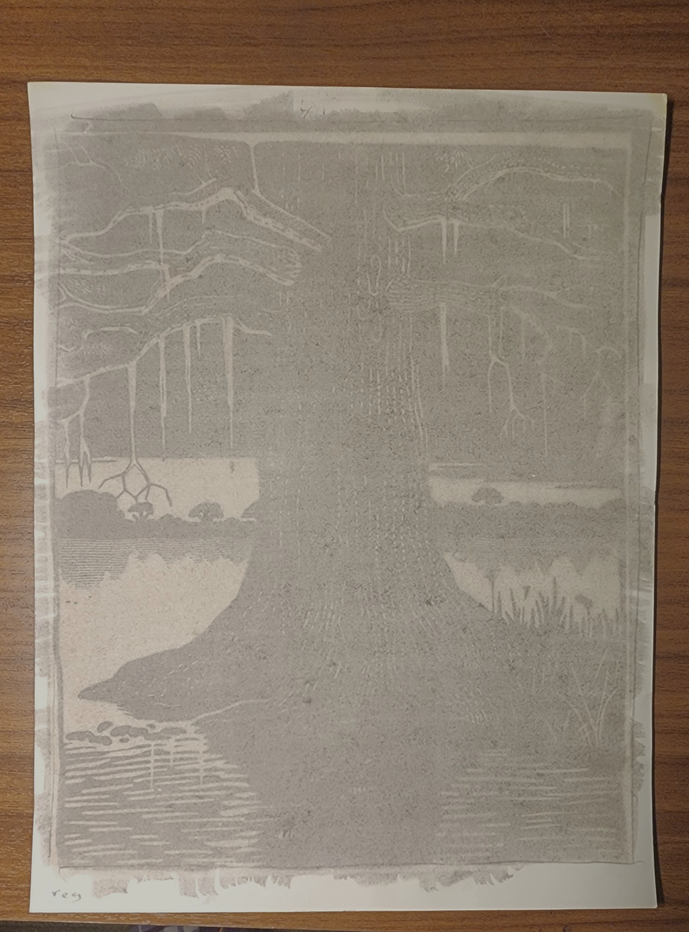

Eliminating citric acid definitely reduces the amount of smudging. I believe citric acid slows down the reaction, and the faster the reaction the less smudging (but could be totally off-base!). In the attached image, I was able to brush on 10% copper sulfate with no issue. I think the paper has to be a tiny bit grippy (I get smudges still with watercolor paper, running a few more tests today to confirm), but maybe try eliminating or reducing the citric acid in Jim Patterson's process?
