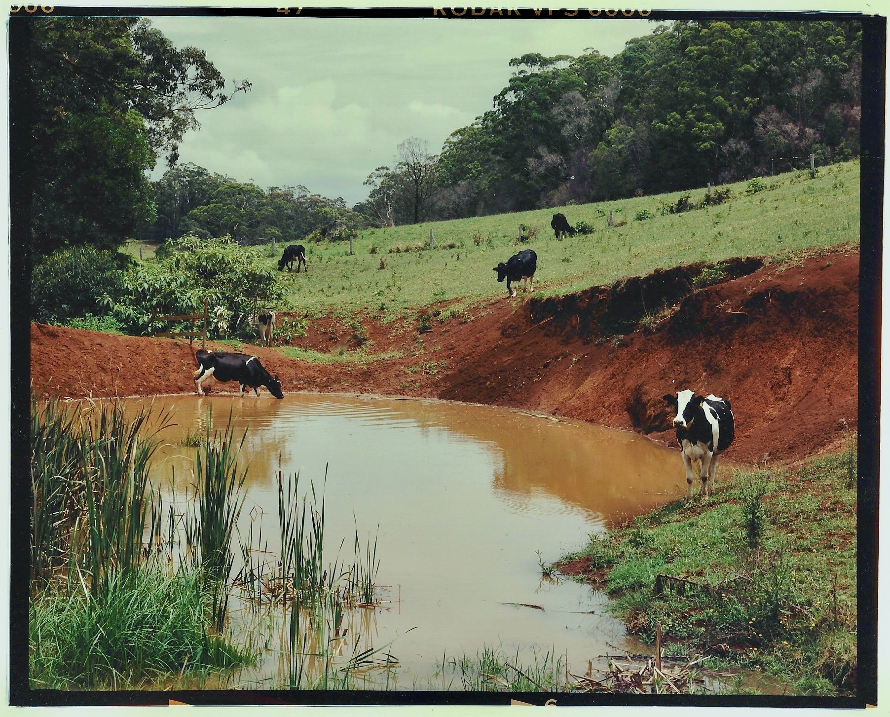

I used a 6x7 rollback on my 4x5 when traveling (Cows on the in-laws farm, NSW, Oz...can't seem to get the color right):
1) Easier to use color film
2) Wider choice of film...both bought and carried
3) Get to use the view camera movements I am use to in composing an image
4) Roll back is lighter/compact than most MF cameras of similar quality (since I will have the 4x5 anyway)
5) Still can photograph when I run out of loaded 4x5 holders of unexposed film.
I only had a 150mm lens, so that was a limitation, but easy for me to live with. But the sheet film was my main 'focus', so I was willing to compromise on the roll film.
I rarely take the little 4x5 out that much -- had some fun this summer backpacking with the 4x5, but usually it is the 5x7 or larger.
