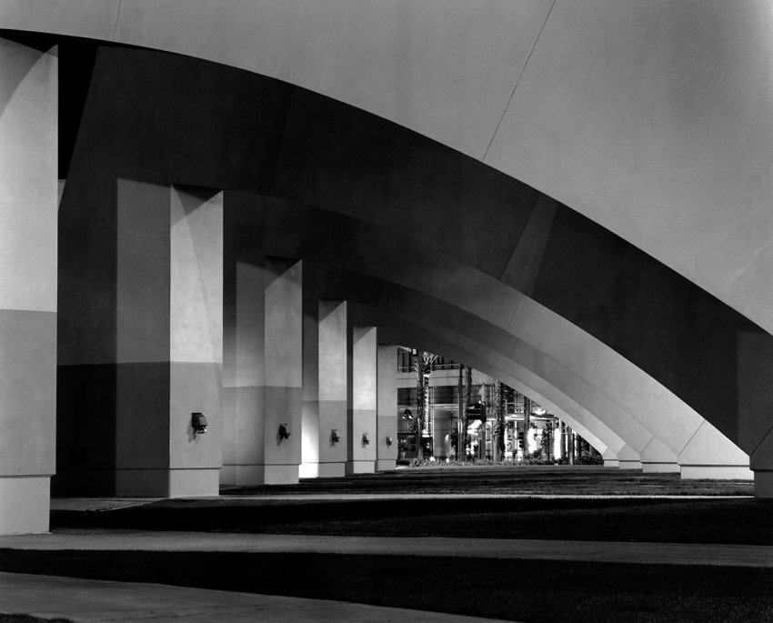

It's very easy to underexpose nighttime images, especially when there are bright artificial light sources in the scene. Your first two are definitely underexposed, with muddy blacks the result. The third is much better, but the available lighting is different than you have in the first two.
Keep in mind that your deep shadow areas are likely to be very dark, compared to the highlights and illuminated areas. High contrast is just a given with night photography. Film reacts quite differently to what you see with your eyes in these situations. You'll have to determine what elements in the scene are most important, then get a reading off those areas. Let the extreme shadows and highlights fall where they may, but highlights are often easier to recover with print film.
If you're just guessing at the exposure and using the same setting for all scenes, you're going to get a high percentage of failures. It helps a lot to have an accurate/sensitive in-camera meter, or even better a hand-held or spot meter.
Having a camera with full manual controls is almost a must. Being able to use longer shutter speeds (and bulb) on a tripod will allow you to stop down the lens and get adequate depth of field.
For this shot, I metered off the face of the upper arch and based the exposure off that. I suspected some of the shadows would go black, but it was reasonably easy to print in the darkroom.
